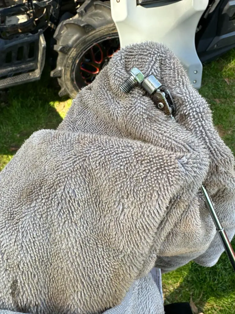

Got it turns out just needed to sleep on it.
Glad this worked. I dropped a roll of vinyl tape in the air intake and beat myself up for not covering the intake whilst working above it. The fine folks on this site helped me fix it without a big tear down. (It involved a leaf blower, string and a rag.)
