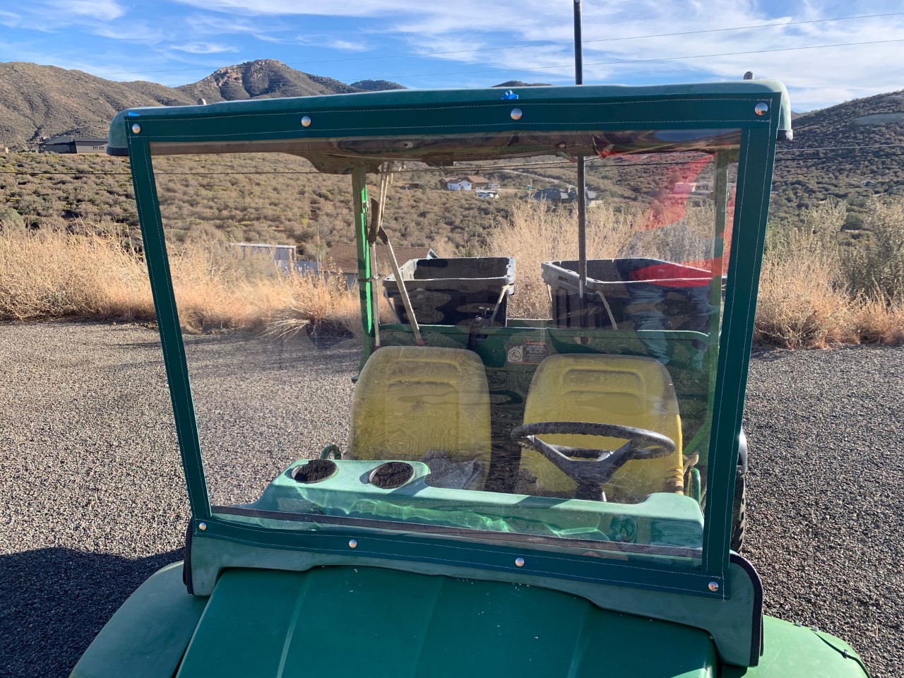

Take the P5 to a local auto upholstery shop and have them make you one from clear vinyl like isinglass but MUCH cheaper . I had one made for my John Deere Gator and it work fantastic . Snap on / snap off . Stores easy . Cost 75.00 complete .
I called the nearest shop to me and asked if he could do it and he said no problem . I just gave him the measurements . He made it / called me when it was ready . I picked it up / put the snaps on the gator (included in the price) and that was it . I snap it on for cool/cold winter months . Un snap it and store it for the rest of the year .

Interesting Concept
Does the Vinyl snap at the Top as well as the sides ?
I would sure like to see it if you would post a pic of it

It could snap anywhere you want it to . The Gator has no sides just top and bottom . No need for more than top and bottom .
Or you could slide it under roof and just have snaps on the side of the Pioneer .

Thanks for the pic
Looks great
Do you remember what Gauge or thickness they used to make it ?

I don't . I called the shop and told him what I was thinking . I thought I wanted isinglass like on my boat and he told me about the vinyl and said it was MUCH cheaper , he had some in stock and should do just fine and it does . Post a picture when you get it done if you do . If you have a problem and really need to know how many mil I could call the shop but it's been a few years ago .

Ok . He doesn't remember but he bought it at Walmart , he said it was the thickest they had and he thought it may have been 40mil . I don't think thickness will make a big difference . Thick or thin it will stop the same amount of cold .
