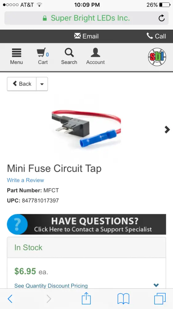

Could you not just use one of these fuse taps and insert it in your acc fuse location in the fuse panel to get switched power? For use on like your lighted switches. That way you don't have to splice any wires?

Maybe! If there is room under the fuse box lid for it I dont see why it would not work.
39,130
I've used them before and had the same thought. Is this ok? Looks like a fancy redneck fuse tap. They've never given me any trouble though.
32,051
I'd be careful using this, you're adding a load to a circuit that may not have been designed to carry it. (Too small of a feed wire) Hate to see a nice pretty Honda go up in flames like this
3e8968eacdfc78ff3bcb644ef62f967e
39,130
Good note @ohanacreek. If using this method to power a an accessory thru a relay, I would say it's ok. But if you ad an additional 5+ amps, not good.

Thx for heads up on that @ohanacreek. I just read where it's only rated for 10 amps max not sure how many amps those small led's in those rocker switches pull but probably not worth the risk.
