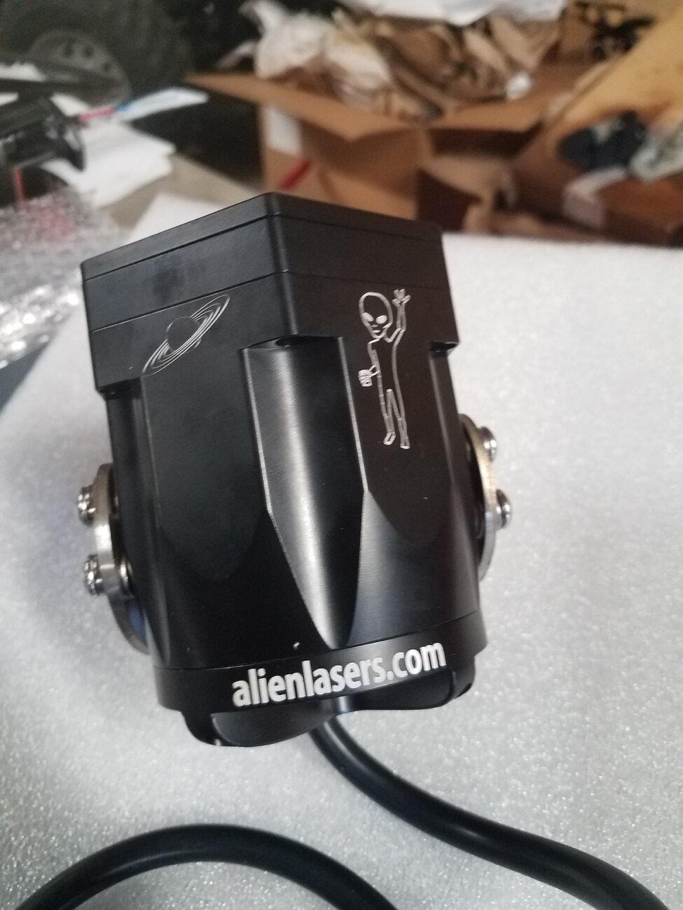

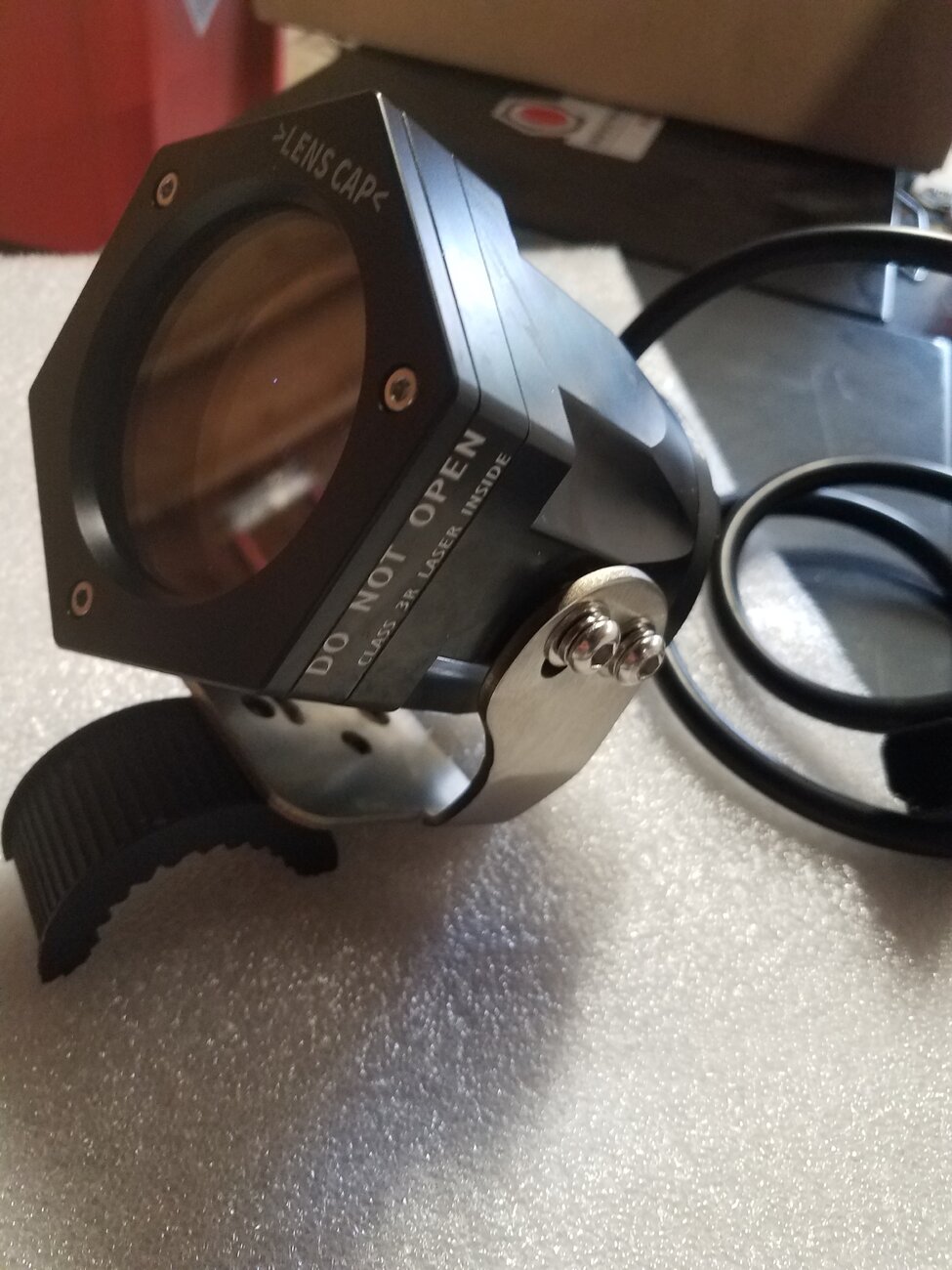

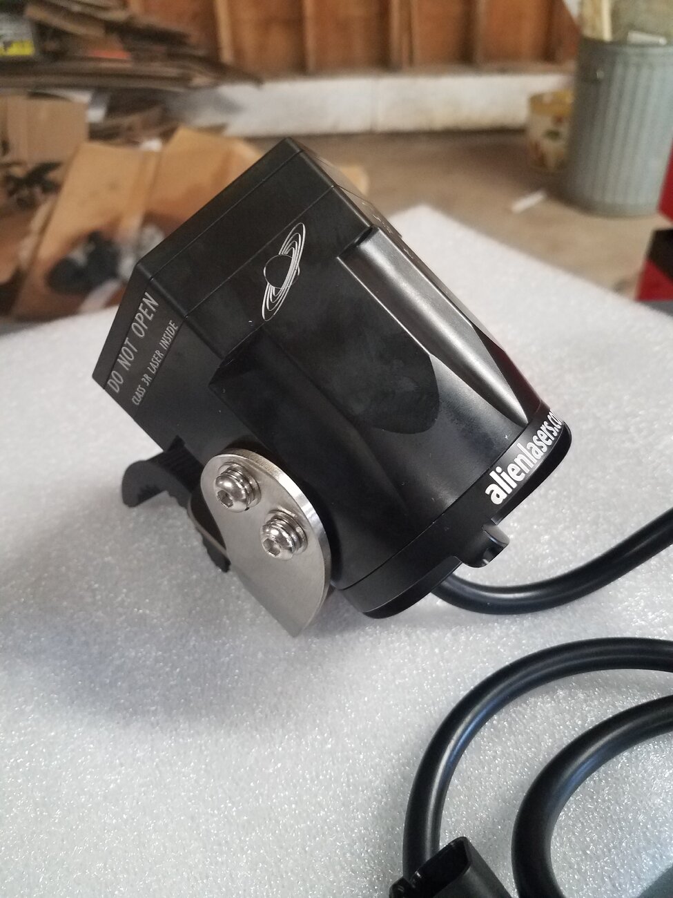

I was afraid of that... I bought some Alien Lasers which have a 30 amp inline fuse.
(my electrical knowledge is high enough that I just get into trouble so please correct any inaccuracies)
1. If I wire them to the fuse box there is a very high chance of blowing that 40 amp fuse when I run them and other accessories at the same time, so this is not a good idea.

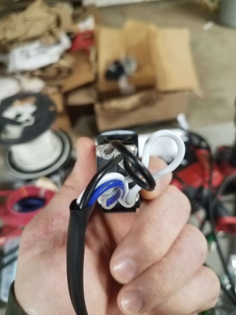

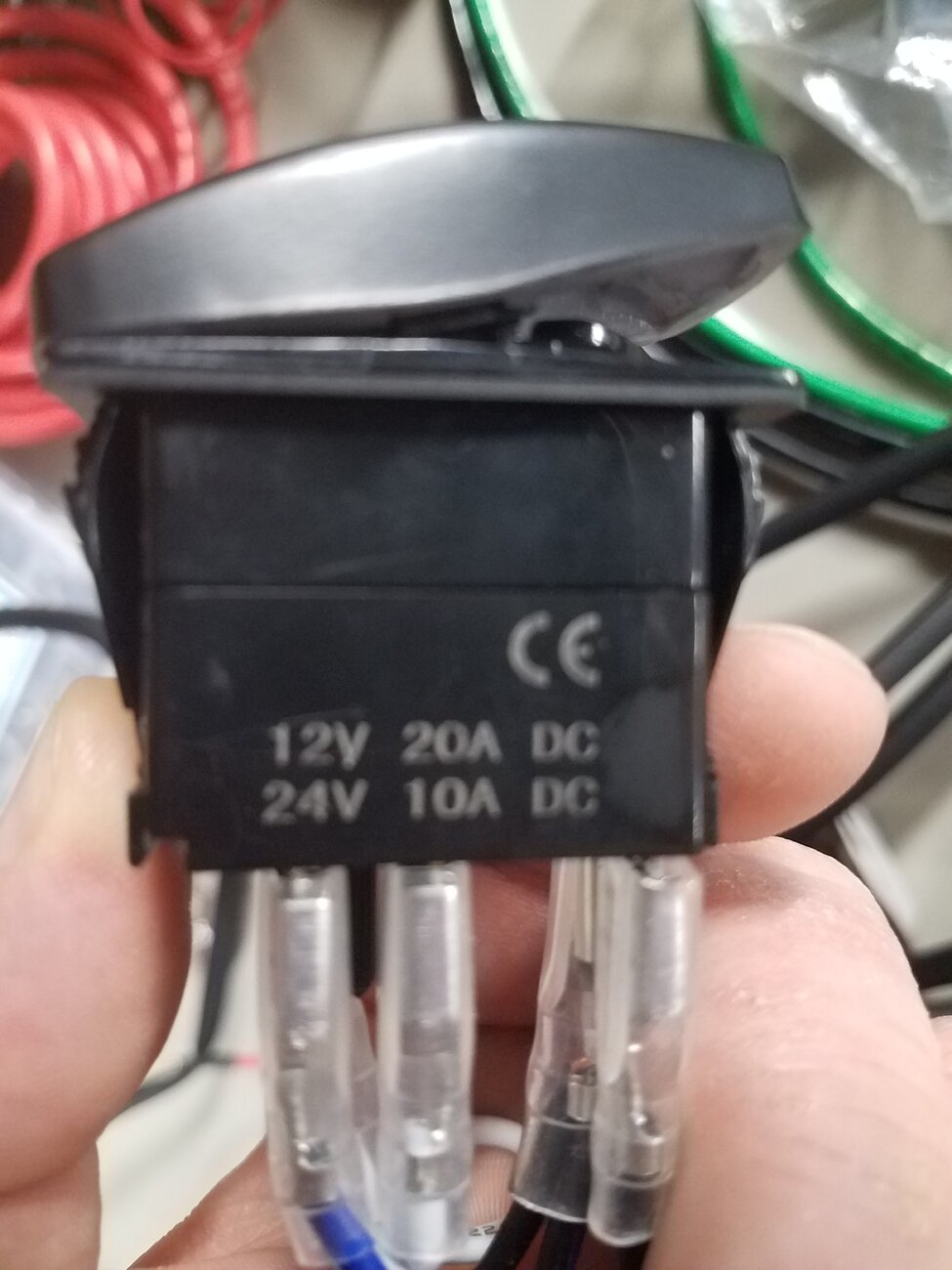

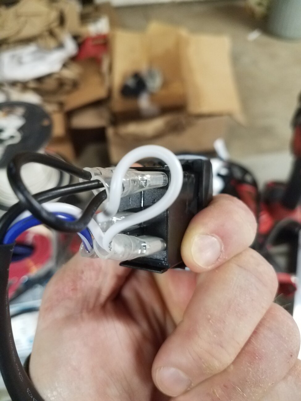

2. I want these to be key on power so they don't accidentally get left on, but that's not possible with the current setup.
3. I could wire them to the battery but I would have to get key on power for the rocker switch illumination or it would be illuminated all the time.
Is my thinking correct for 1, 2 and 3?
If so, does anyone have a few suggestions on best course of action?
