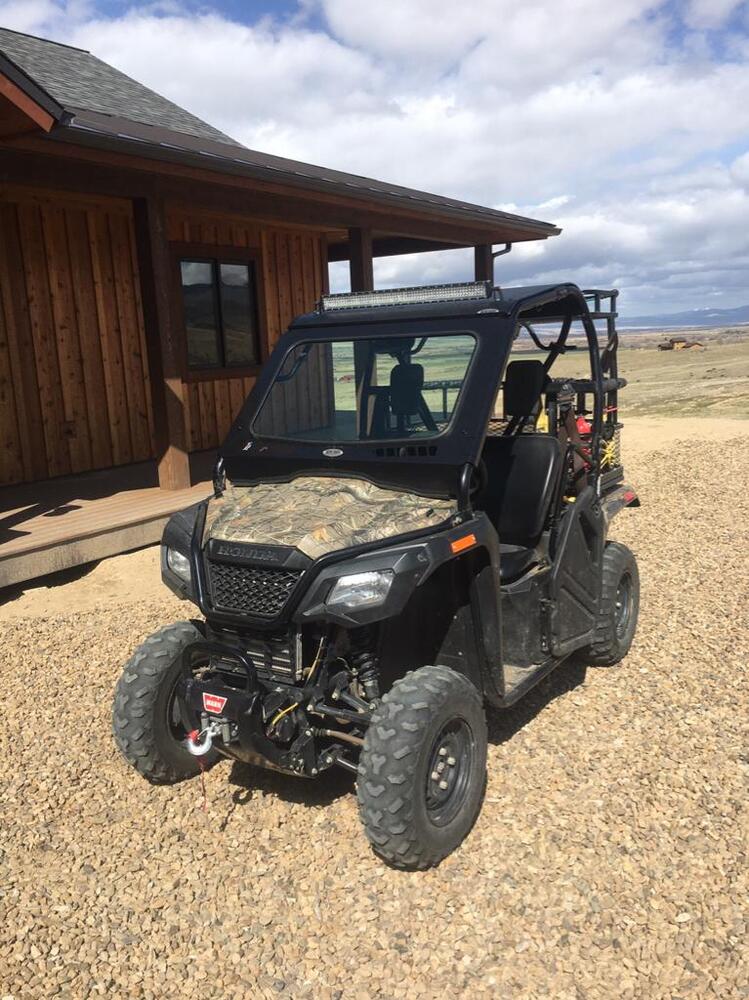

Got it on. Nice to take it for a ride and not have a face full of wind.
I’m holding off on the basket.
nice ride! how are you liking the EMP windshield / aluminum roof? I am looking at buying that same combo. I noticed they don't offer free shipping on the metal roof, but the plastic one they do. Any issues with visibility with the margins, and / or being too hot in the summer? Did you end up ordering any doors yet?

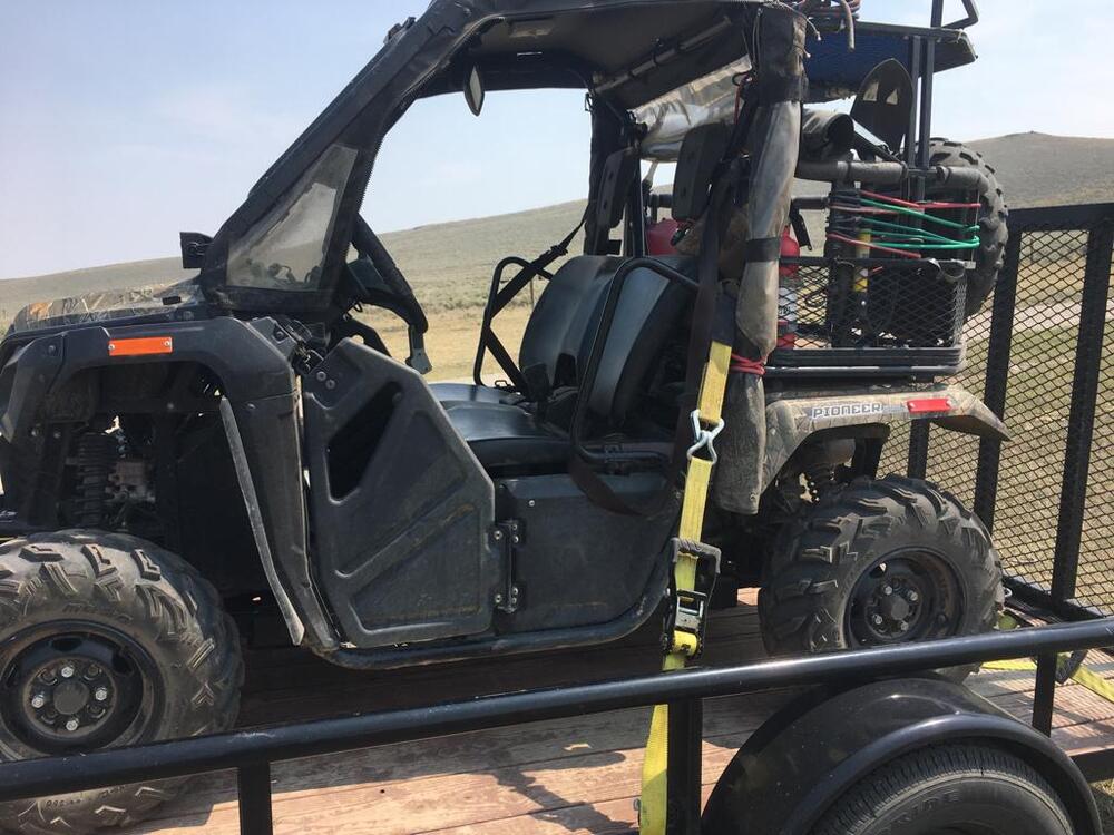

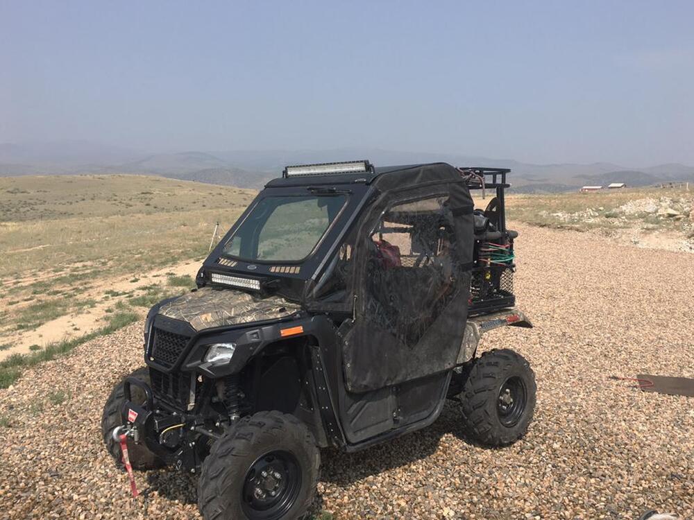

I’m very happy with the combination.
I bought soft doors that I’m rolling back and holding with the velcro straps and an added bungee cord. I wanted to zip them closed for cold weather.

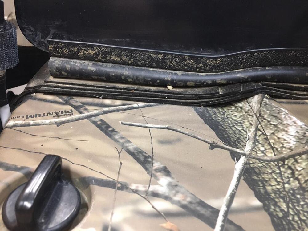

The EMP windshield did not seal really well against the hood. I have a roll of 6” rubber that I believe is used to seal shower pans, I cut 1” wide strips of it and built-up the material to close the gap.

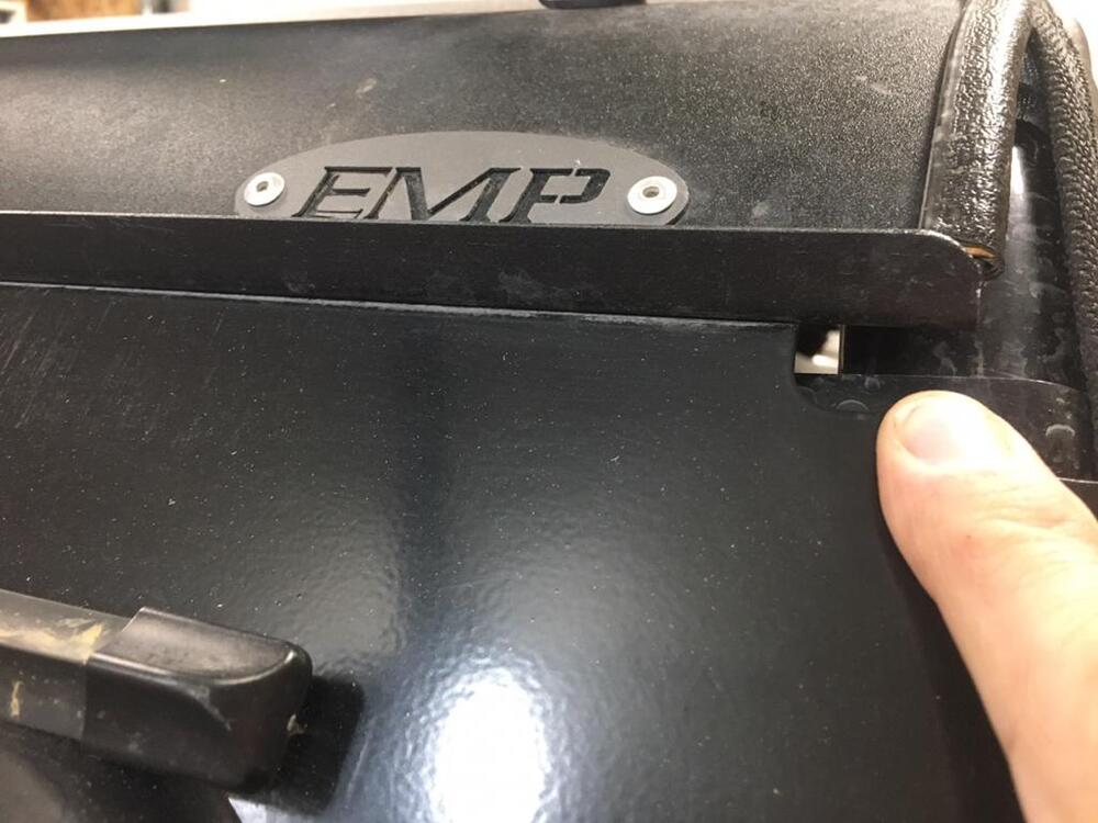

There’s 2 gaps in the upper corners where the windshield pivots I need to close, rain came in there big time a few weeks ago. I have some water pipe foam insulation that should work.

A friend has a P5 with a clear plastic windshield, we rode in it today. The EMP takes away the “panoramic view” he has, but I’m used to driving mine with the EMP. You do loose some outside view going around a curve, and I’ve not noticed a big difference in visibility directly in front going on rocky trails.
For the first time I felt the engine heat on the seat belt mount on the front seat. Being Montana, it was tolerable and I kept thinking how good that will feel in the cold months.
I got a soft rear window which I’ve only had rolled up top so far. It’s wedged between the roll cage and the Dusty Dawgs rear rack.
