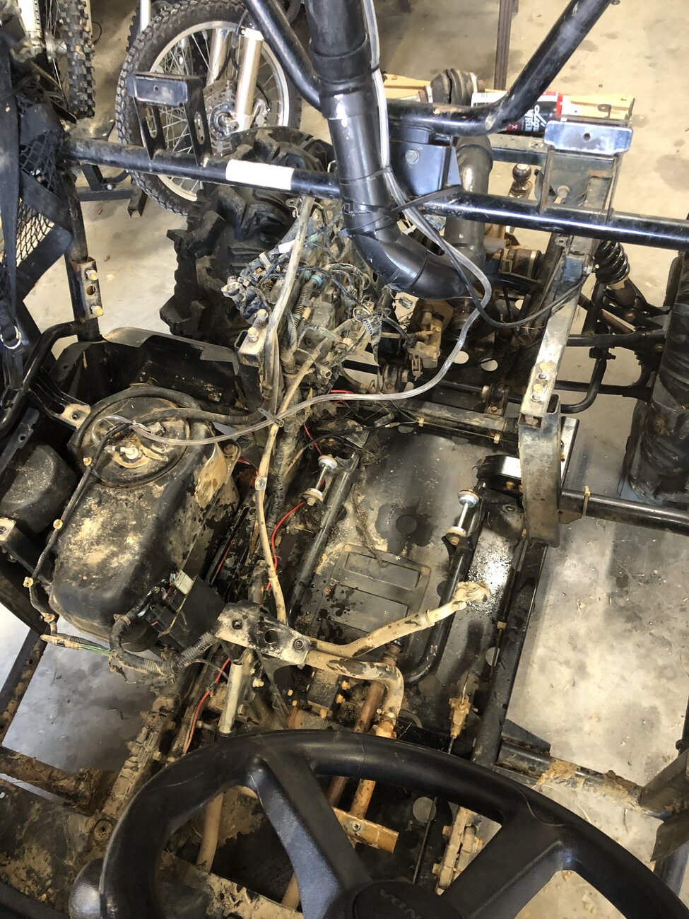

I removed all the body work to give it a deep clean before pulling the engine then pulled it out the top, between the ROPS with a chain fall.
20201229 185207
20201229 183253

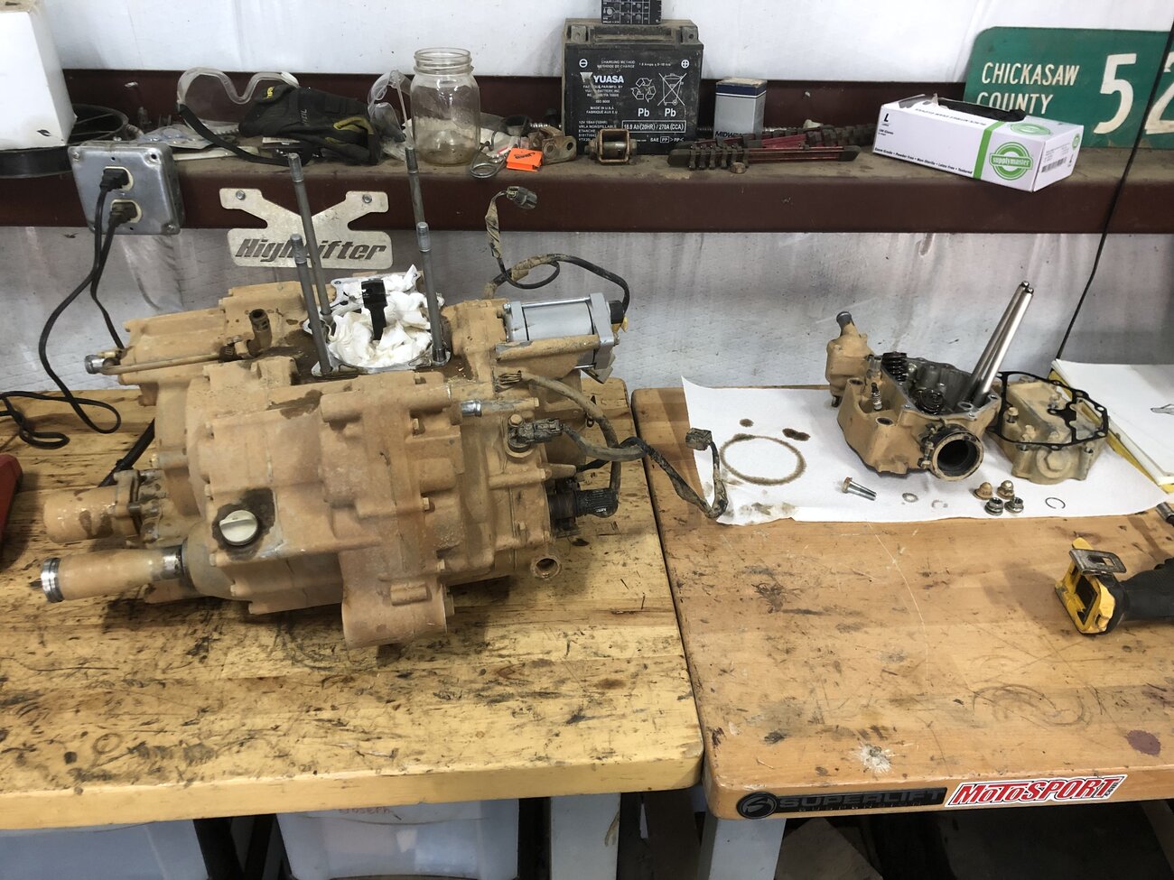

I tore mine down, split the cases, pulled everything out then milled the case "bore" to fit the 520 cylinder.
As @JenElio mentioned, a free download of the service manual is available on the site for contributing/lifetime members, I highly recommend it.
20201228 170302
20201229 163431

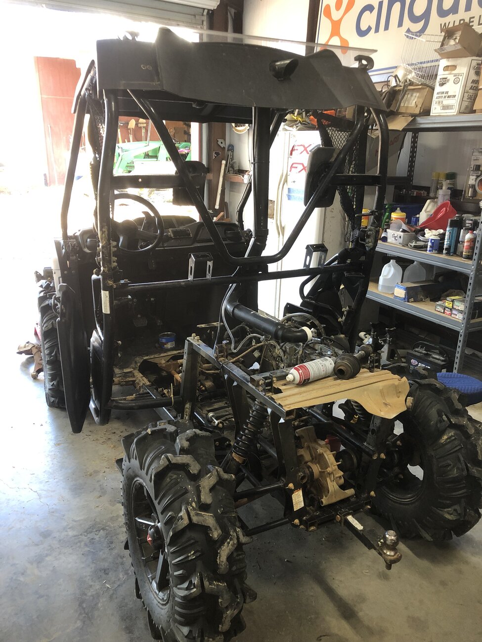

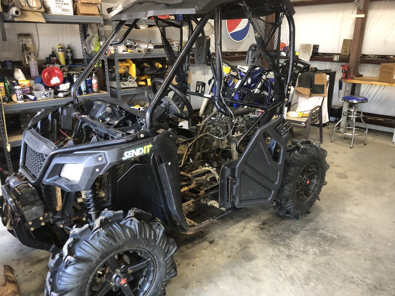

got the motor out just had to take the floor board out and remove the frame under the seat and was plenty of room to yank it out. About to drop off the cylinder to the machine shop and then starts the project of splitting the cases and cleaning out the motor. You can probably guess what caused this project to get started 🍻
A470AB81 0791 4ADC 838E C54DBF3906F6 546FCE3C C7FD 425D 8CB2 8B763EF82602 88CDD7FF 99A7 4C44 9E13 3DEB03F00698 FDE41C4E D05F 4A94 9348 286A3BDE6374
