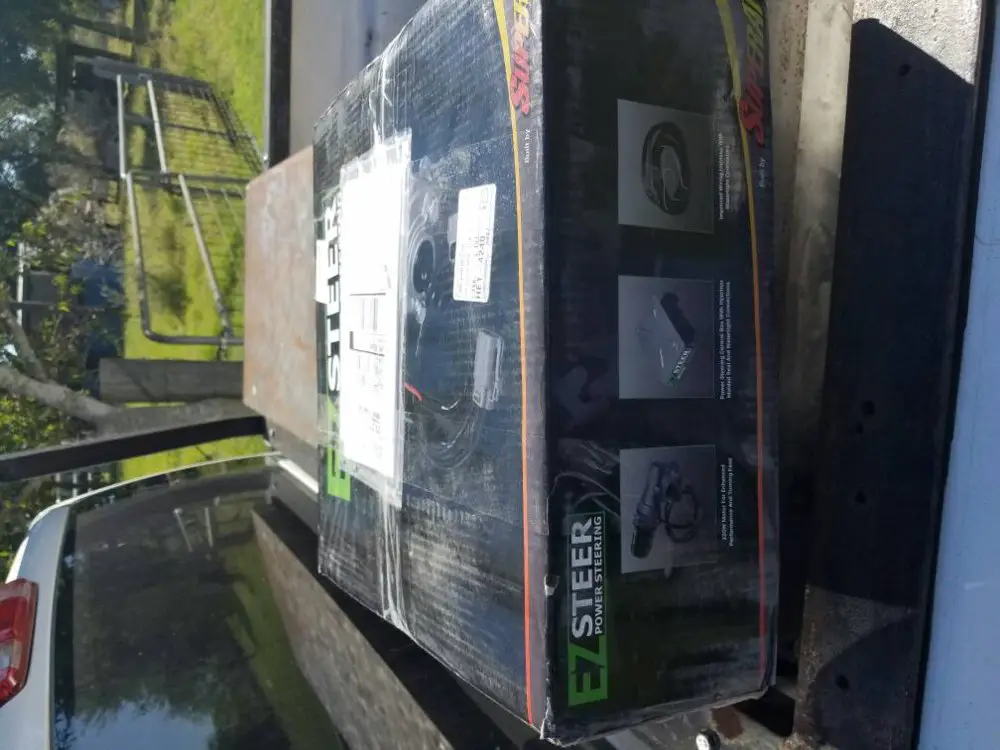

Look what the Brown truck brought today!!!
20161005 145913

Very cool! I'm guessing you've already read up on the installation? Any questions?
I know it's not the man way, but in my line of work I read instructions a couple of times before I start.
2 hours from start to finish. Only removed the plastic baffle between the radiator and back of dash.

A great mod. Almost effortless in 4 lock.
