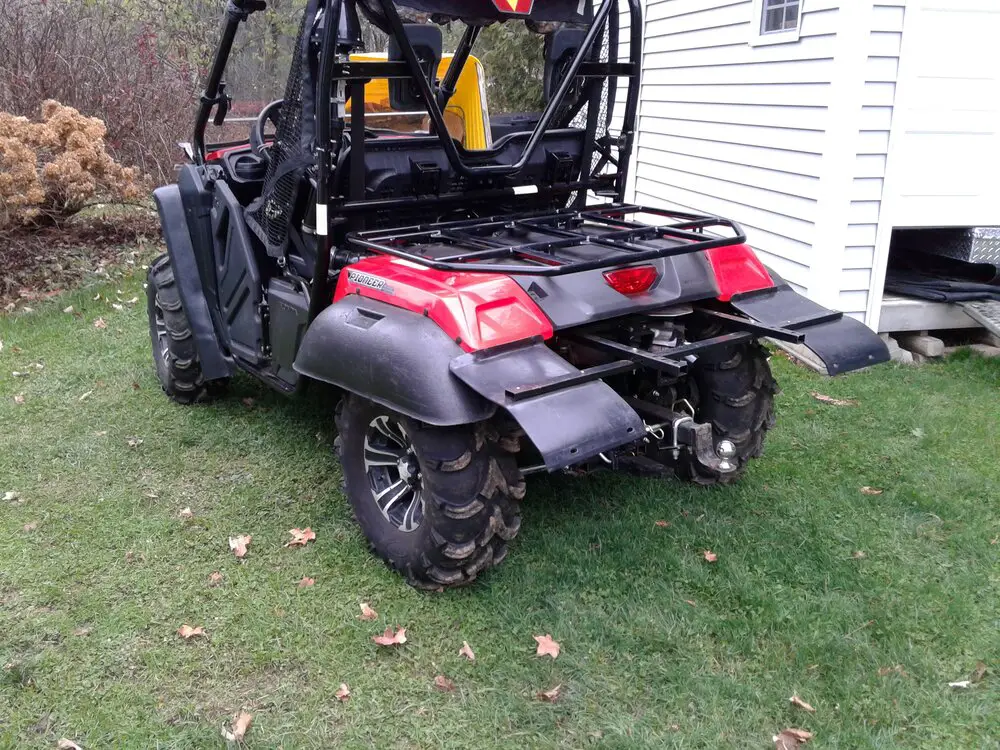

20201114 111440

I am currently waiting on a set of Mudbusters for the front only as they seem to be the coverage/fit I want with my wheels and tires, although a bit pricey. I also just received a set of Pacer Flexy Flares to try and make work for the rear. I bought the heavy duty no-lip model based on the rear plastics of the p5. I'm hoping to trim a bit (maybe 1/2) off of the flat portion once I figure out which hardware makes the most sense. I'm going back and forth between bolts/self tappers/honda plastic rivets. They make quite a few different models but I thought the no-lip was the only one that made sense without modifying the fender plastic first for an underneath attachment. I will let you know how they come out once I decide on hardware.

I installed the Pacer's on mine yrs ago and remember those rear fenders were a b****! They work and form easily to subtle radius', not so much on a tight bend.

Trigger, did you end up getting them on and leaving them for a while? What fastener did you find to work best?
Do you run anything for a rear fender now?

They're still on my machine. I used the lip type, just lifted the flare portion up drilled and used small nuts and bolts to fasten to the fender. Again, getting them to form to the angles of the rear fender was a pita. At the very back you're trying to make two angles with something that is set up for being radius. Ultimately it can be done but came with some cussing.

Do you have a pic you could load up?
