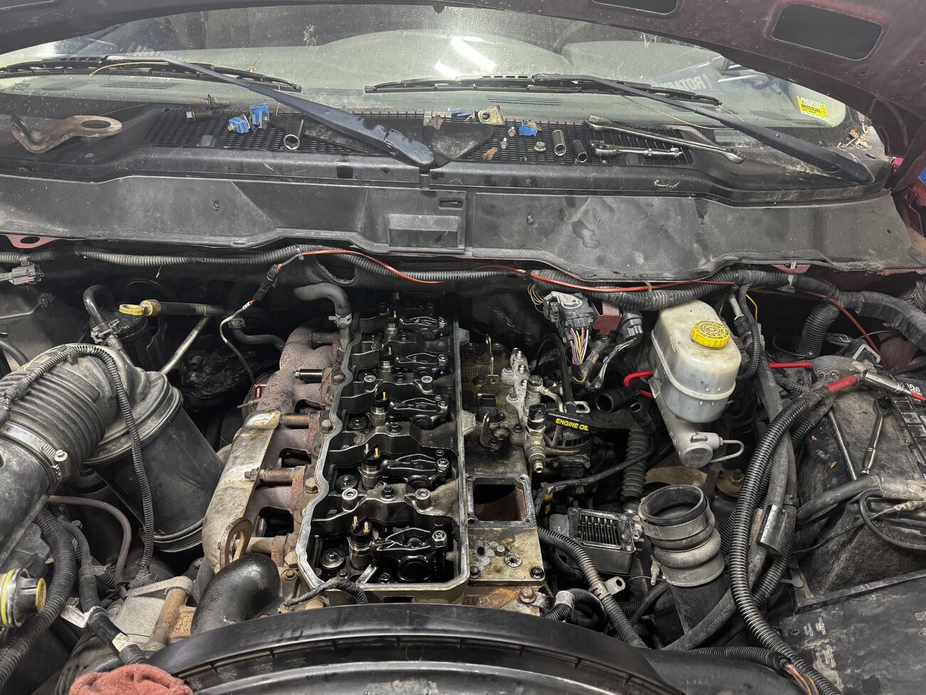

Just replaced the injectors on the red ram. I had an issue with one of the injectors earlier in the year. When I pulled it out to inspect it the injector had nothing on it for a label or marking. I was under the impression that the previous owner had replaced the injectors before selling it. I got in touch with injectors direct and they claimed the injectors were most likely knockoff/cheap because the OE injectors would have been marked as well as any reputable aftermarket injectors should have been marked. The single injector got me by for a while and the end of summer I had a second one go. I decided I would wait til black Friday and get a full set from injectors direct. I was able to snag a full kit for 1250 from injectors direct. Tubes, harness, lines, a very nice kit. I finally got around to doing it yesterday. Everything is functioning great now.

Just replaced the injectors on the red ram. I had an issue with one of the injectors earlier in the year. When I pulled it out to inspect it the injector had nothing on it for a label or marking. I was under the impression that the previous owner had replaced the injectors before selling it. I got in touch with injectors direct and they claimed the injectors were most likely knockoff/cheap because even the OE injectors would have been marked. The single injector got me by for a while and the end of summer I had a second one go. I decided I would wait til black Friday and get a full set from injectors direct. I was able to snag a full kit for 1250 from injectors direct. Tubes, harness, lines, a very nice kit. I finally got around to doing it yesterday. Everything is functioning great now.
What year is the truck? What's your odometer read? Do you change fuel filters as prescribed. Cummins (Bosch) injectors normally run 400k - 500k miles.
I put 325k miles on a 2006 HPCR 5.9L with OEM injectors and it was running strong when sold. My old 2008 6.7L now owned by friends has 290k miles on original injectors.
The red one was at 212k I believe. I purchased truck at 200k so I am not sure how well the previous owner took care of it. I don't remember the DTC off the top of my head but both injectors were circuit issues and when measured with an OHMeter they were open internally. I can assume they were just cheap online injectors based on the conversation I had with injectors direct.
A HPCR 5.9L?
There are vendors selling injectors, rebuilt injectors, and other exaggerated claims all over the US but I believe a shop must have expensive Bosch equipment to actually rebuild and balance a set of six injectors.
I know they are expensive but the engine can provide reliable service for another 200 - 300 k miles. My sincere advice is buy a six pack of rebuilt and matched injectors from a Cummins truck shop, Ram dealer that specializes in trucks, or an authorized Boch drebuilder.

A HPCR 5.9L?
My black ram has 60HP Industrial Injectors the red ram I just did has OE sized injectors direct. The injectors direct is a certified Bosch facility. Black ram is 03 the red ram is 06.
