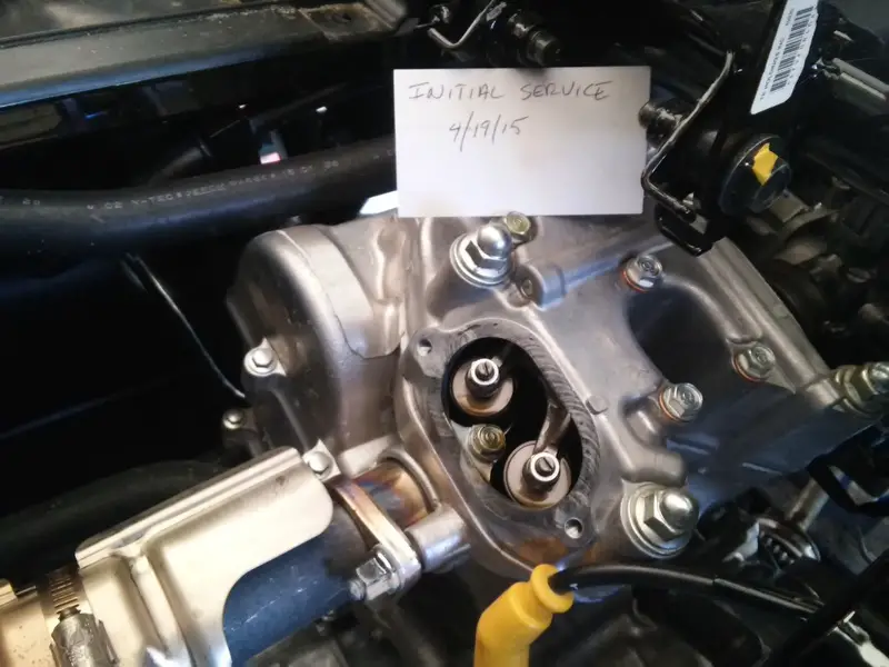

I take a picture for proof I was there, store them on a thumb drive
20150419 113545 zpsebzkwopk
