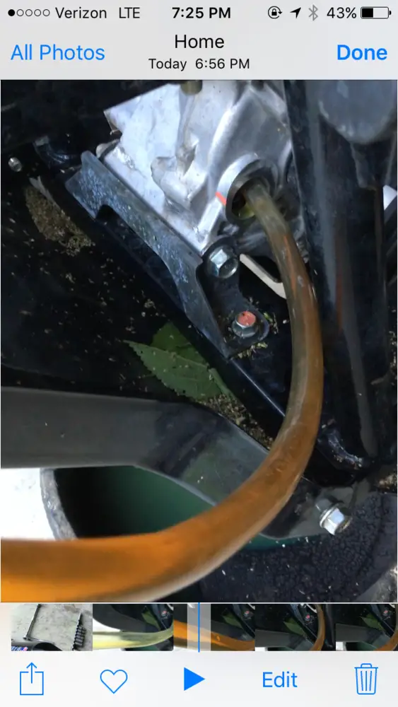

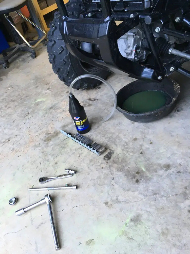

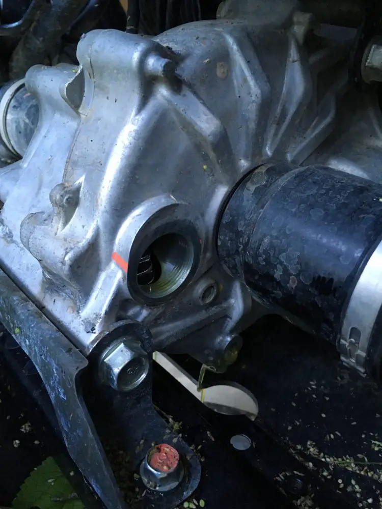

Thank you so much. Here are some pics of my progress.
Image Image Image

Not a bit.
But +1 to the process of elimination.
Did you notice any kind of shavings or filings in the oil you took out, hope you get this issue resolved, its nice to know you are under warranty
Oil looked clean. I made an effort to look... (seeing a previous post from a member about finding the shavings, so it was on my mind to check)
It's definitely nothing major, whatever it is... a buzzing vibration. More of a nuisance more than anything.
