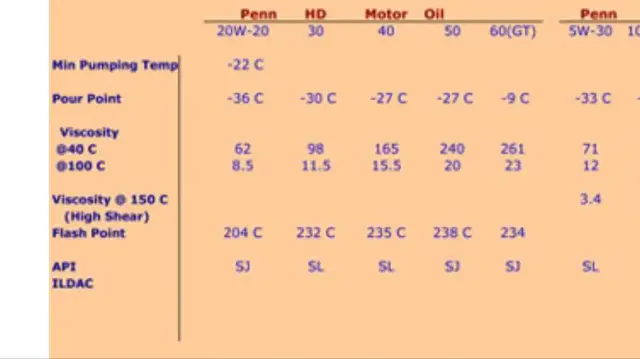

Below is a pic of some specs for straight oils. It looks like the 30 weight oil drops viscosity a lot from 40° to 100°. My guess is it would continue to fall as the heat increases.

You'd think they would label it 30 S 5 then. Who wants an oil that thins out so much when it gets hot.
Seriously, why would they even recommend it for a combustion engine?
My apologies monte...you were right!
Thanks for the info joey, interesting to say the least.

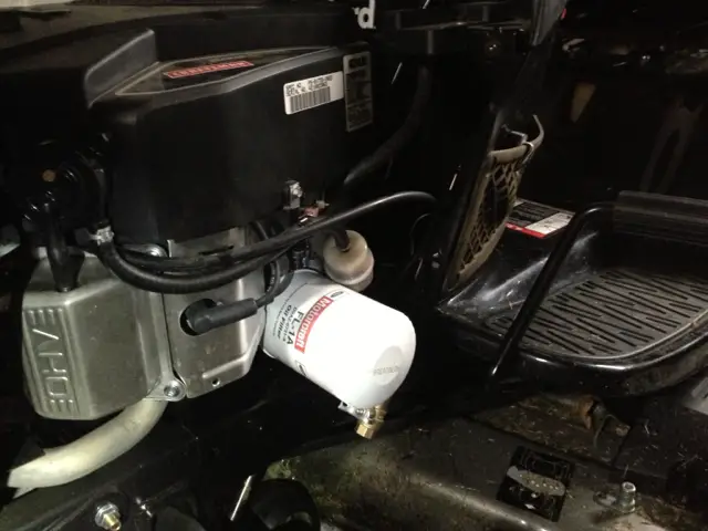

Engines are designed to run at an OIL temp of approx 100°c or 212°f. Therefore oils are made to meet the viscosity speced by the engine designer. If you let your engine run hot, the oil will get thinner. If the engine's cooling system is in good condition, there is nothing to worry about.
For example, my lawn mower is an air cooled engine so the oil temp will continue to rise as the engine has no way of cooling itself other than a fan and heat sinks. Have you ever noticed how air cooled lawnmowers list a limit on the yard size they can cut? See the pics below, the designers know that this mower can only cut 1-2 acres before it gets too hot, so they list the "yard size". Commercial grade mowers are water cooked so they can cut all day long.

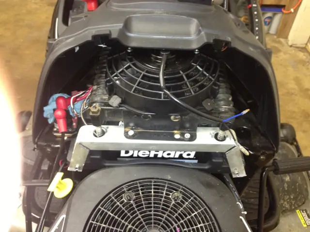

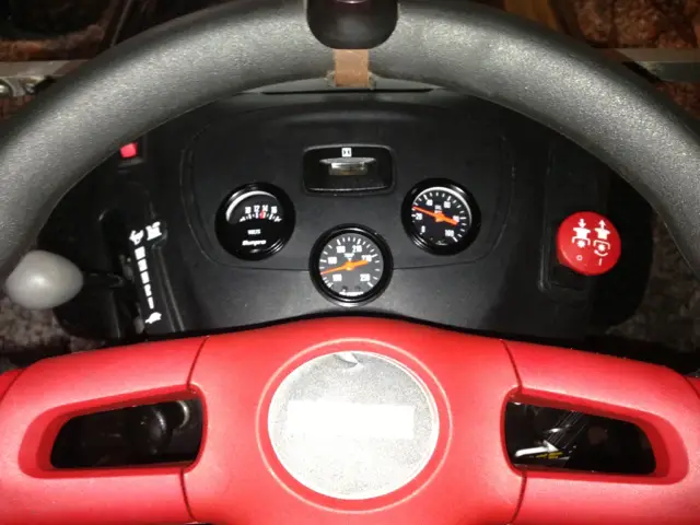

Above, I mentioned my mower being air cooled. I wanted to add a mulching kit and cut my larger yard without buying a much more expensive mower. So, I put a oil pressure gauge and a oil temp gauge so I could monitor those parameters. What I found out was that I had 40psi oil pressure at start up and 20 psi at 200°F. As the temp continued to rise, the oil pressure fell below 10psi which is not good at all. So, I installed an ATV oil cooler and fan which now allows me to keep the oil temp where it needs to be and I can cut all day long. Also, I added a huge FL1A ford truck filter because it's thread and gasket size is a perfect match. That almost doubled the oil capacity and more than doubled the filter size. Below are pics of that.
E9cbbdb8ea76590dc16316afc9a8ca6c
3a0fb427dbd46ba31a4e334c4a58a197
Fe6981ebbc502c76ffb3583251da3ba3
And all these parts were cheap. The fan was a eBay score and the gauges were cheap at O'Reilly auto parts.

Holy sh** Batman, I love that. Please figure out a way to put that big FL1A on my P5, please Joey!

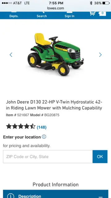

No I didn't know that and, ironically, that D130 you show IS my lawn tractor.
Only have to mow about an acre though.

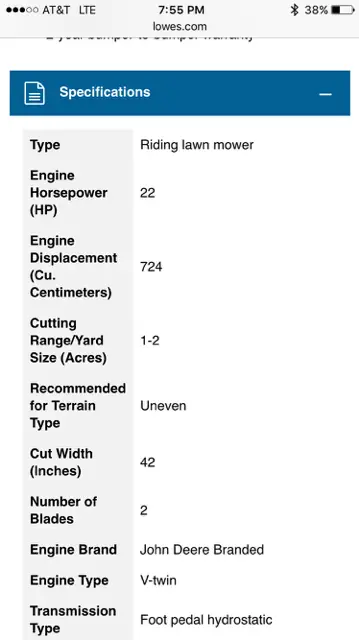

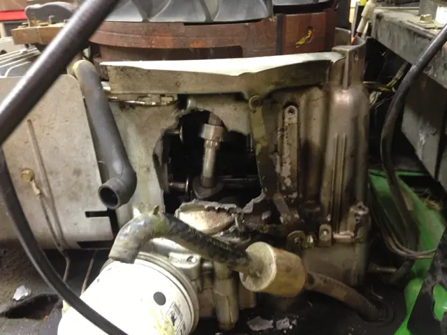

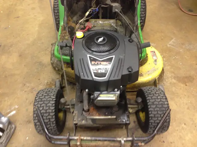

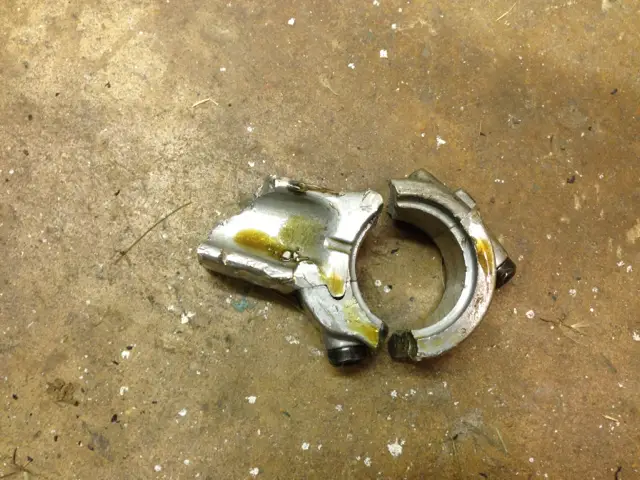

I had a John Deere from lowes. This is what happened when I tried to cut 3 acres with it.....
9b37d1000395e421e4847fd04784b6e8
8e438f0ef29c19d9a3cc1a1fc454e03c
In the above pics, the engine blew at 190 hours and was running Mobil 10-30 synthetic. I had to walk a pretty good ways across the yard to pic up all the pieces.
Now it has a new engine and it stays parked at my wife's office and still cuts about 2 acres but it has been good so far.

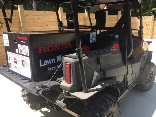

Now I cut about 1 acre with this: (sorry, only pic I have of the mower. Plus the pioneer keeps us legit).

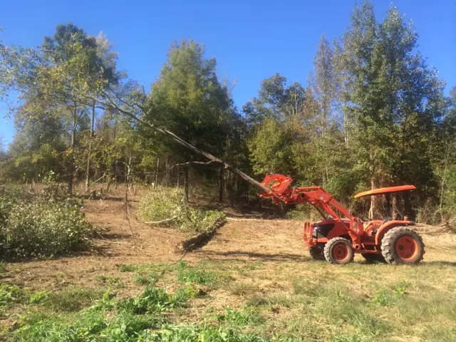

I cut a lot more with this: the rotary cutter isn't attached but you get the point. I can now wait a lot longer between cuttings and the Kubota don't care.

Wow, I never knew that. I've got a 42" Cub Cadet that I've had for a dozen years now and been cutting five acres with it. I have no idea what it's acreage rating is and whether I'm exceeding it or not. I just thought you could get on a mower and mow all day if you wanted. Didn't think I'd be learning that on this forum.
39,129
I am sure there's built in cushion there. But I had a mulching kit and was cutting probably twice its recommended capacity. I also think that the Briggs & Stratton engine in those are low quality. I now have a Kohler in the Craftsman.
Reactions: Sledge
Oh.......say no more. B&S was a damn good small engine way back in the day, but no longer. I went through 3 generators with BS motors at my remote solar powered cabin in 5 years. I finally bought a Honda and it's been in service for 14 years now. My Cub Cadets have Kholer too.

Nice tractor joey. Had my eye on a Kubota compact with a back hoe attachment, pricey though.
Only 190 hrs on that John Deere is kinda scary, I'm also running Mobil 1 10w30 in mine.
