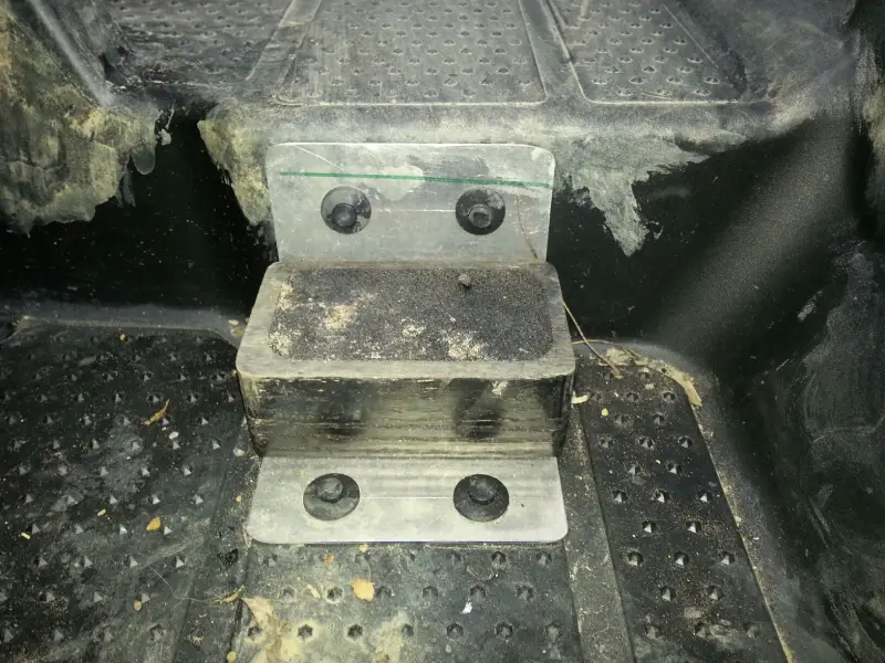

I did add a 2" tall block to go under my
heel. I am glad I did. I would occasionally
find myself driving with my heel on the
floor, but it did not take long for my ankle
to remind of the block. It is about 2" high,
2.5" wide & about 4" front to back. It is
large enough for the put the center of
my foot on it & have a little steady pressure
on the pedal, and control was with minimal
flexing of my foot. It is a must have in my
book. I will post a photo of it here when I
can.

I would be interested in a photo of your gas pedal foot block and how installed when ever you have time as I am a short bastard being a hair south of 5' 5".

I was also wanting pictures of your block. I'm 5'9" and was wondering how tall are you?

I am also interested in the block modification, as the muscles on top of my foot get wore out after a day of riding and trying to keep my foot "a float" on the peddle through rough terrain.

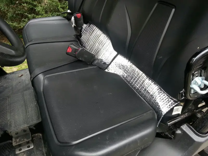

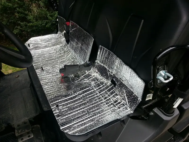

I finally got to take some pics of the
latest additions. Attached is a photo
of the heel block I added, as well as,
the heat shield I added under the seat,
yesterday.
I took the block out, and painted the
bracket black. I used some push rivets
because I couldn't get under the floor
in that area without removing a skid
plate to use screws & nuts. I used my
phone to a video as best I could, to
ensure I wasn't going to drill into a wire
harness or oil hose, etc.

Is that heat shield material your using the stick on kind or the kind you can bend into place and its just sitting on top of the other stuff?

Cash,
Its a rolled goods product I bought at
Lowe's a few years ago. It's basically
bubble wrap sandwiched with metalized
foil. No adhesive. I just cut holes & slots
for the seat latch & anchor points, and I'm
letting the seat hold it in place against
the seat support frame.
I report back how well it does. We have
another trip to Pioneer schedules again
in a few weeks.

The bubble wrap liner helped a lot for keeping the heat
out of the cab. It was in the 70's on Saturday, so it still
was pretty warm in there. WIth the split windshield, I
didn't want to open the rear window, as I knew we would
have a real dust problem. The dust wasn't too bad on the
trails, but the roads were pretty bad.
