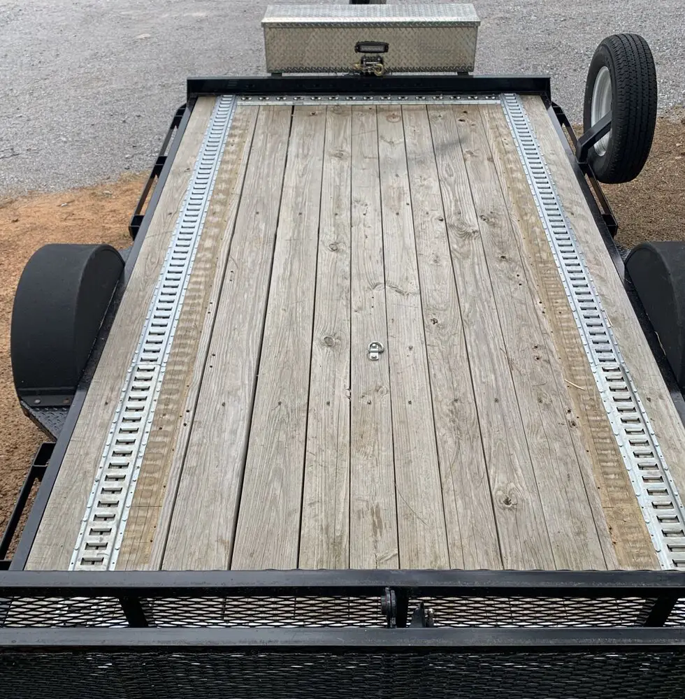

32,050
Measure to center of your tires and place it there.
if you change wheels or anything that affects track width be ready to move it.
You can see where mine was with spacers before I added the long travel. Stock width would be inside the stains by as much as it is outside the stains. Trailer is 7x12
Exactly what I’ll be doing very soon, I love the e track system
