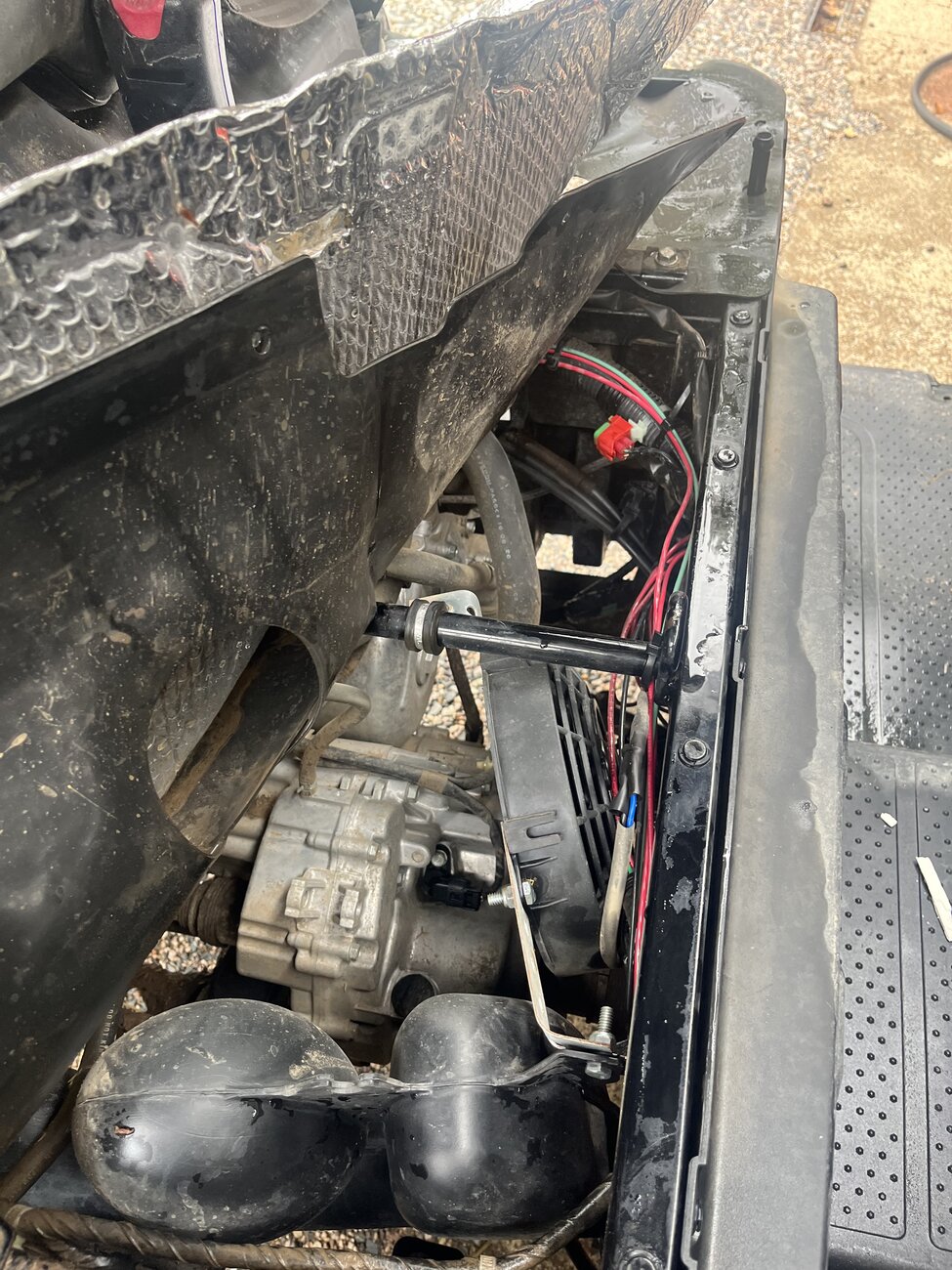

Thanks for the explanation. I already have a radiator fan mounted under the seat and one of the original "cabin comfort kits" sold by one of the contributors on this site. It definitely helped but I still have a little heat escaping up front. But since I use my P1000 mainly for an October Wyoming hunt, the small heat loss up front makes for a great hand/glove warmer. But the back is still a big issue. I have all the floorboards and trim off right now to clean up all the mud that's been accumulating between the skid plates and engine and thought it would be a good time to try and do something about the back. I do have some rides planned for next summer so your setup might still be beneficial to me for those rides when I don't need 'hand warmers". It looks like it would be easily removable for my fall trip into the mountains. I know what you mean by the push pins. I've got all the trim off right now and have a big gallon bag ziplock full of push pins. Now let's see how many I have left over when I finish putting all the trim and floorboards back on.

Nice build Scoop. Mine is not near as elaborate but works for what I use it for. Here is a link to my build although I never finished updating the post.
I went with the radiator fan instead of the bilge fan
C49A2F02 E03F 4A4C 87FB C02530A1918B
While it’s helped the front tremendously, still issues in the back. Right now I have the floorboards, skid plates, and trim removed. I can really explore where the air is moving. While the radiator fan is moving a lot of air, it seems to get diffused quite a bit before actually reaching the headers. So I’m rethinking the bilge pump vs radiator fan to get a more directed air flow. I’m also thinking about making some kind of shroud/tunnel for the radiator fan to better able to direct it to the headers. Still deciding which route to take.

Thanks, @Muleyhunter. Being a former powerboater, I went with the Attwood bilge fan, as that thing moves some air. You aren't going to get rid of ALL heat with a fan and/or heat shield, but it all helps.
On the Pioneer, I made my own heatshield out of thick, double sided foam/foil stuff (same stuff lots of people use) and Gorilla duct tape (edges), but that was because I didn't know about the Quickshield.
I've only had the (new) Talon out for a single trip to TN not long ago, but after 2 days of wheeling, I can say I will likely add a Quickshield from @trigger. The heat/swamp ass isn't as much of a problem with the Talon as it is with the Pioneer due to engine location, but it should still be an improvement.
