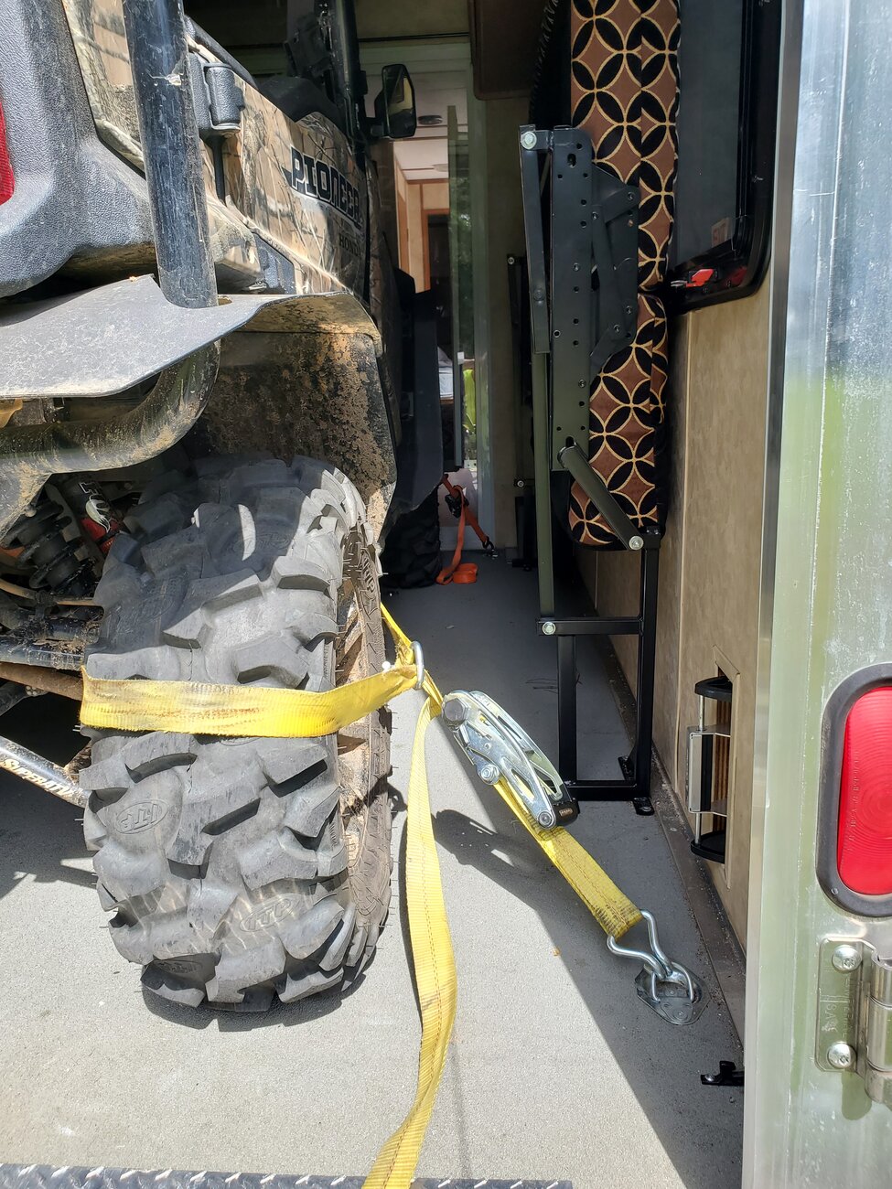

I'm thinking about strapping the pioneer down like this. One strap on each tire. Any reason not to do it this way? I see cars tied down like this all the time.

That will work but usually the tie downs points that come with TH’s are not the best points and your straps WILL losen at some point during the trip Plus u want it tied down so if u sudden stop she aint gonna give in any way. Id recommend in the close future some Etrac and there tire straps. you will be much more secure and a worry free trip.

I agree about the e track. We was gonna try to get by without it first. Didn't want to put anymore holes in the floor just yet if we don't have to. Don't want to end up with a broken glass door though. I might make some type of wheel chocks out of wood for the back tires. Maybe go the entire width of the garage and they could kind of wedge in between the back tires and the couch frames. Just drive over it with the front tires

Wouldnt doing all that put holes in the floor anyway to secure the wood? Or am I missing something?

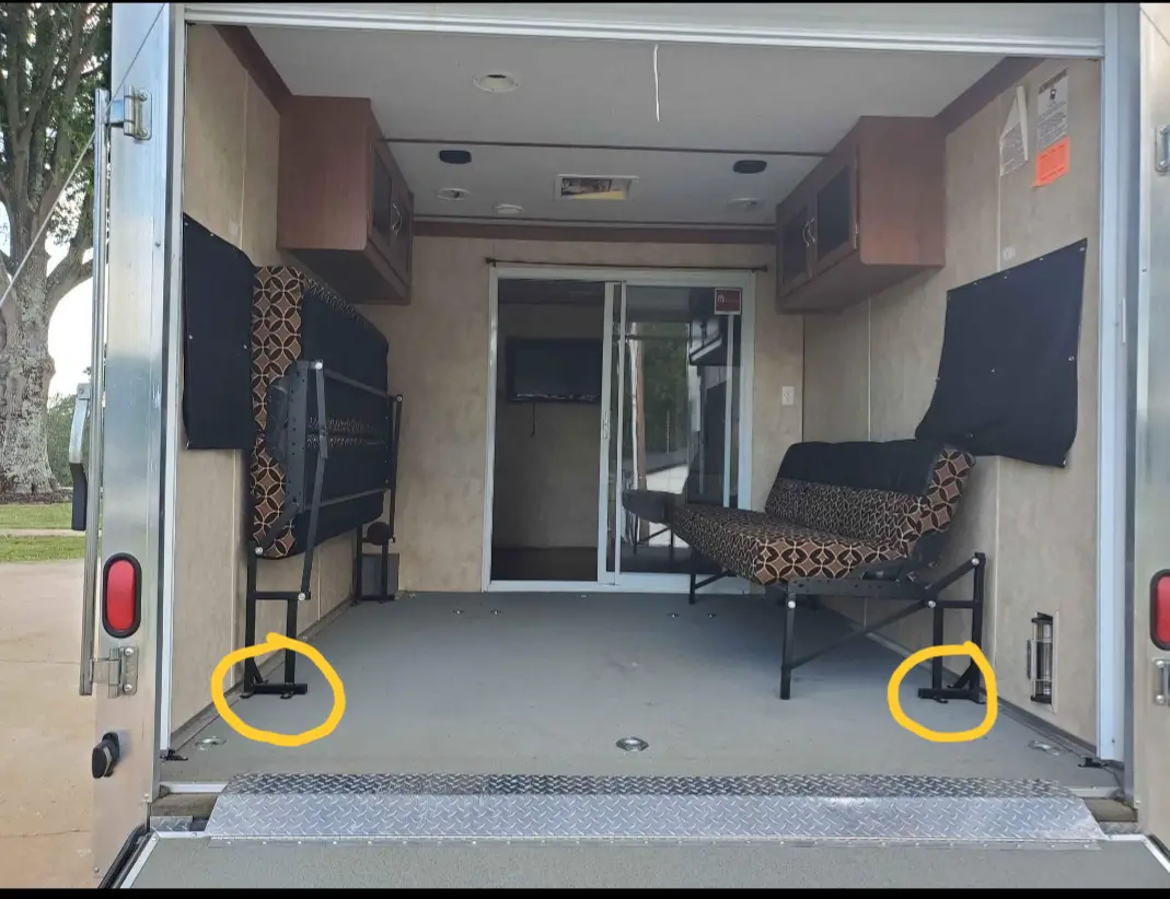

Wouldn't fasten it to the floor. Make it go wall to wall out of 2x4 or 2x6. Push up against the couch frame where I have circled. It should prevent the pioneer from moving forward. Wouldn't help with moving backward. But I'm more worried about the glass door to the front getting busted

Not a bad Idea. But having a few TH‘s in the past, those areas are not braced very well at all. In fact there usually just “screwed“ to the OSB floor. It may look like it will help keep your rig from going into your glass, but the fact is that the rigs force will snap those couch frames like a toothpick. Seen it happen in a friends TH.
Not used the same as your thinking but used those for a bracing. Kinda of the same way lol.

Yea I figured they would be screwed to the floor not bolted. I'm just trying to cheap out right now. The wallet done got thin. 🤣 I need to see how the tie down points are fastened also.

No, I understand! been there done that. Etrac for that should be no more than $300 right now. Cheep insurance. Something to think about. RV’s aint cheep. They nickel and dime u like crazy at times.
