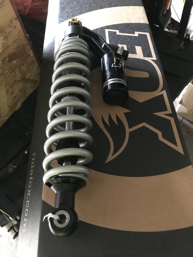

My Fox shocks came in today and I am hoping to install them tomorrow night.
I would consider our style of riding at "sprited", we aren't the fastest in the group (limited by hp and speed of machine) but we are far from the slowest. Usually there are 4 of us in the Pioneer, about 400 lbs up front (me 240 and wife 160) and about 150 lbs in the back seats (two 70 lb kids). What would be a good starting point for the setup??
Do I need to adjust the spring preload or should I just leave it alone and try the way it is right out of the box?
Any other tips or tricks with the shocks?

i think its all in what you want to do !! but if it was me and i was a "spirited Rider" Id start out with setting them hard and then walk it down till you find your sweet spot for the shock and your riding style.

View attachment 50849 My Fox shocks came in today and I am hoping to install them tomorrow night.
Welcome to this crazy club! Set spring tension to around 11 inches ground clearance front and rear with the weight you mentioned, that will be a good starting point.
Reactions: PHS79 and bobbyhill

Do Fox's have rebound adjustments? Do you ride in the rocks or sandy whoops? Rocks set your rebound quicker, in whoops set rebound slower to keep the kick back down.

The fox spring tension is pre set for your pioneer

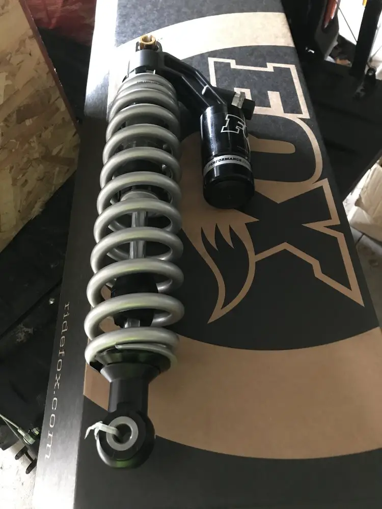

Question for you guys with the Fox shocks. I have stock wheels and tires on my 700 currently, I just got done installing the shocks and I only have 1 1/8 inch between the sidewalk of the tire and the piggyback res. Is this normal?

Yep it's fine. I thought the same thing at first
