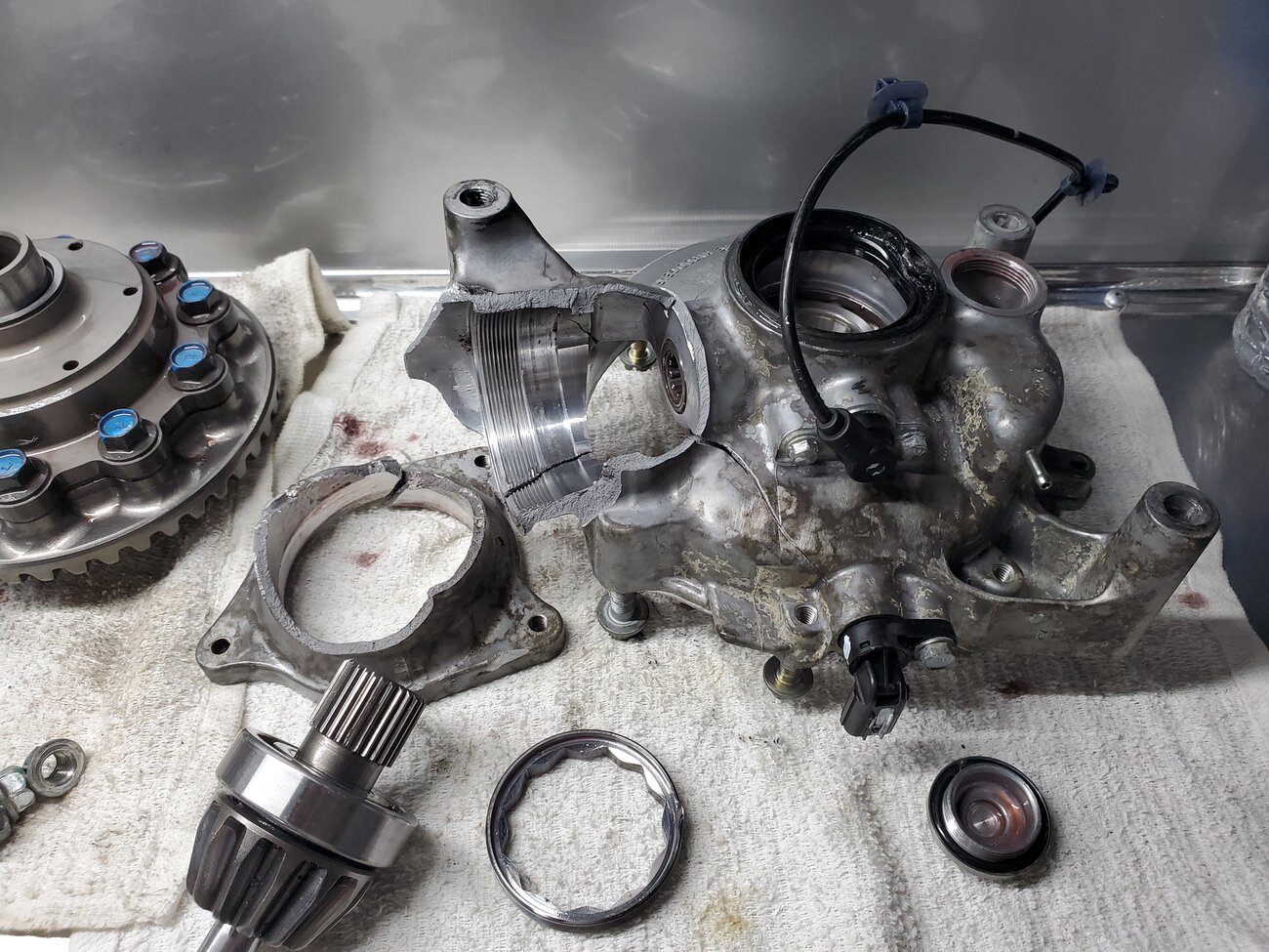

has anyone had the pinion out and if so where did you get the socket to get the nut out
8,237
62,182
@SLOWPOKE693 figured out a pretty good way to get it out:
Use a flat head screwdriver and a small hammer and tap it around to get it out. An adjustable spanner wrench may work too.
