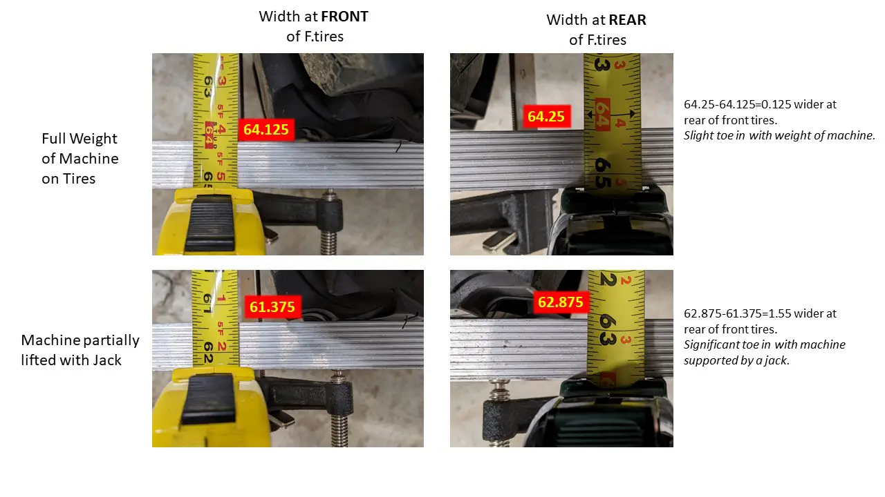

This has probably been covered somewhere in here before but I haven't run across it yet so I thought I would post.
When doing a front end alignment, make sure you do it with the wheels on the ground and if possible weight the machine as it be when you're driving. As the wheels move down (like when jacking machine from frame) the wheels will toe in. So if you perform your alignment with the front wheels off the ground, when you let the machine back down the tires will toe out.
For example, if I would align the front tires on a jack as shown by the bottom views of the pic below then the front tires would actually be 1.5" toe out when I left the machine down from the jack.

For reference, I align my machine with a 1/8" toe in on the ground knowing the tires will toe out slightly when I jump in to drive.

You actually want them slightly toed in when you're driving. Toed out will make the machine sway side to side on high speed runs. Also consider putting something like plastic under the tires when aligning, they won't bite so hard into the concrete giving false settings.

Thats the problem. Its been determined that the factory is torqueing the A arms at full droop instead of at ride height. And they are probably aligning them in the air and that would be the reason the units are being delivered so toed out.
