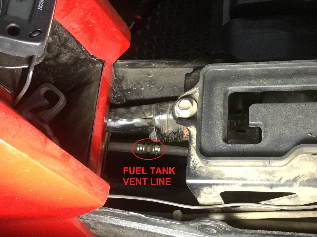

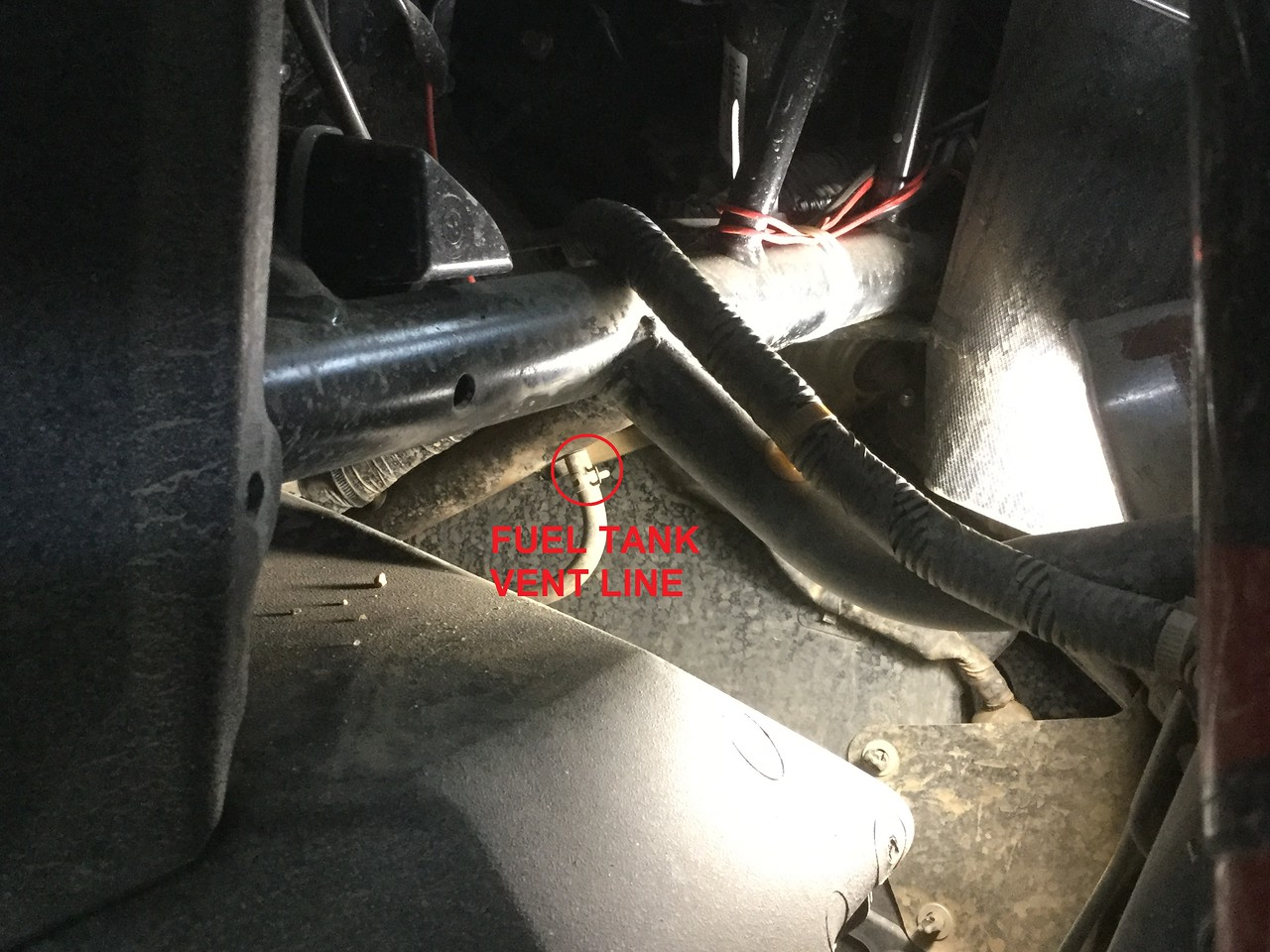

I'm in AZ but my 2021 Talon X came from CA. Any insight as to how to remove the evap system (what needs to be removed to set my X free)???? Thanks!
I don't know where the evap parts are but I know where they aren't.
If you have this splice under the console, the Freedom models run straight forward from here -
1647548369191
to here, right below and behind the underhood, rubber firewall. There's nothing else involved. There are more pics on where I extended my vent linked in my sig if you care, including some basic Talon information if you haven't seen it.

Thanks!!!!
