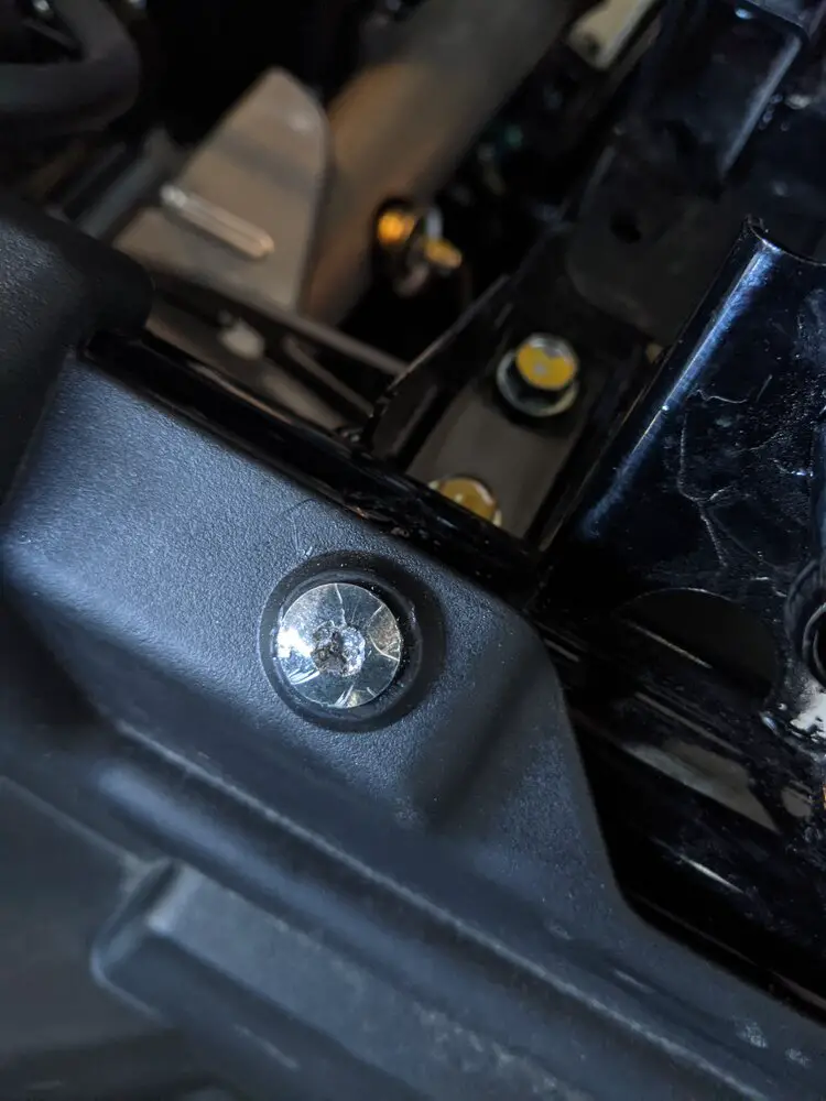

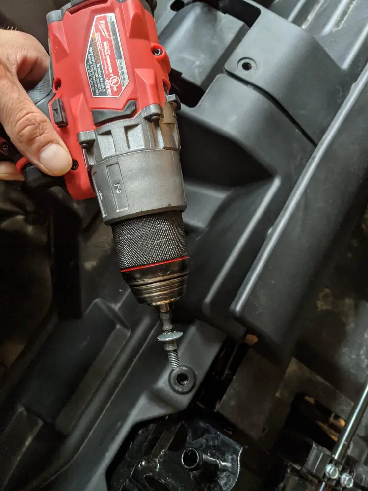

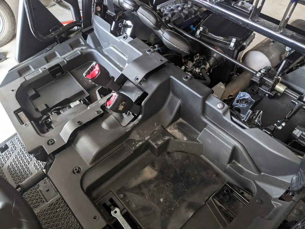

Here's some more comic relief...any ideas I'm all ears. Got everything off and basically have the seatbelt clip exposed but cant get behind it. Last screw on the drivers side View attachment 272711to get the panel off and it is on there so tight I stripped it. Went slow with hand screwdriver, then slow with drill, then tried flathead. I can't get the thing off and it's stripped now like a mofo. So funny I need to add all this to my build thread.
I don't have any rubberbands at the house to try and not sure what else to do besides drilling it out or getting an extractor.
Any ideas?🤣

The question is what tip were you using? Those are #3 phillips not #2's. Just thought I'd mention that so you don't strip any of the other 3.
Thanks - I got 5 of them off without any issue and this one was the last one that was stuck. I'll have to double check the head size but I didn't have any play in the bit when it was in the screw head.

That's right, there are 6. They're for sure #3's though. Been several threads in the past of guys having a hard time with these. Honda torqued the hell out of them. Good luck man.
IIRC, mine looked a little corroded as well, even on a brand new machine. I'll be putting some anti seize on them when they go back in.

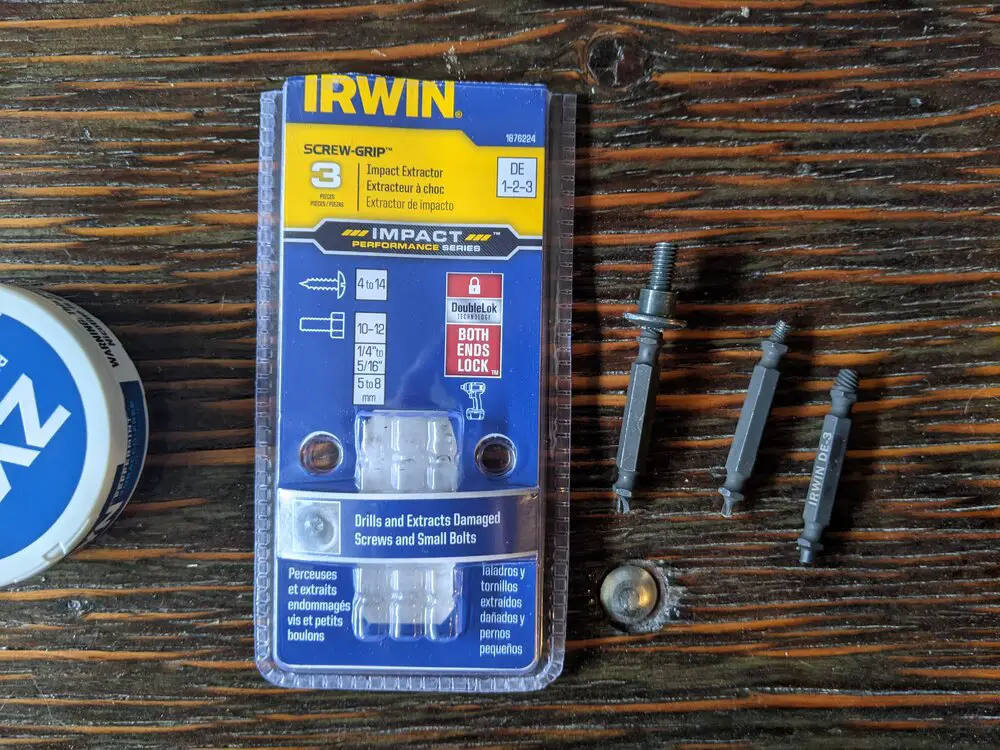

Thanks guys! Took about 1 minute once I used the easy out like @SILVER_ALERT suggested! Now fingers crossed the seatbelt bypass works 🤣

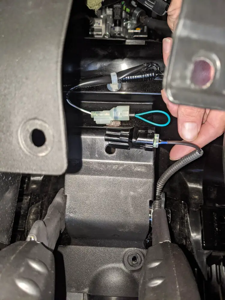

Does this look right? I Thought the looped end was supposed to connect to the seatbelt?
Edit - I turned the key on with the connectors like that and the seatbelt sign on the dash wasn't flashing. when I connected the seat belt back together like it was originally, the seatbelt sign on the dash was flashing. wondering if that means it's working haha?

You good. Congrats! 😎🤘🏾
