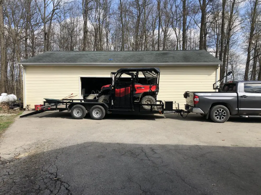

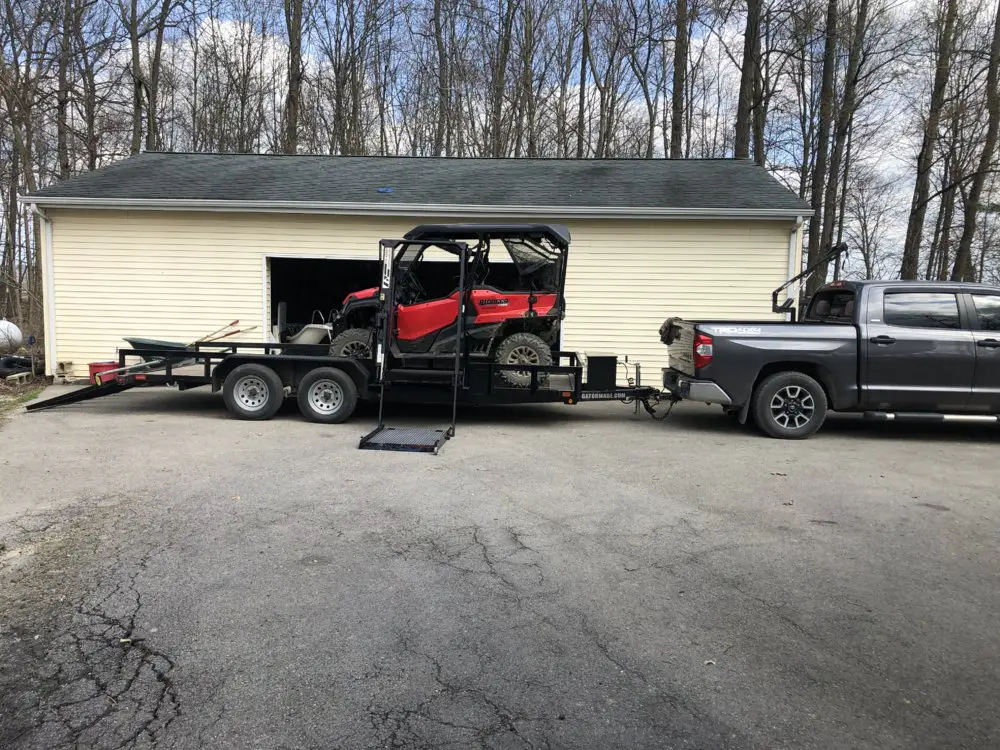

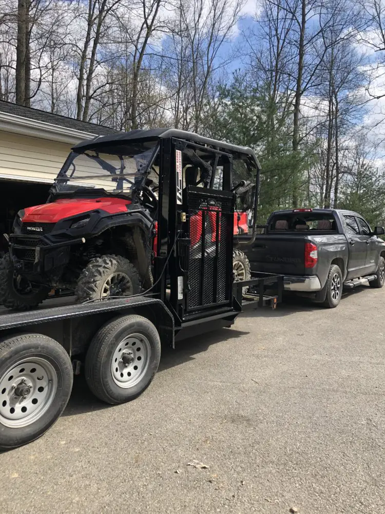

I’m new to the sxs forum but joined since I’ve become the new owner of a 2018 1000-5 pioneer that my wife surprised me with for Xmas this past year!...Y’all carry on some good conversations and cover quite a variety of interesting topics!
I’m a paraplegic and wanted to be able to haul my buggy, that I’ll use primarily to hunt out of, and to remain as independent as possible.
I hooked up with a local dealer that made this trailer for me, and words can’t explain how appreciative I am of it, or how sweet it really is!
Took a wheelchair lift out of a van/bus and mounted it to the side of an 18’ Gatormade. Added some extra reinforcement, has a battery to operate the lift, so any truck can pull it, but included an electric hookup for my truck to run it from there when I pull it.
I load the machine backward because I got the snow plow with the machine, so to allow for the room for it, and to be able to have the space around the fender well for the lift to be installed (which is why the lift was installed on the passenger side) and still access the machine.
I just wanted to share and show anyone out there that might find this useful, that it IS POSSIBLE!!!!
Now...bring on turkey season!!!!

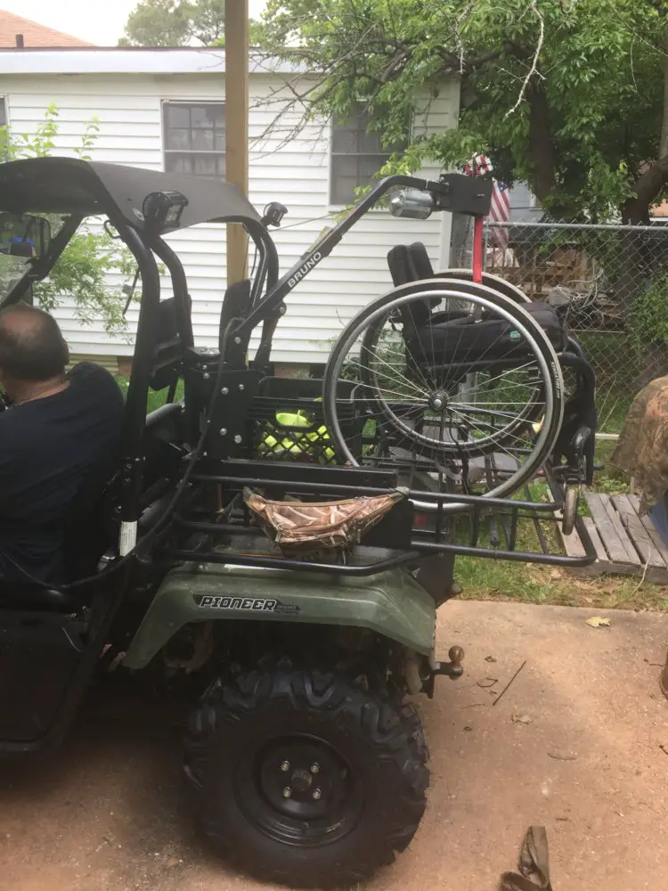

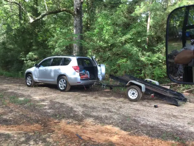

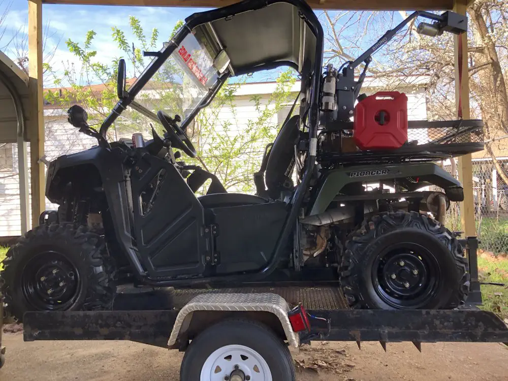

My handicap accessible P500. Hand controls installed for throttle & brake. Tilt trailer with La Trailer Dog to hold unit secure. Smittybilt winch with tethered remote used to load & unload. Wheelchair lift now installed on rear rack.
View attachment 201593 View attachment 201594 View attachment 201595 View attachment 201596

I like it but I think I would have put the lift on the other side of the trailer to reduce the tongue weight on the truck and allow you to drive the machine onto the trailer
