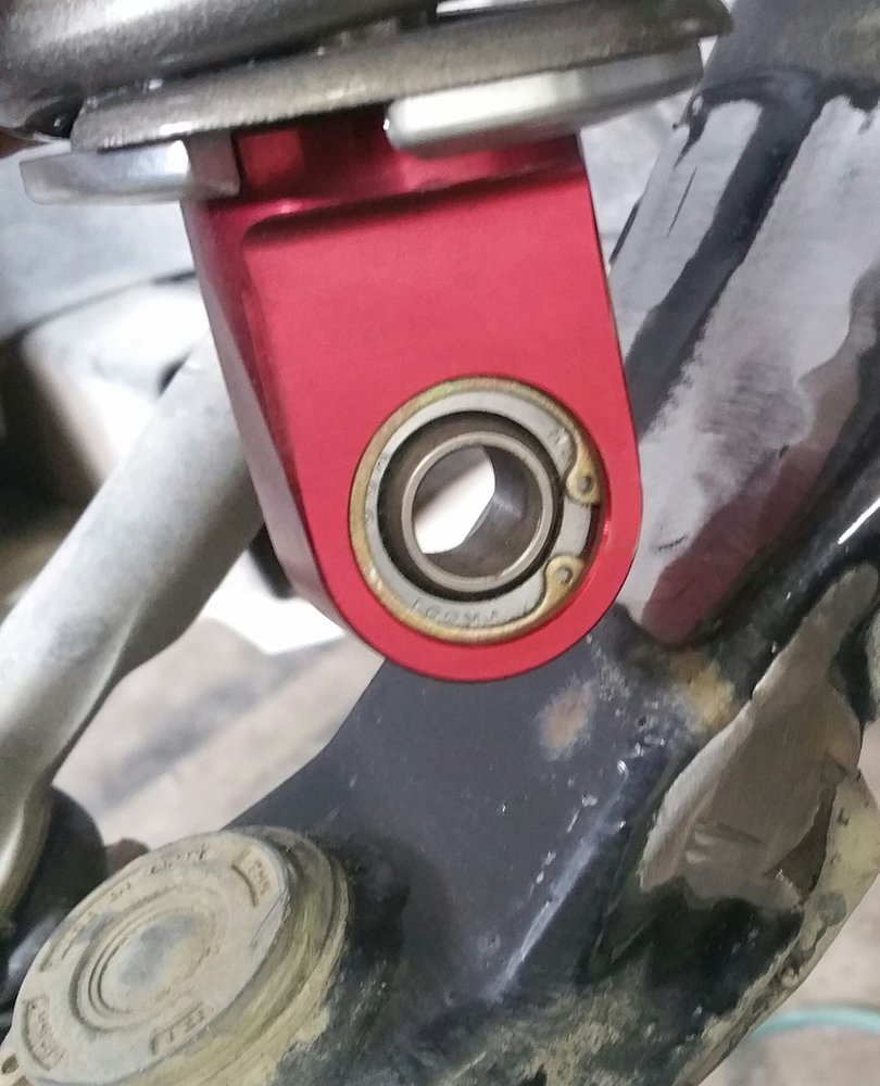

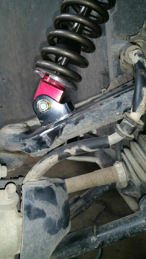

Cut off stock lower mount....turn it around so shock bolt hole is toward wheel more .....move it less than an inch....weld back on.
20160910 104125 001 1
first time i did one it took about an hour and a half...
Lower turned around
this is mount turned around in position to weld back on.
you can then use any front shock that fits the yamaha rhinos. I went with walker evans,there are cheaper ones available.
Mines a 2015. I had 2016 pioneer replacement shocks on mine.....LITTLE improvement.
Just changing the front shocks this way (without doing the back) improves 80% of the ride.
Too bad you cant test out mine or other members machines who have done this. It completely changes the machine for better. NO more being bounced off the seat just driving a rougher trail.

Cut off stock lower mount....turn it around so shock bolt hole is toward wheel more .....move it less than an inch....weld back on. View attachment 40454 first time i did one it took about an hour and a half...
And if you go with WE shocks , change spring to 160-175 lbs rate (Rhino shock comes with 250 lbs)
