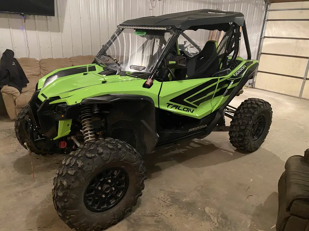

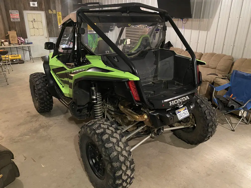

They’re about 3200 miles on them right now and 50% that’s blacktop as you can see with my license plate I do a lot of road riding and trail riding I’ve already bought a new set I won’t run anything else
