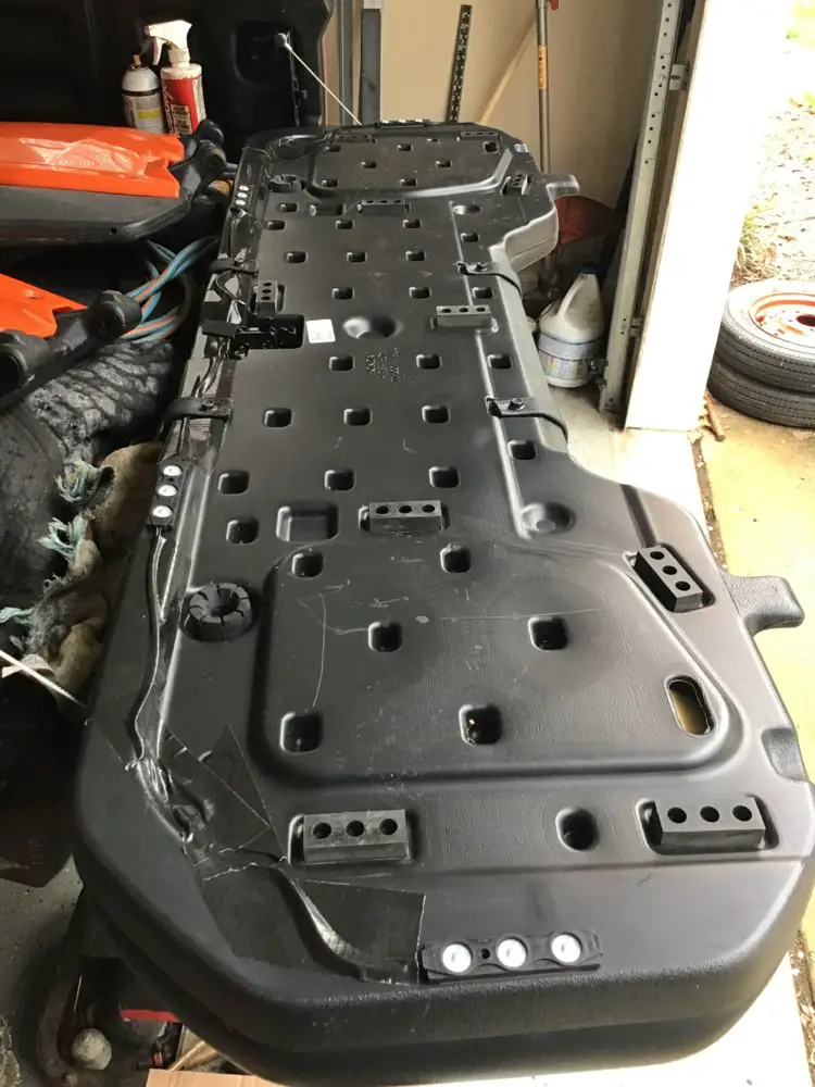

Attached the four 3-led pods under the seat and taped up the loose wires. Pods are flat enough to fit with no interference and gives off alot of light...
Looks amazing.
Now to answer your wife's question...…..
Tell her that hobbies are just like the proverbial glass.
Most people want to know if the glass is half empty or half full.
My answer to both questions is...….
THERE IS ALWAYS ROOM FOR MORE!!!!!!

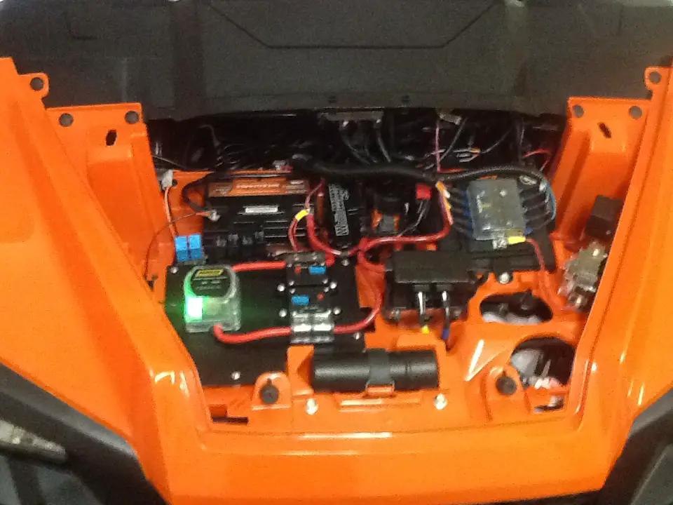

Still waiting on a few parts to make up my door switch control box... need the terminal strip and dual fuse holder... but everything else is in the box! Tight fit...
