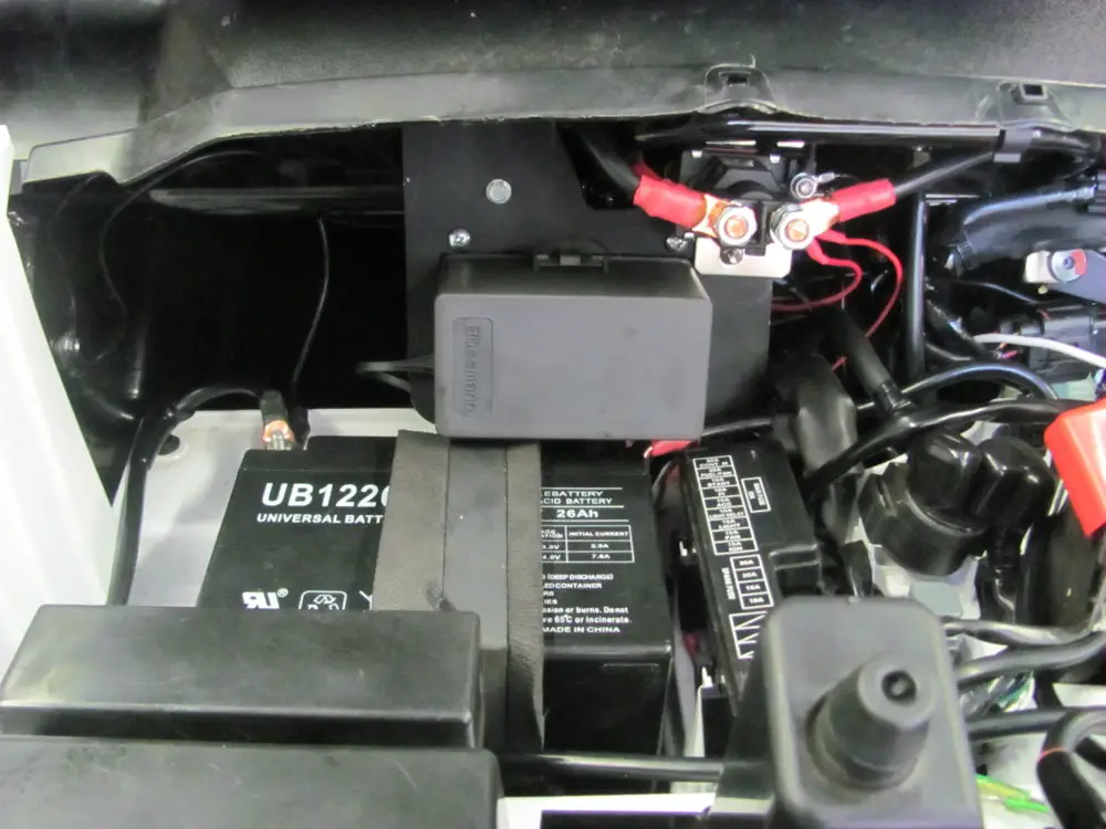

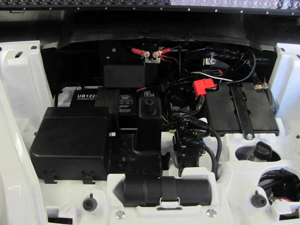

just wanted to show a few of the things I did after gathering a bunch of yalls ideas and putting my own interpretation on them. first was adding second battery an isolator and the bussman fuse box.
20736 7818e3ffb46bd7fd23d2b45566cc716120737 8e0ac9ccd8271494579ddf724a688853

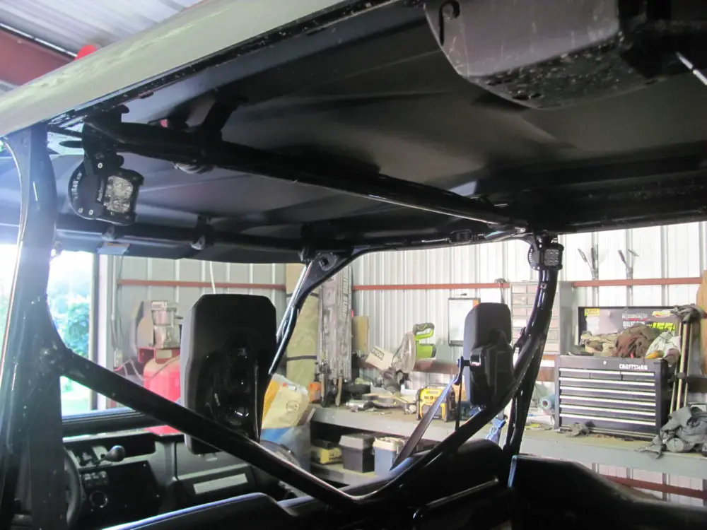

next was the 50" lightbar and two cube lights for the rear
20740 a0caaebda89f64df7f90a14760a789db20741 5aa6c2a56dd91e0f04ea1fa26d1017c7

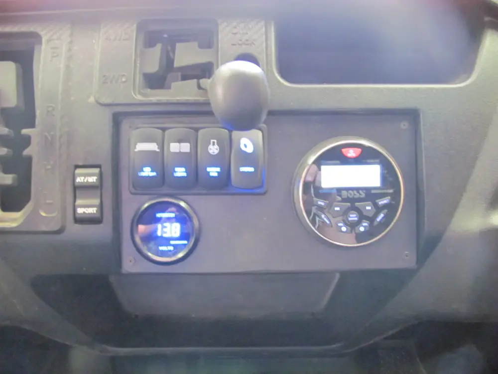

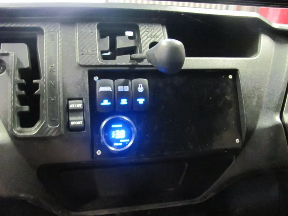

then switch panel with room for future expansion for radio among other things
20742 b1a16dfb7b1f356aef87c90dc3ac8afe

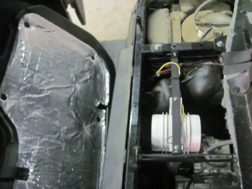

and heres the insulation attached under the seat. its also under the seat back and between the back and the bottom. also the 4" bilge fan.
20743 846af9cdde4f9b178f5a042d216ece72

Would you mind showing a close up of how the light bar is mounted?
Sent from my iPad using Tapatalk
hdb444
hdb444
Aug 9, 2016
9
21
sc
just used a piece small piece of angle iron drilled and tapped one of the roll cage bolts on each side. then I had to drill new holes in the supplied brackets that came with the lightbar. its real sturdy the way the supplied brackets rest against the roll cage. IMG 0939 IMG 0940

Interesting method with drilling and tapping the actual bolts! I have a 52" curved I've been meaning to get mounted in the same place for awhile now.

finally got my radio installed used a boss marine radio with polk speakers. mounted speakers in pvc end caps like another member on here did. really liked the way it turned out.View attachment 22951 View attachment 22952 View attachment 22953
Can you give me any more details on that speaker setup? Like what brand and size speaker? How you mounted the speaker inside the cap and did you need to vent the cap? I bought schedule 40 6" caps but I'm not sure how to do the rest so I haven't even started on that project yet.
moparornocar
moparornocar
RIP....Rocmar...
Jan 26, 2016
4,606
12,493
Augusta, Wisconsin
You'll need a length of 6" Pvc pipe as well, cut off a 2 or 3 inch length and cement it inside the cap flush with the edge so the screws holding the speaker have something to bite into. No venting needed, just drill a small hole in the bottom to feed the wire through.
