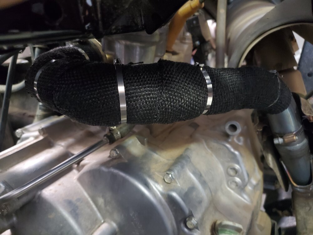

Anybody ever wrap the exhaust on a P5 to reduce underseat heat? If so what were the results?

Wrapping the pipe is not a good idea . Could cause it to overheat and split . Use heat/sound deaden er . Contact Trigger

The material in the picture is exhaust heat wrap with stainless Zip ties made for high temperature pipes.

He's not talking about your wrap splitting, he's referring to the pipe itself. The wrapping won't allow the heat to dissipate the way it's intended and causes the pipe to overheat. Read where someone tried it on a 700 and that was the result.

Man header wrap sucks. That's the best way to rot out an exhaust pipe as it traps dirt and water. If you want a pipe to be cooler go have it ceramic dipped. Will cut the heat down by half or more.
