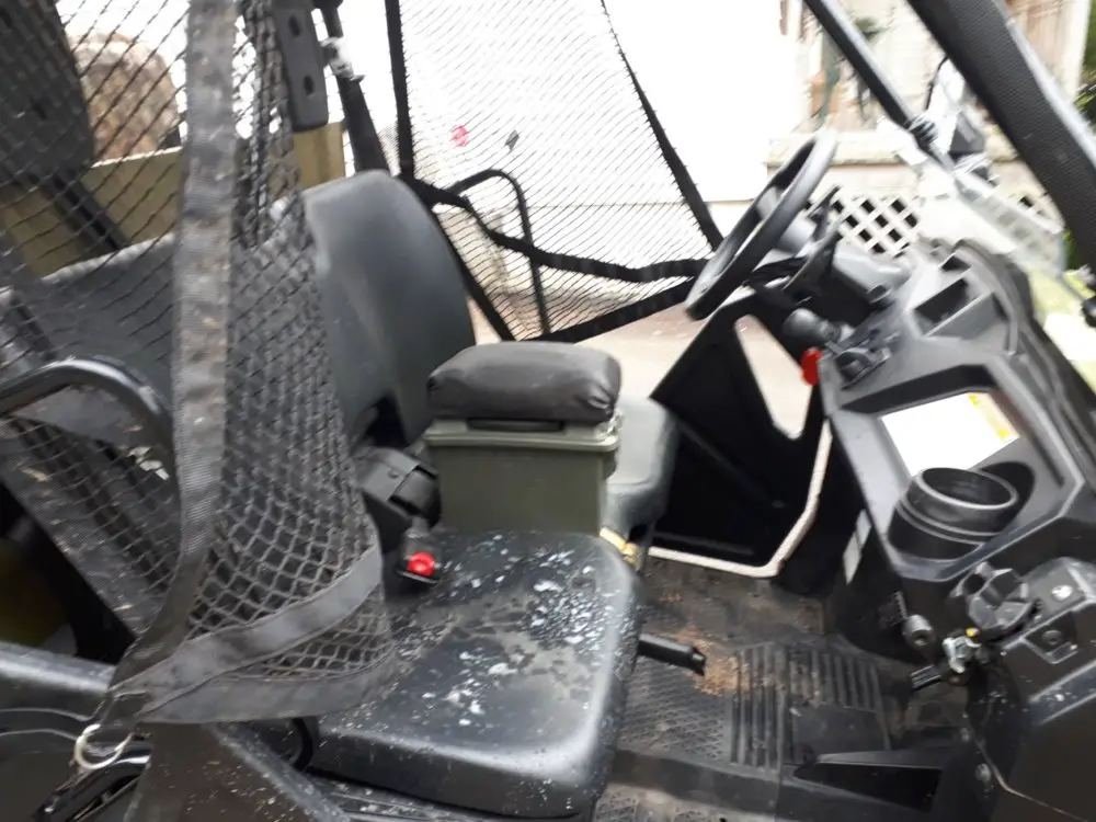

On a related note, what about the center console you have installed? That is, do you have a plan and/or options of purchases regarding it?
Lol, I considered it. That thing was even more tedious to make than this! The bigger problem is I really don't have time to do any of this but I have the material and just trying to help out my fellow P5'ers. I honestly believe there's no better way of doing this. IDK, maybe I'm just too picky trying to make things perfect?

Looks nice and if you get a minute, how about posting a couple pics of the console, because it would be high on my list of options..

Don't mean to hijack your thread, but how are you holding your center armrest on? I have one also, it's an ammo box with foam top. I hold it on with a short strap around the seat bottom. View attachment 105389
Kind of the same way. Hasn't moved in almost 3 yrs.
Just read your build post and see you're using the same thing. Thanks! I was wondering if you had a better way, but I guess the straps work well.
