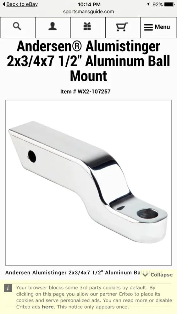

This is what we got specifically for the pioneer. I think it's only rated for 5k and 500 tongue but works very well and doesn't rust. No matter what you use the darn retainer clip on the pin is a pain to get out and you lose skin.

I noticed the same thing tonight. Because of the way it's designed it's somewhat difficult to slide that pin in and put the clip on it so I agree.
But that doesn't seem long enough like it would stick out far enough? Wasn't so lazy I go outside and measure mine but that looks like identical to what I have and it just doesn't come out enough??

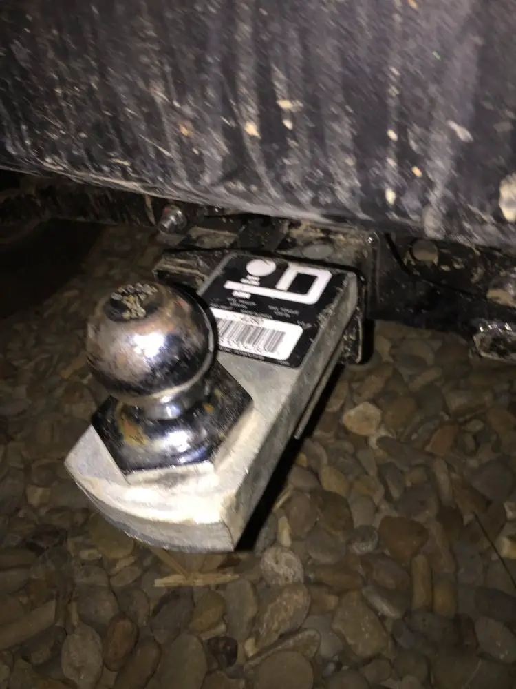

I don't understand how that's working for you CP. not at 7 1/2. My regular one that I use for my truck is 13 inches overall and doesn't come out far enough out for me.
How are you getting by CP with only 7 1/2 inches? When you hook the trailer up you're not wedged up against the muffler?
Here's a pic of mine with the 13 inch which means your 7 1/2 shouldn't even clear it :)
And even at that length the top of the trailer coupling hits the muffler.
I should have taken the picture sideways because this way it looks like I have clearance but if you look at it from the side you can see the ball is actually under the muffler

It could stand to stick out just a little bit more but it's not to bad. It's about a 1/4" from being perfect but we used it a lot with no problems. I'm pretty sure this is our exact one here's an old pic.Imagei wouldn't want it too far out because it gets harder on the vehicle and may interfere with off road but it works fine.
