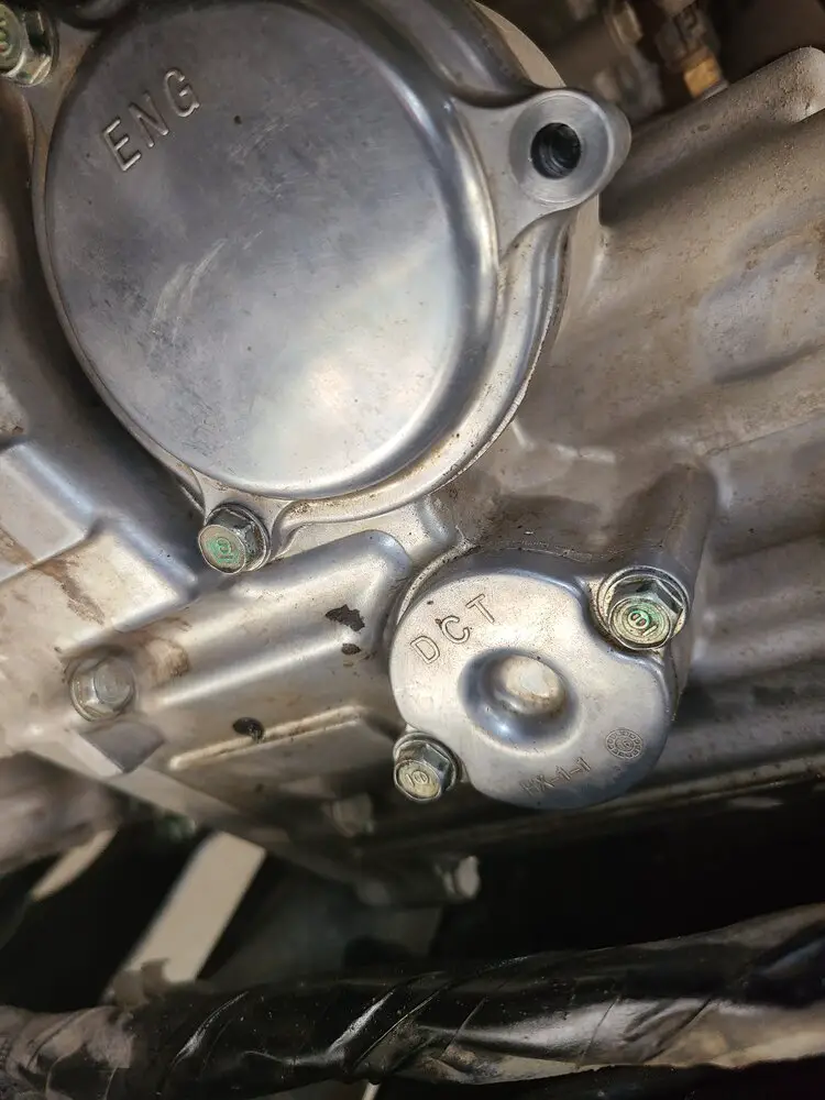

I told him just you your hand , I do t know why I'm so mad now :) , .at be bc I found this pioneer for him and he is raping it now brutally :)))
It hurts to see those holes and damaged bolts

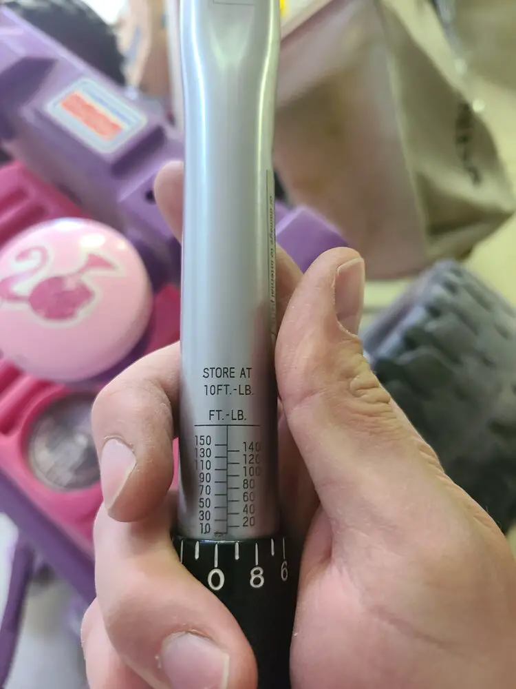

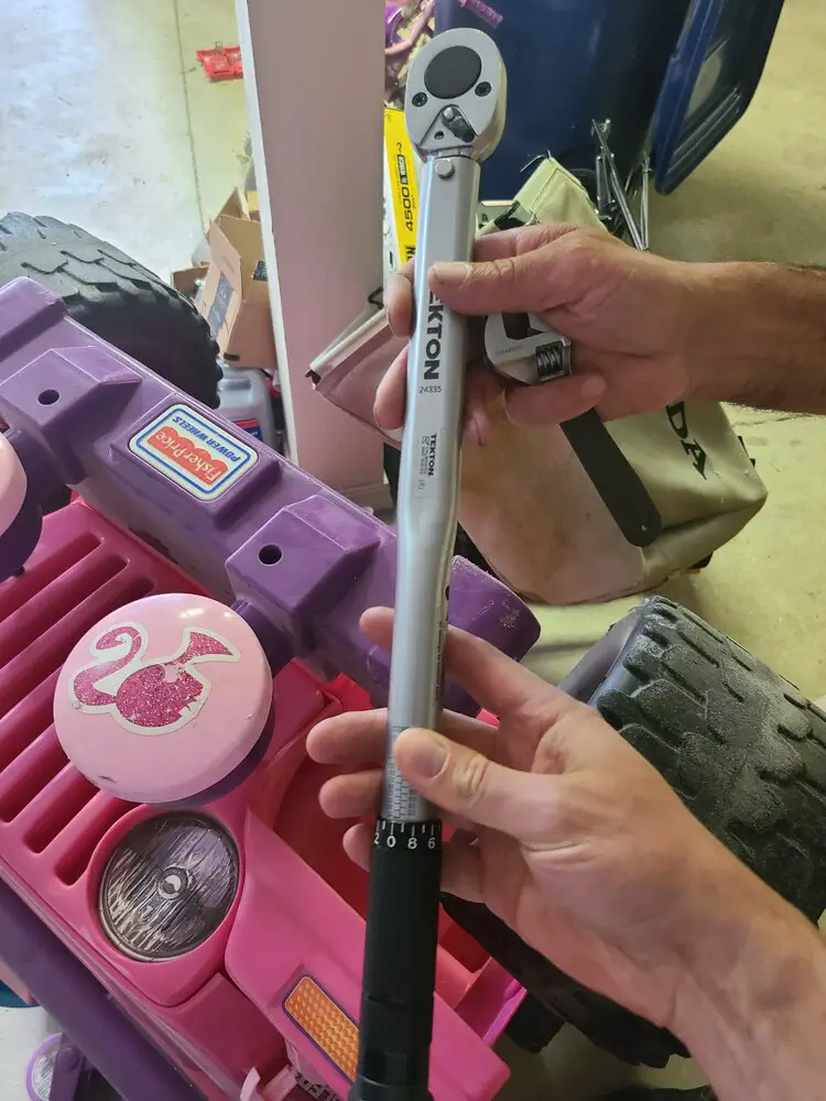

My neighbor got new p1000 and said he wanted to do it like pro mechanic and had only this 1/2 torque wrench that starts with 10 ftlb , he thought by twisting the dial lower he can lower torque effort . He bended/twisted 2 out of 3 bolts and decapitated the third bolt. He blamed our forum guy on the video :) who said that specs are 9 ftlb instead.
But I told him that he used light house grown big cucumber to f... small rabbit instead of using baby carrot :((((. Sorry. I was mad at him not even asking if doubt.
I said get left handed easy out bits , he got them. I told wait for me, im back from work in 4 hours, instead he found leather punch not metal punch, did not punch properly and started to drill the broken bolt and went towards engine housing , the hole looks like triangle now, bolt still there . I'm pissed now. And told him to take it to dealer , bc the engineView attachment 206666View attachment 206667View attachment 206668 needs to come off, its not possible to do anything since space is limited and direction changed .
Please send a pics of your tools to your friends who have more experience with such type of work versus trying to continue to screw up more and have costly repairs . Don't fffff rabbit with cucumbers :))).
Lol.. is that a 3/4 inch drive? Lol.
I must advise against using a torque wrench at all for the oil filter caps.
Use a 1/4 inch drive small ratchet and feel them out, hand tight plus a hair more.
F .. no, go bigger, its 1/2
