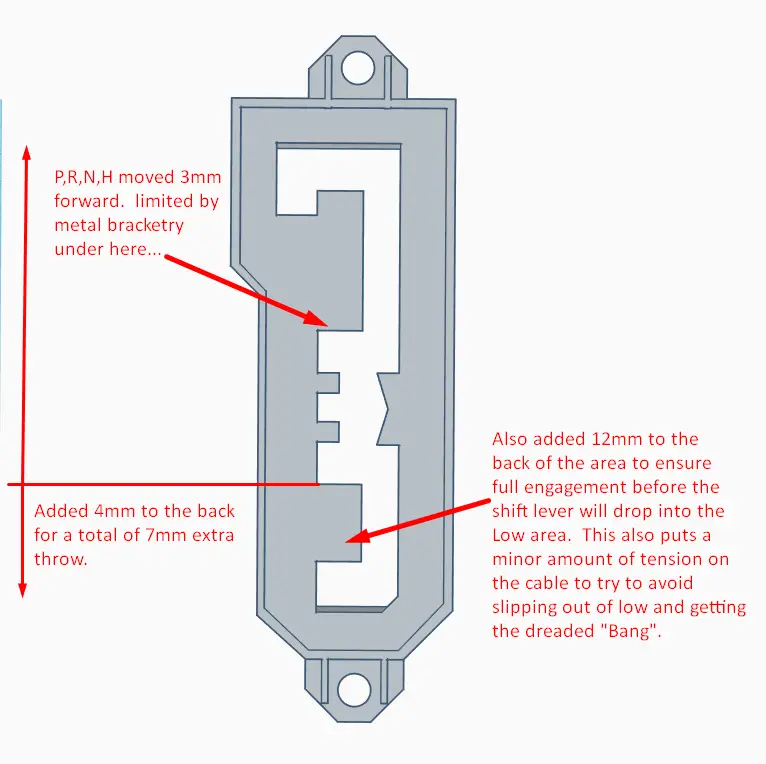

What's funny/sad/dumb is that this could be solved by a $10 piece of plastic. The low gate needs to be further back and smaller imo.
Mine is at the dealer, was supposed to be ready last Saturday, then yesterday, so hopefully today is the day. I'm planning on making a new gate out of some 3/8" uhmw or similar. Basically just copy the stock one, but have low 1/4" further back and smaller. I'm not going to have my machine at the dealer for a month again because of this stupid design flaw.
If the shifter is in the low gate, it should be in low, period.
Mine has ground, or poped outgoing into low also, probably 4-5 times, never happened until temps got below 50 degrees. @Tigermark watched it happen twice in one day. I’ve never “beat” on my machine, and have found the same thing everyone else agrees with. The gate going into low needs to be 3/8” further back, both the opening and the the beginning to it, and the furthest back part of it. When I shift my talon X into low, I have to now stop, wait for the instrument cluster to read L befor I can move forward. As cheap as the field is, it should not be acceptable for what we pay for these machines.... call if growing pains of a first years rig.
I owned a pioneer 1000 for 3 years and 3000 miles and never had this issue, I truly believe that it’s the plastic shift gate in the talon

He made a new shift gate giving low a 7mm over shift. I'm getting by with about 3mm. It looks like some Talons are stiff shifting until they are warmed up. Mine is working so good I'm not going to get it fixed right now. My 2019 is set up for my night rides and I need it everyday. It just takes a millisecond to wiggle the shift lever and we have to stop to shift so its not a big deal. If the shift lever is loaded forward in the shift gate its not fully into gear. All shift cables have some rope effect and a much more stiff shift cable may fix this problem. Honda is probably working on this, the suspension settings, and the air intake system.
Bob, Check you PM please.
Prototype #2 and 0W-20 in Sub Trans tested at Sand Hollow for 5 days. Temps in the 40's to 60's. 170 miles total. Although most of the miles were street/dunes/trails, the majority of the hours and shifting were rock crawling. Purposely shifted without looking at indicator to see if there was any improvement. MUCH improved and only one instance where I got a slight grind into Low but that was my fault for not stopping completely. Overall, I was very pleased but wanted something more assuring that I am in Low without looking so I added a bit to the rear of the gate.
Shift gate Prototype #3 design complete. Printing now and should be ready for testing tomorrow. After a bit more testing, I may offer this for sale if there is any interest...

Final prototype done. Final fit and testing to take place over the next week. Design will be finalized after testing.
$40 shipped in the 48 states. Hawaii, Alaska and Canada upon request and will be a few dollars more depending on shipping cost.
These take 16 hours each to print so if you want one, PM me and I will place you in line first come, first served...

Isn't easy to just grind out the slot a half of inch more so there will be no problem instead of keep driving it
Yes, you can do that too as Bob and many others have.
Be aware that there is also metal under the plastic at that point and there is very little extra plastic (maybe 2 or 3 mm) before you start grinding into the metal part. Also, to go back 1/2" you will start grinding into the console cover itself and the angle of the shifter rod gets pretty steep at that point so you are not getting 1 mm of travel for each 1 mm of material removed.
I purposely avoided removing any metal or the console with my modified gate. That is why it is moved forward and extended back. It is to the limit that the underlying metal allows and reduces the rod angle as much as possible to get the most throw possible.
The arrows point out the underlying metal and the added area (indicated by the box) also makes sure you are in Low and holds it there.
At that camera angle, you can just barely see the metal at the rear...
1582054630861
Good work.
What's strange is when I had my console completely off and was playing with the shifter with just the key on. I feel like I remember going past low and getting the - symbol if I went untill it was hitting the metal.
I just ordered a stock gate from cycle parts that way I can grind on mine a bit and still go back to stock for warranty work or if I grind it too far.
Once I get it figured out I may have my father in law machine something up out of uhmw or similar.
I think we should encourage everyone having issues to get ahold of honda and express their opinions. From what I've read they are just telling people that they aren't coming to a complete stop so far.

Paul your shift gate worked great today. I will be testing every morning on cold start. Moving everything forward gave the necessary over shift without cutting into the metal frame work. It more then doubled what was possible by cutting the stock shift gate back to the metal frame. Jefferson is right, call Honda if your having a shift problem and make sure the shift cable is adjusted in the center of the neutral gate. NOTE: The forward push pin on the drivers side hits inside the cover. Use a large screw driver to go down through the shift gate and hold the plastic cover outboard.
PaulF
PaulF
Jul 1, 2019
1,462
4,815
Utah
Bob,
Thanks for testing and the update. Please continue testing and let me know if you see anything that needs improvement or changing.
I also tested this weekend. Was at the dunes but used low a few time without issue.
However, when it was 30 degrees out Saturday night and was loading my (cold) machine onto the trailer using Low, the shifter would not move back enough to fall into the modified Low gate and gave me perfect indication that it was NOT in gear even without looking at the dash indicator. The sub-trans then "chattered" a little and she popped in and the lever went back and over. This positive engagement would have not happened with the stock gate and owners that are not aware would have assumed it was in Low and might have got the "bang" when loading it on the trailer.
So far I am very pleased with the results. The current version of the shifter in my machine is also slightly thicker to make it more robust and it fits into the console with less gap and looks better too.
What do you mean by 'moving everything forward'?
PaulF
PaulF
Jul 1, 2019
1,462
4,815
Utah
For a full explanation, go back and read the entire thread but mainly these posts by me...
