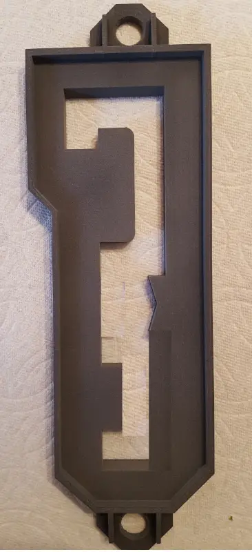

Final prototype done. Final fit and testing to take place over the next week. Design will be finalized after testing.
$30 shipped in the 48 states. Hawaii, Alaska and Canada upon request and will be a few dollars more depending on shipping cost.
These take 16 hours each to print so if you want one, PM me and I will place you in line first come, first served...

Would you consider modifying the gate so there would only be a small indention or no indention between low and high. That really helps on the trail when you shift back and forth between low and high a bunch. I like my aftermarket shift gate that I have now but it does not have the shifter movement yours does. If you can modify yours a little count me in as a customer. This is the gate I have now.
Probably not, that would defeat the purpose. The extra throw is only a part of the "fix", the modified gate area for low does 2 very vital things...
  1. it makes sure the lever is back far enough before it allows you to move it left. This provides a positive engagement without having to look or wiggle.
  2. If the gears are not fully meshed (common issue when cold) then the gate puts a little preload on the cable/shift dogs and when you start to move the machine, it forces the gears to fully mesh. This helps eliminate the ""Bang" problem.
However, i "might" consider something like this. It will allow quick shifts between R and H and a semi quick H to L shift and still maintain the extra throw and badly needed modified Low gate (pardon the bad paint edit :)). I would have to put a mark on it where Neutral is so you could properly adjust the cable...

Or do this but I think this look odd...

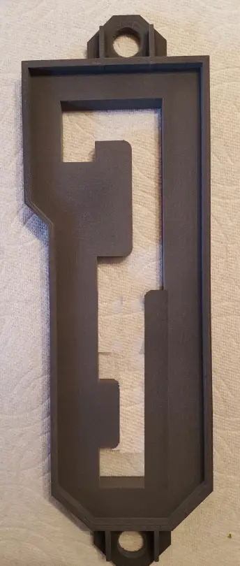

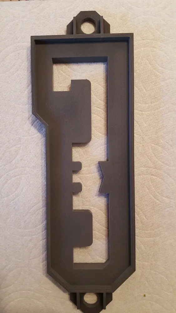

With input from the testers (thanks hondabab and a couple others not on these forums) and the community (thanks MFG), I have made the final minor adjustments and added the "Semi-Quick" version to the offering. The OEM style version is a go!!!
Preliminary testing around the neighborhood with the Semi-Quick version tells me it will work and allow for easier "no-look" shifting. It will get final tested this weekend by me as I will be doing some rock crawling and a lot of R-H, H-L and R-L shifts to make sure the gates are correctly positioned.
After this initial batch has shipped, I will start a new thread offering more.
Everyone that has PM'd me, please respond back to your PM and indicate which version you prefer.
BE FOREWARNED:
I have been told by those in the know that Honda will most likely refuse any Sub-Trans warranty claims if a Non-OEM shift gate is used, this would include both versions I offer or
any of the other shift gates on the market . Anyone installing either of these 2 versions I am offering (even the modified OEM style one) will be required to review (and possibly sign) an acknowledgment/waiver.
The Semi-Quick version turned out like this...

Beware of aftermarket shift gates. Just compared mine to stock and it has significantly less low gear throw. CA gate shift is out. Looking forward to seeing how it does w
20200228 234359
ith stock gate back on. Sorry for the shadows. 20200228 234413 20200228 234405
