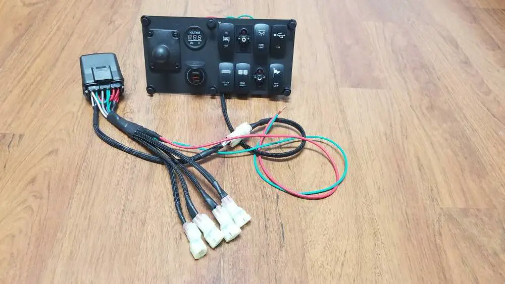

Custom switch panel and relay system is ready.
Drop in ready.
Hook to battery, plug into cig scoket. Done.
Awaiting 1 AUX rocker and a Radio rocker.
Using 4, 20a circuits. But I only used 3 here so I have a spare. Could free up one spot by eliminating USB or moving light bar to high beam trigger.
AUX will control- Key-on/off/on.
Winch only works when AUX is in Key-on mode.
Volte meter is hooked to AUX and reads which ever is selected. Key-on or battery. If I get a second battery it will read both by flipping AUX one way or other and moving the main power wires to the second battery.
Yes @Plumber32, @joeymt33 talked me into it.
Rear light is a worklight overide for auto backup lights. It is a grounded switch.
Ok.
Few more things to tidy up and she is ready to go in.
If you have a lot of money I can make you one too. Backpanel will be a little more organized for v2. View attachment 123521View attachment 123522View attachment 123523
Looks good - they also sell a combo USB and volt meter in the round configuration if you want both

Wow this looks interesting. Not quite taken delivery of my new ride, but trying to plan out a switch panel and accessories. The more I read the more I get lost...lol. I want to make sure I understand this setup. Let's say light bar on front... run wires from light bar, toward wherever I assume that relay with pigtails hanging out, place an opposite connector to the one seen in the picture and just plug it up? Makes for easy change out of accessories in the future? Definitely would like more details!

Yes.
Just change the rocker and the item plugged in is all you need to do for the 4 on the relay system.

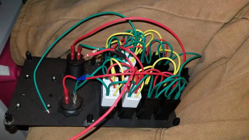

Panel is done. Cfd28162fc981a220617d0896ff4266e
