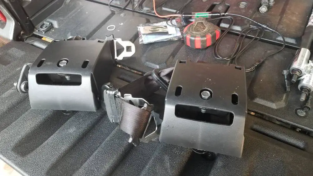

Removed rear seat belts as @joeymt33 mentioned to save weight. I never used them even once on my 2016.

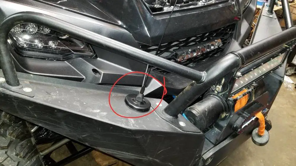

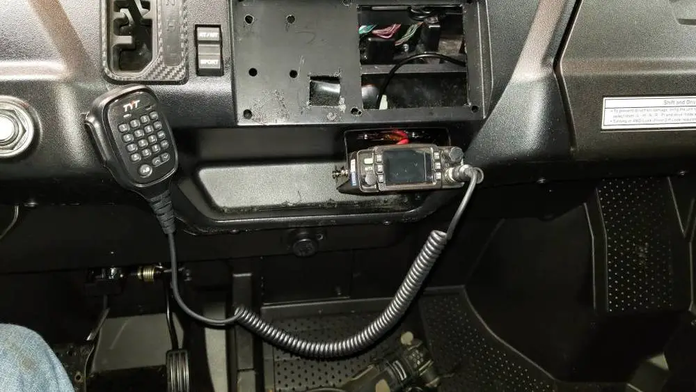

Installed radio and antenna. Best place to mount as I dont have a roof. Looked at options behind my head on the cross members but decided here. View attachment 122844View attachment 122845View attachment 122846
That will work - i’ll try and remember to bring my meter to TO and we can test it but your much better off there than having it right behind your head due to the radio waves it puts out. Plus you have a better grown plane up from on that bumper.

Anyone weigh one of the seats to see the weight savings

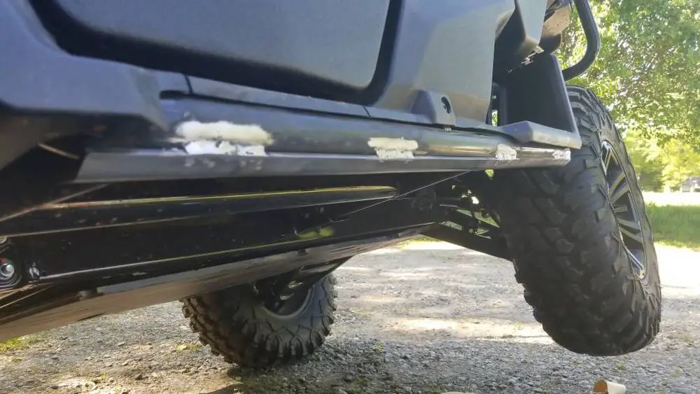

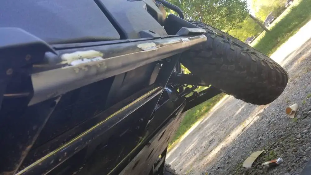

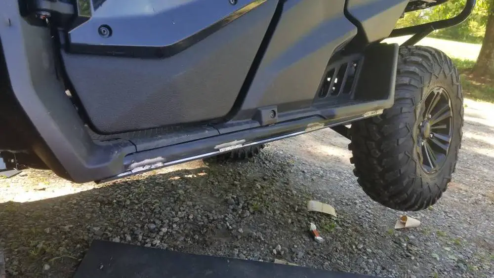

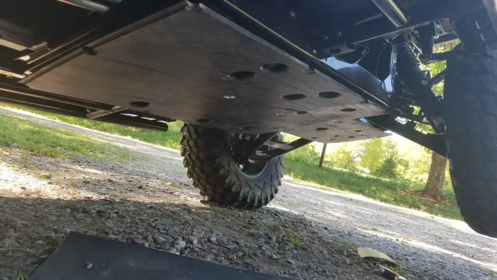

Today I got 1 wear bar grinded on. Seems I cant find my paint. Tomorrow in will grind on the other side.
Skid plates partly installed. Need new hardware.
Decided not to do the middle supports at this time.

I'd have done center supports before the rock sliders. I do like how your sliders turned out. Id probably wrap mine more towards the edge and less underneath if I made a similar mod. Overall nice work!
The bottom angle is flat on the bottom. The other angle is on the side. Hard to see but I like the location.
Chose sides because when I removed the trail armor from the 2016 and they had not rebent. Original bends were from factory skid plate and I pulled them down when i installed the skids.That was 2 years ago. Sides on my 2016 are beat to hell.
