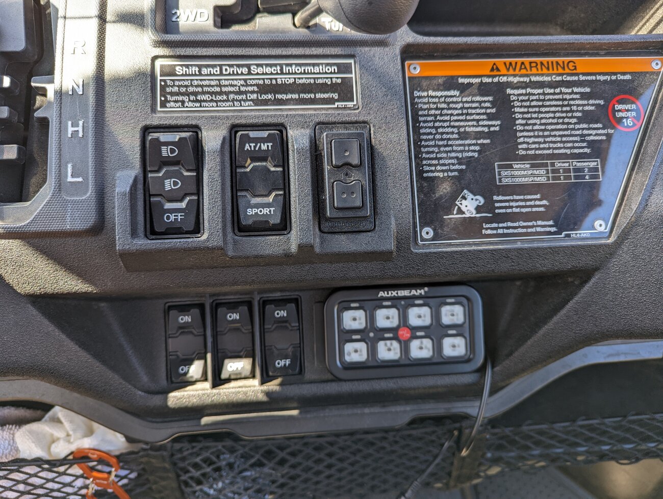

I'm going to put it in that cavity under the hood (where most people mount them). I think I have it figured out. I'm going to use a lashing strap. I'm going to melt two holes in the strap, drill two corresponding holes on the side of the cavity and use the plastic style rivets that hold on the various plastic parts on the Honda to hold the strap in place. Since the battery fits so tight in that space, the rivets should not have any room to back out, so they should secure it for the most part. I'm probably going to wedge it too with some foam on the side to limit any movement as much possible. I'm expecting the extra cable and connectors today since for my setup, I'm going to have to make or modify the wires. I plan on mounting an Auxbeam controller on top of the battery too. That will be hopefully negate needing a stinger or relay. I'll use one of the factory switched to turn the Auxbeam on, so there should be no parasitic loss when not in use and still allow it to be used with the key off. The Auxbeam switch plate fits perfect on the 2022. I test fit it the other day.
