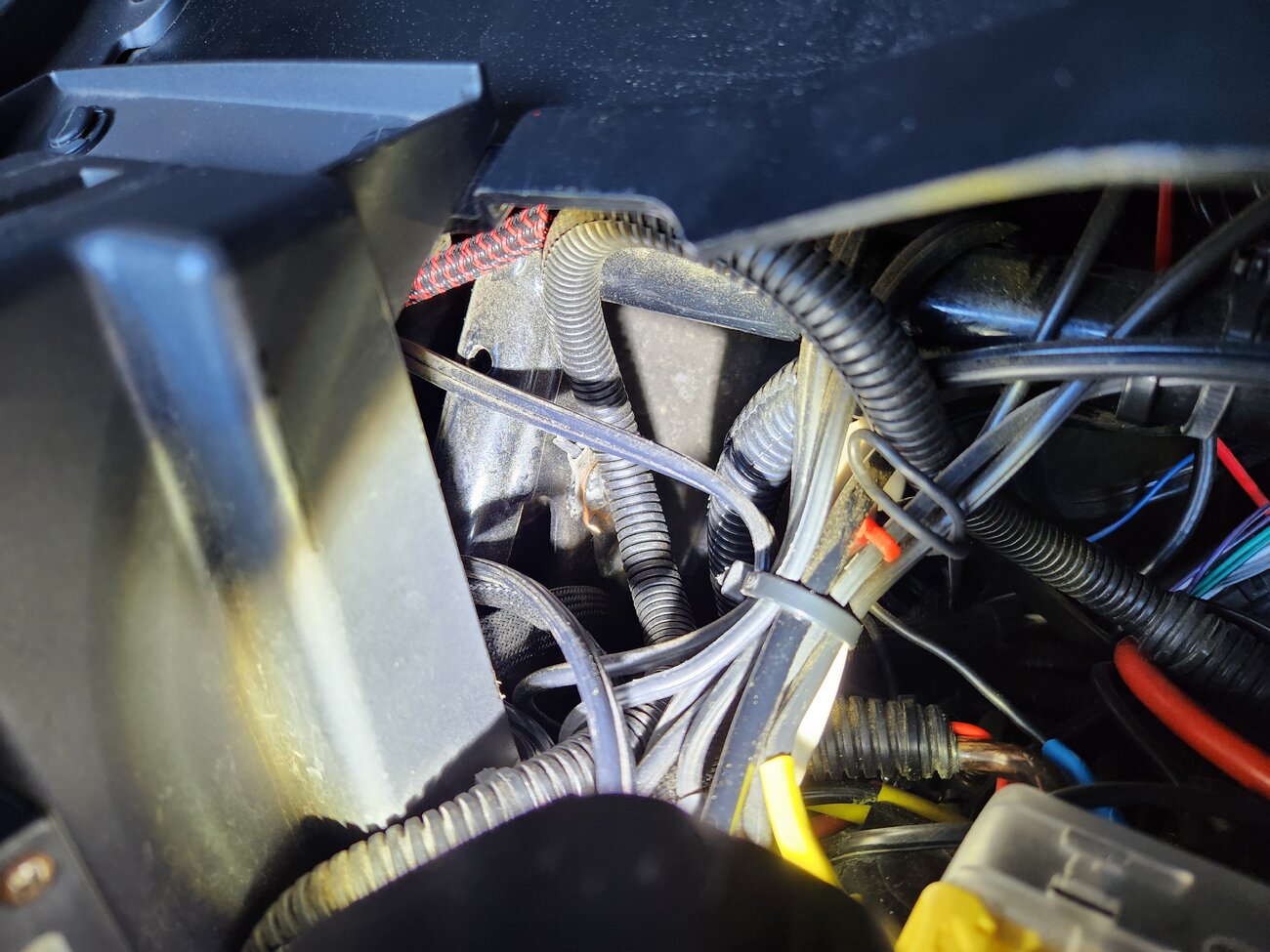

  1. 1000 6 Crew
@JGG
I did this.
OEM hole in the left upper frame, under the hood. Ground the powder coat off, tapped and threaded in a bolt, dialetric grease.
2nd battery, Isolator and accessory fuse box grounded here.
I'd add an Auxbeam from the club store, if doing it all over again.
Neat and saves space.
I used the OEM ground wire(blue tape) to connect my winch.
Good luck.
I did the same thing, but used the bracket located in the center. Pushed out the clip holding the fat wiring harness which was then zip tied to the bar. Had to open it up a bit to get a bolt in there, and yes, definitely use dielectric grease. Very easy to reach in this location.
IMG 20240703 083359022 HDR
IMG 20240703 091627755
