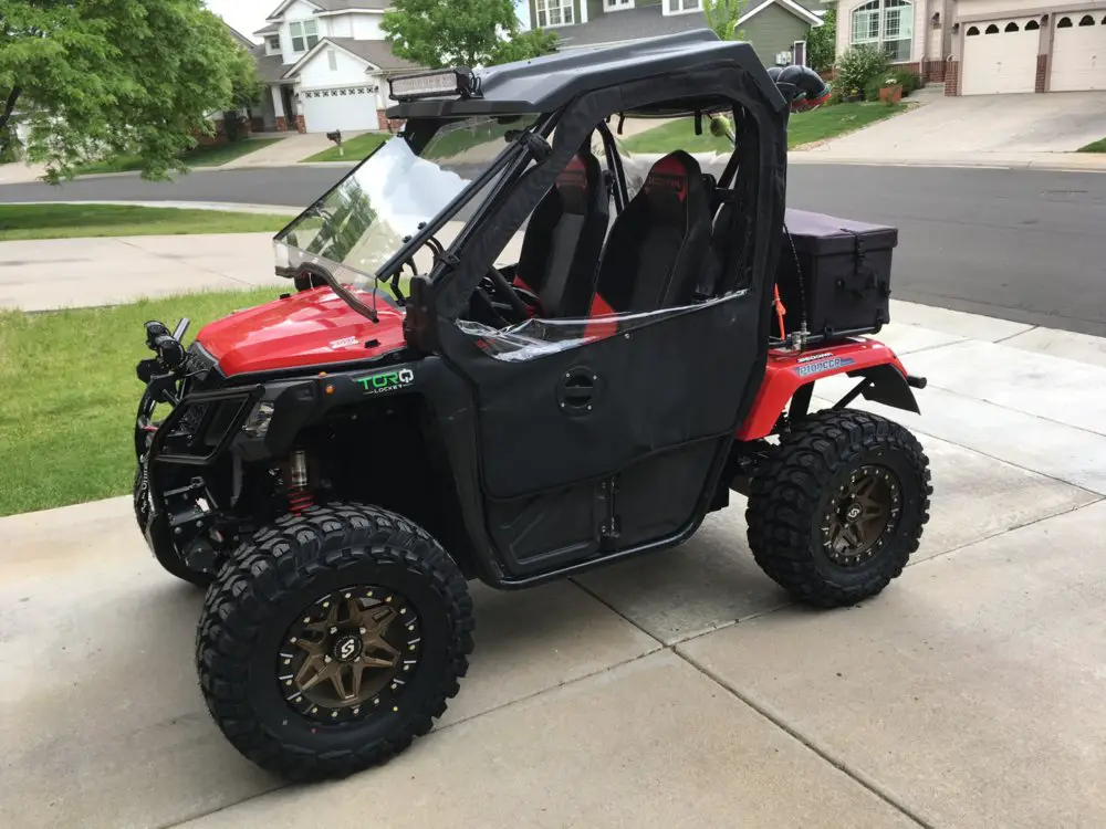

keep adding to my 2015 P500! so far i have 525 miles and 52.5 hours on it. i have added the following to it since i bought it new in September 2017 (it was a leftover and got a great deal!)
Factory roof
full hardened tilting windshield
front a rear bumpers
2500LB winch
rear mud flaps
Honda cargo bag
2-flex pack 2.5Gal gas cans
RZR bucket seats (re-branded to "HONDA")
reflective insulation under seats to keep heat out of the cab
nylon factory doors and rear window
24" light bar on roof, spots on front bumper
3/8" UHMW skid plate
Torq Locker spool to front diff!
40 channel CB radio
2" spacers on rear wheels, 1" spacers on front to give me a 58" width front and rear
Sedona split 6 in bronze 14x10 bead lock wheels, 4 + 3 offset or +10mm!
STI X Comp ATR DOT legal tires 28x10x14 measure 27.75 dia @ 12LBS front and rear
Walker Evans shocks on the front, rears are stock
street legal light kit with turn signals, added brake lights, horn and flashers
Magellan TR5 off road GPS
2nd battery with isolator
stick guards on the "A" arms front and rear
and finally the snorkle to keep the airbox filter cleaner! ( i really dont go in water anywhere near that deep!)

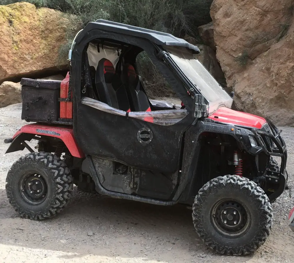

we spent the winter in Arizona and here is what my munchkin looked like until a few weeks ago. 26 Sedona rip saw's on the stock wheels so I was under the 50" width but those tires are not DOT rated and get chewed up on the asphalt so I changed to the STI's for pavement travel and when I need to ride 50" I will change them out! way more ground clearance with the 28 STI XComp's! (11.75" vs 10" with the ripsaws) The ripsaws are really good in all conditions and I hope these STI's are good also! wish Sedona made a DOT rated rip saw in a 28"!

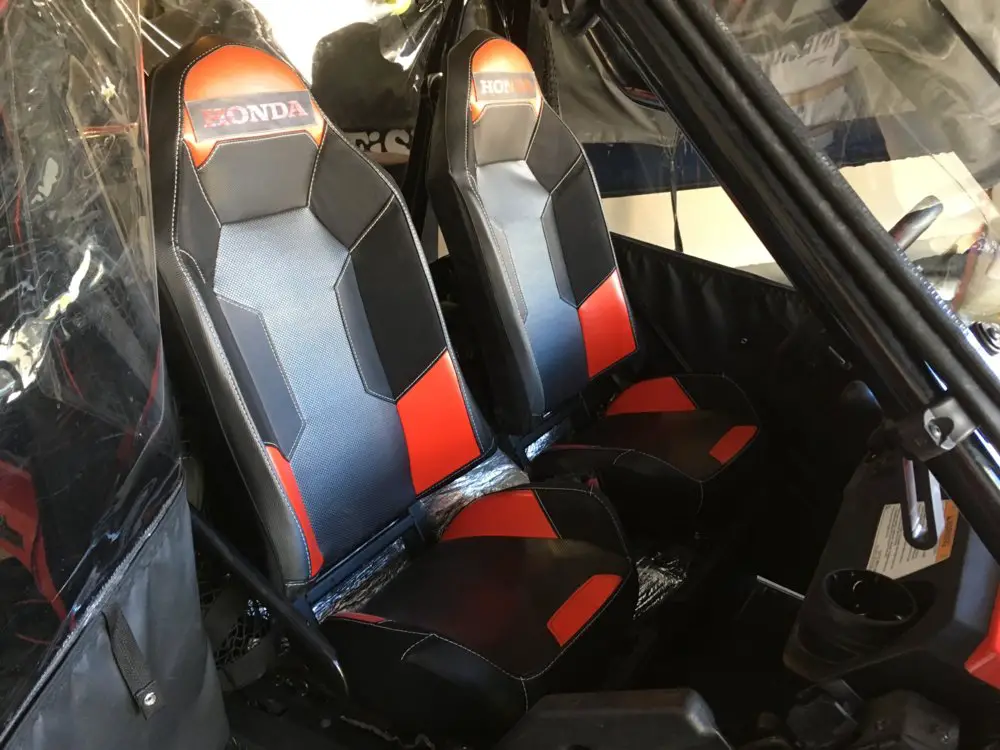

What rzr seats did you use ? How /what was install ?

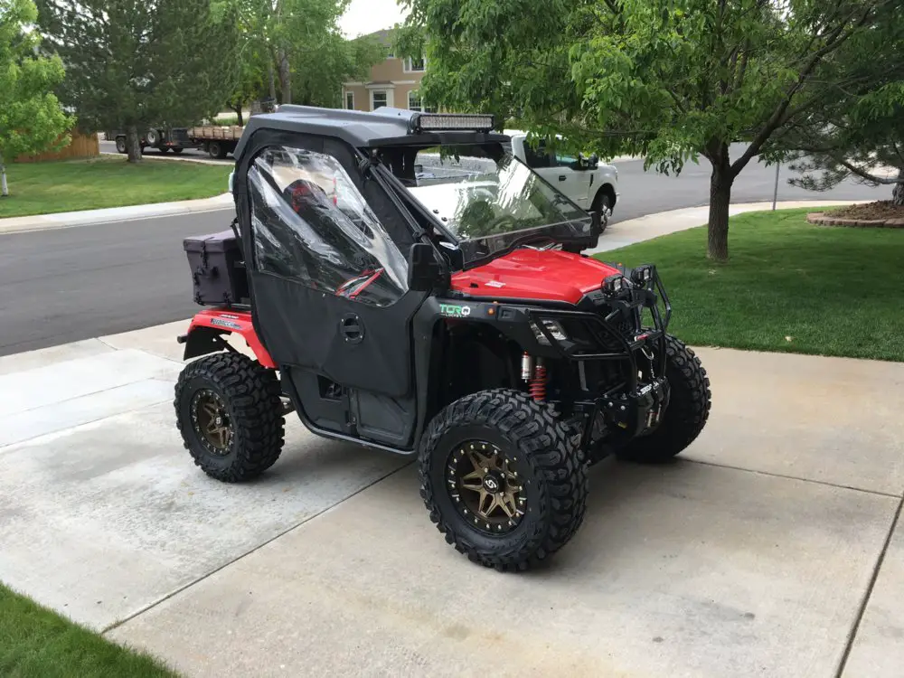

Nice looking ride but that's gotta rub? I was at 57" with 26 x 11's on the front and it was rubbing bad. Curious as to the details on those seats as well, did it push you up and forward? How did you mount them?

i am 6'2" tall and all legs so the stock bench seat was low for me and i kept getting a groin ache in my right leg so adding the RZR seats lifted me about 1 1/2" which has helped a bunch with the leg issue. The seats were brand new taken out of a 2019 4 seat RZR because the guy wanted custom seats with shoulder harness holes in them so i got the pair from him for $150. I mounted them using there existing tube frame and a bracket i fabricated for the back to mount to the bench pockets that are welded to the cage for the stock seats. I had made "Honda" decals and attached them to black vinyl i sewed up with stitching to match the seats (did not want the RZR logo in my Honda! :) so they look kinda factory! )
the fronts rub ever so slightly in a full turn as i have 1" spacers on the fronts. I am going to take a heat gun to the fire wall there and massage them in just a little on both sides.
