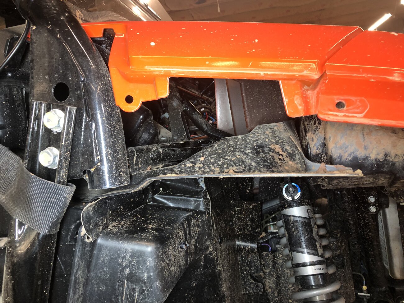

EDIT for UPDATE! I pulled both fenders. Lots of room in there (for a sxs). Great place to stash items in my opinion. Installed a horn on each side.
Link to post #15 with photos.
Preview. How much room is behind this fender?
IMG 9994
More than you’d think!
IMG 0015
Original post:
Sorry for the dumb newbie question but,
There seems to be a lot of room in the inner fender area between the front compartment, dash, and wheel well. I’d like to mount a horn in there as it would be out of the way and also protected from splash/mud.
Does anyone know how to access this area?
It looks to me like the front fender, door, and some other items would have to come off to get in there. Is that accurate?
If so then I don’t think it’s worth disassembling that much stuff to mount a horn or other accessories.
I did try searching for this topic with no luck before posting. If this has already been discussed please kindly drop me a link.

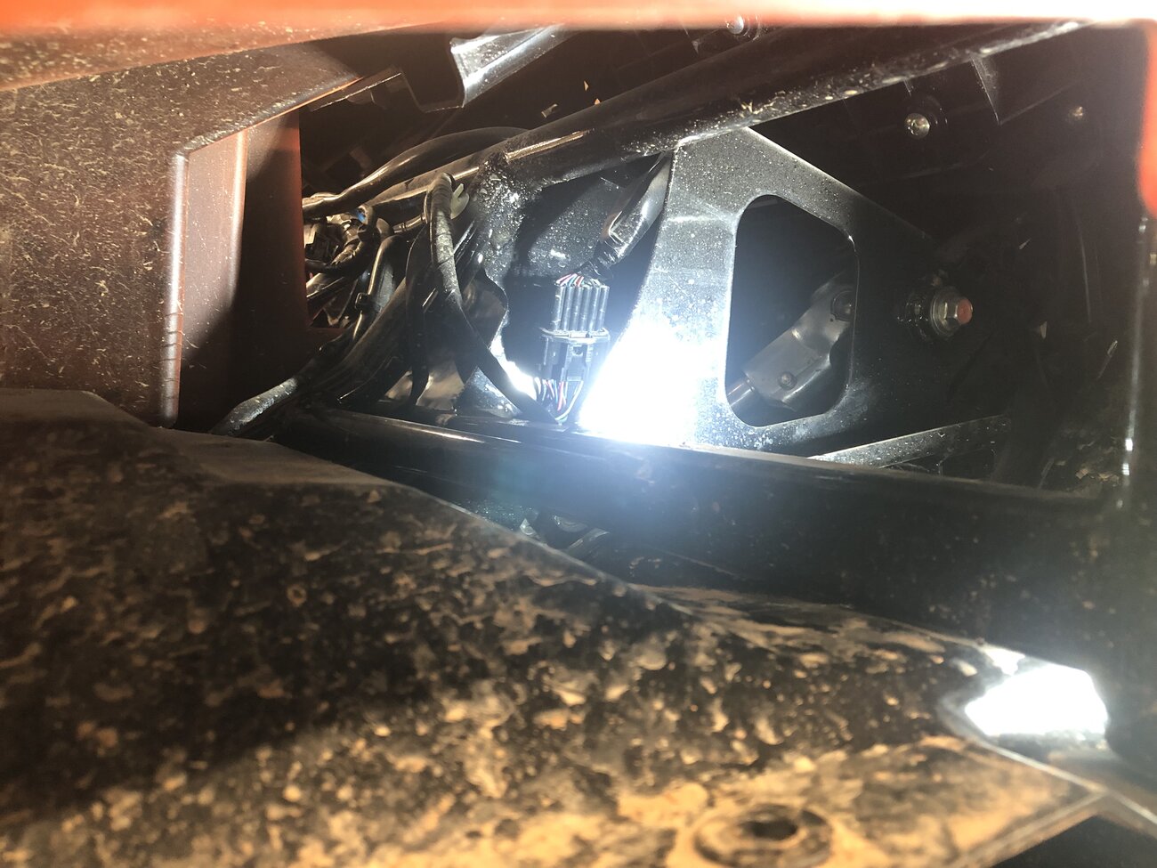

I’m sorry I didn’t have any photos for the original post. The cavity behind this circled area is where I’d like to access. Seems like a decent amount of “protected” space back there that’s just going to waste. But as I said earlier, if a large section of the sxs needs disassembled to access then I don’t feel it’s worth the hassle. Much easier to take my chances with the mud and see if it survives.
IMG 9976
For anyone curious, that’s a key on relay for the accessory fuse box. Both of these are attached using 3M double sided automotive tape.
I also make things harder on myself than needed. For some reason I don’t like to drill holes or cut the plastic and will go to great lengths to keep from it. Life would be much easier if I wasn’t so weird.

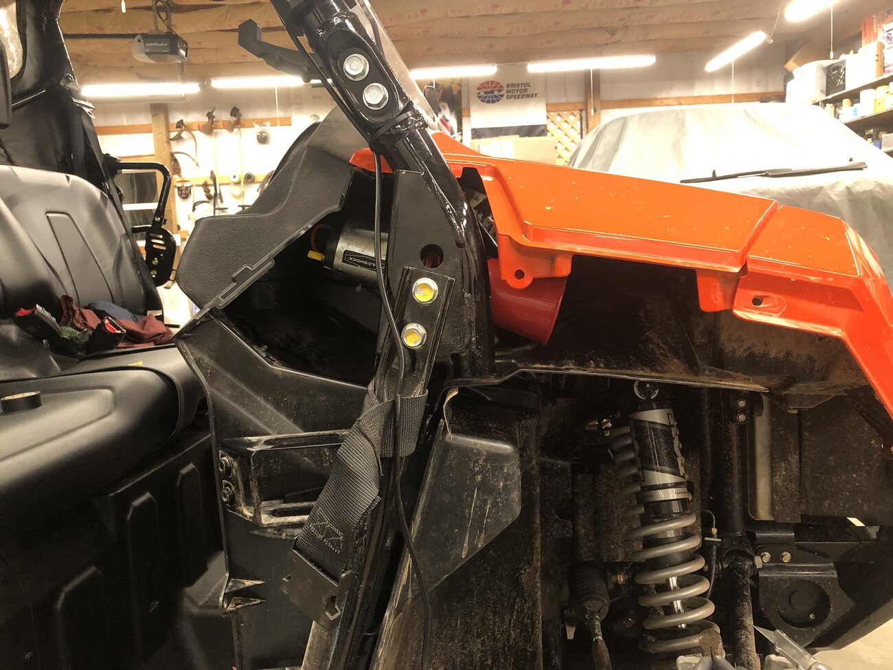

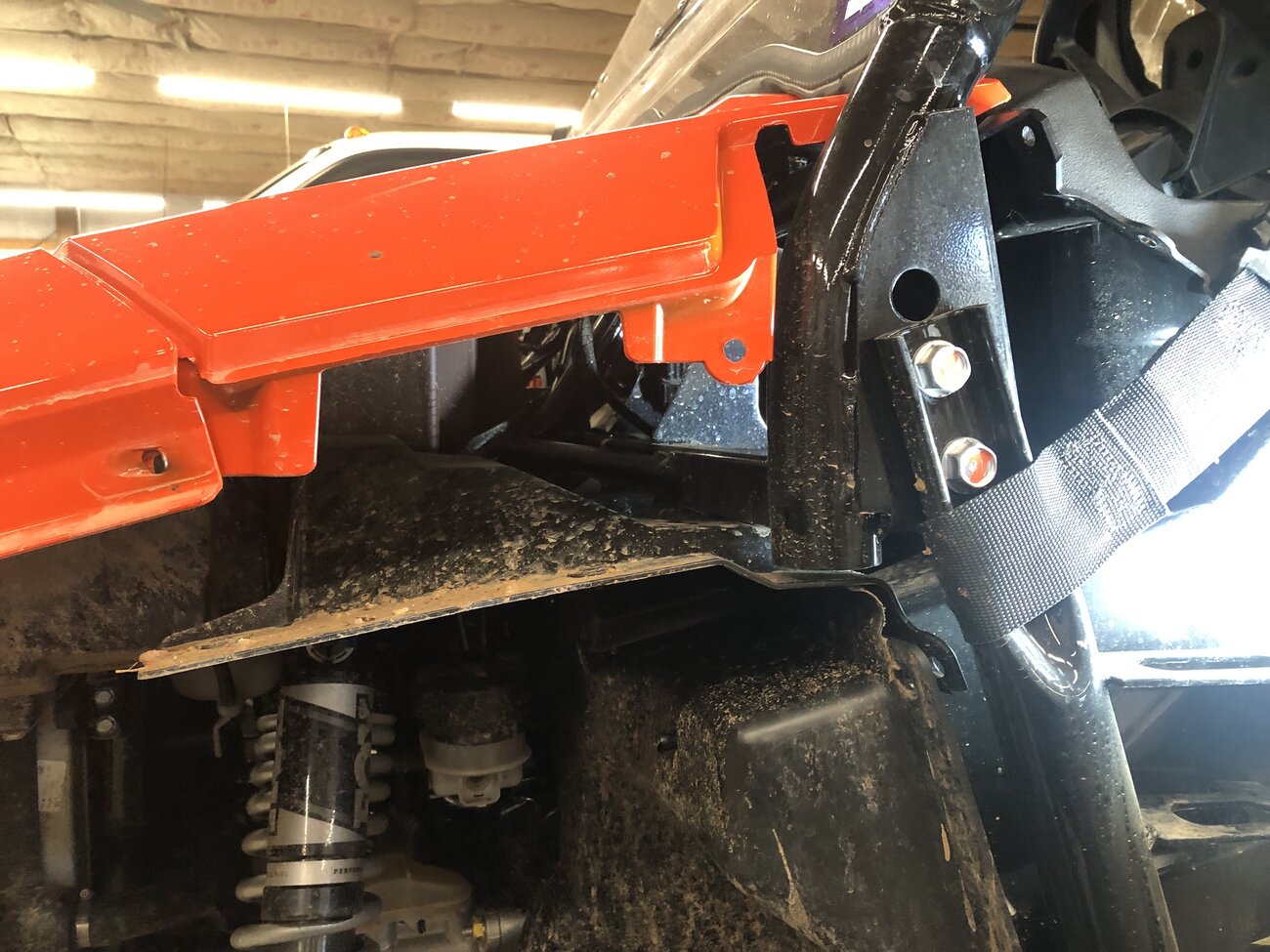

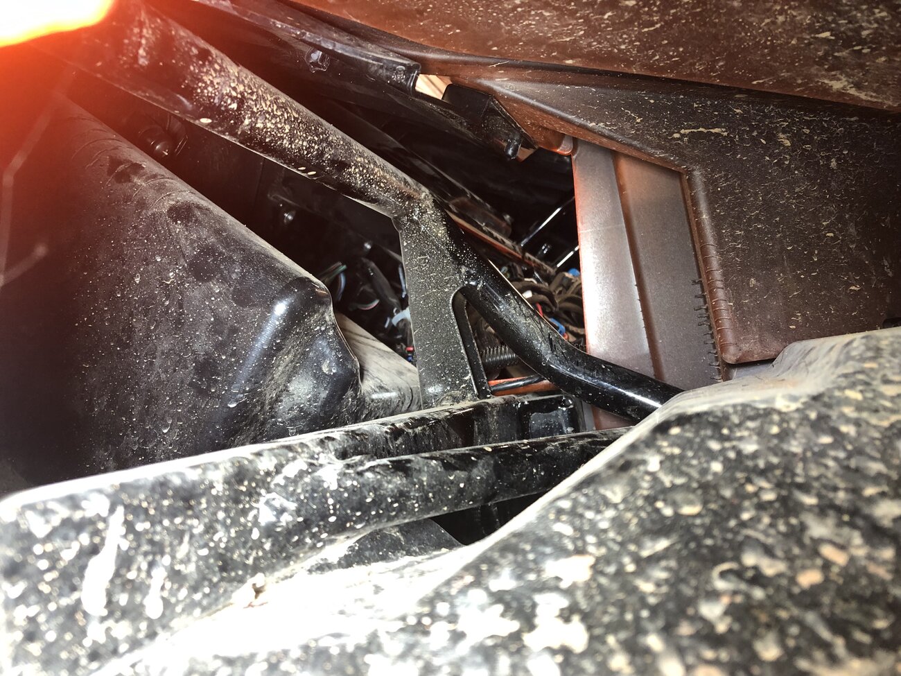

Ok, so I ended up taking off the doors and fenders for access to the area. Part of the initial hesitation was that I wasn’t able to truly assess the situation due to mud. It was still muddy from a nice day around Christmas but had been too cold since then to spray it off.
I’m sure many of you already know, but it’s simple to get those parts off in just a couple minutes. I’ll try to get some information uploaded later about the process and share photos since I wasn’t able to find any before diving in. It may help someone in the future.
There’s a ton of room hiding in there by sxs standards! Good place to stick items that won’t need accessed. I’m weird so ended up installing the train horn on one side and then put the ooga horn (take off from our previous 700) on the other. I like to annoy my wife.
I’m still working on some other things so haven’t gotten it back together yet.
Here’s a few photos in the mean time.
Passenger side
IMG 9999
IMG 0001
Drivers side
IMG 0002
IMG 0003

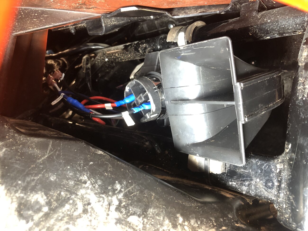

Train horn (yes, I know the horn angle isn’t per instructions)
IMG 0006
Ooga horn
IMG 0015
Used the hose clamp method @bumperm shared in his thread. Thank you for that!
Ooga horn didn’t have the slot so made one and used a large zip tie, and another around the throat to keep it stable. So far so good without a test drive. 😂
