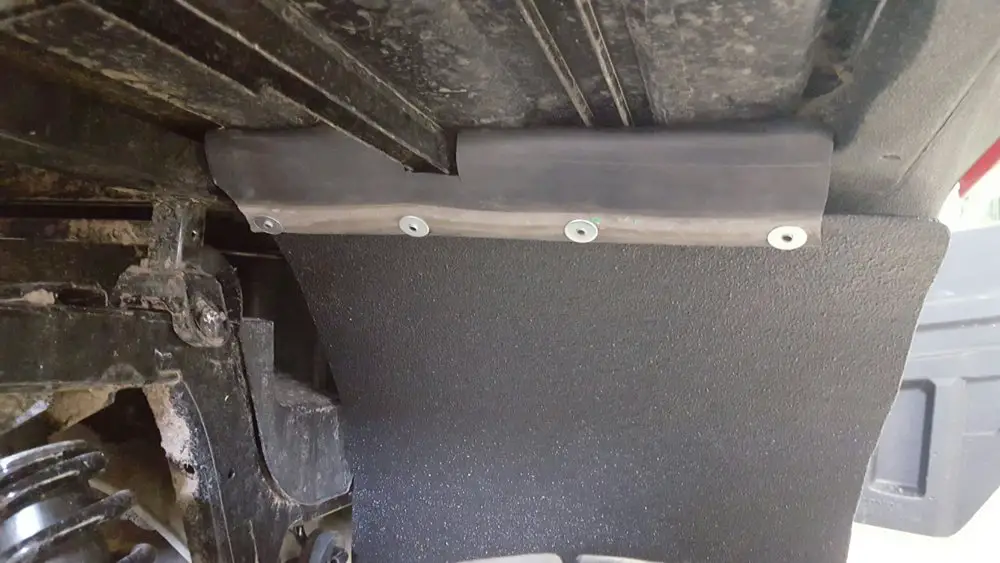

I made a pair out of eighth inch aluminum diamond plate. Mounted to the brackets that extend from frame. Welded brackets to the diamond plate, mounted with two bolts to bracket that extends from frame. Mounted lower to the lower bed step tube, put a nutsert in and bolted from bottom, so all plastic remains factory. Primed and bedlined them black so matches look of black plastic. Then i put rubber seal on top when bed is down it seals nice and tight. They work great.
You should make some more. I would be interested. How much would you have to have for them?

thanks i think it worked, here are pics ox the inner fenders i made. work great stock look from outside nothing hanging out. 20160306 103606 resized

I am thinking of making some liners
myself, but I think I will make them
to cover a lot of the area under the
bed & towards the center up front.
A flat plastic surface will be a lot
easier to clean the mud off of, rather
than all the features & protuberances
under there.
So, bdyman, what material did you
use, and where did you get it?
Great job.
John
thanks i think it worked, here are pics ox the inner fenders i made. work great stock look from outside nothing hanging out. View attachment 11930

I used alum diamond plate check my previous post. Have a body shop and aluminum welder. So not to bad to make. As for underside of box that will b easy to do , just like they did for bottom skid plate.

Ok. I didn't understand that they
were aluminum. I want to make
some out of roll goods semi
rigid plastic. I guess I'll stop
at lowes tonight to see if I
can find anything close.
Yours look great!
John
B
bdyman
Jan 23, 2016
9
5
wisconsin
Well thank you sir. They work great, keeps the whole middle of machine so much cleaner, trans and motor area. Back of seat area, mud doesn't stack up on box foot step area. Definitely worth the effort to make. Honda should have had them right from factory, no doubt.
