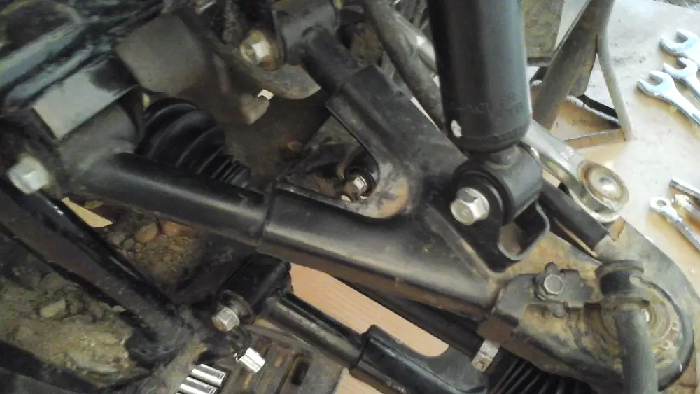

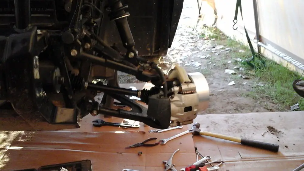

That second pic where the tie rods are behind the shock...maybe its the angle, but it almost looks like the inner is coming out at an angle compare to the outer. Does it look straight in person?
Also, is it possible that side of the rack has shifted up where it mounts to the frame?
No..everything solid. ..its... clean..had boots
off....I seen no sign of...anything wrong
I don't know...for sure.
but it's a steering problem...
so..start with..steering rack...
don't ya think...

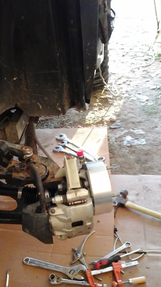

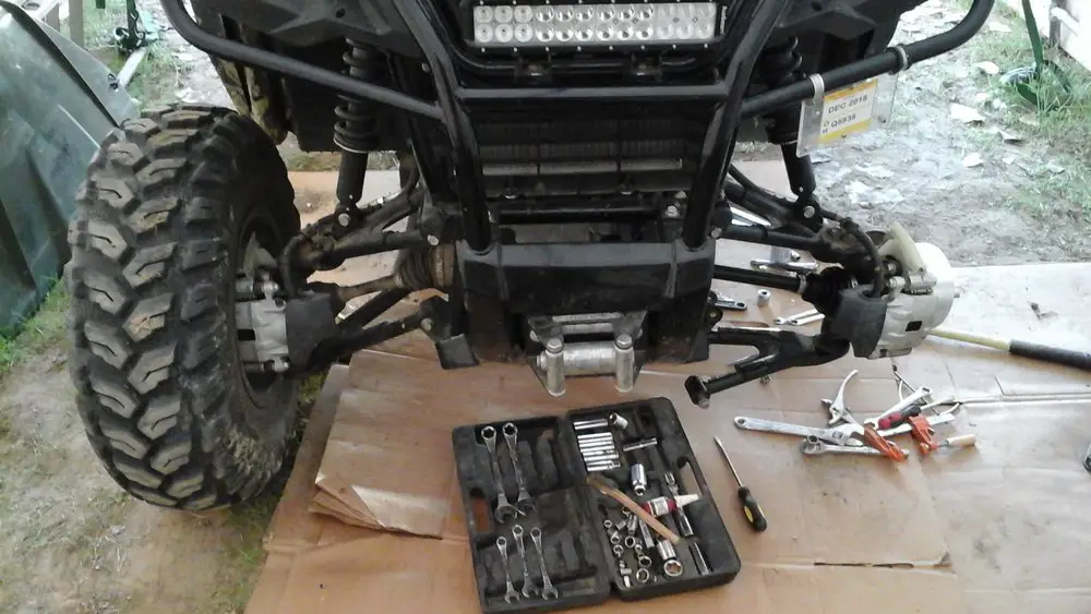

No sign of a arms...damage
I can put tire back on..
if need to...View attachment 56616 View attachment 56617 View attachment 56618 View attachment 56619
In the second picture down, it looks like the frame is bent at the upper front control arm mount. It looks wrinkled, but hard to tell in the picture for sure. Look at the frame where all the control arm mount points are. Something has to be bent to cause your issue. Take off the hood and compare side to side. Does the hood still fit properly? Does the door line up properly? Check the hub where the tie rod connects, that may be bent as well. It's very difficult to see impact damage when it's spread over a large area of frame, but there's no escaping that you have something bent. Taking the other wheel off and just step back and look it over from that side, might help to see something wonky. Try to refrain from just buying parts till you find the problem. If there's a collision repair shop near you, take the machine there and have one of the guys look it over- they have an 'eye' for seeing that kind of damage. Wish I could be more help.
Reactions: rocmar and chrisC

I'm very sorry for your troubles. It's pretty tough to tell what is going on with the lower arm disconnected in the pictures. I'm assuming it must still be way off. Like everyone said please let us know how everything turns out.
