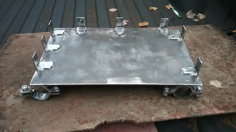

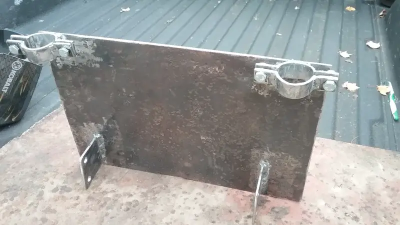

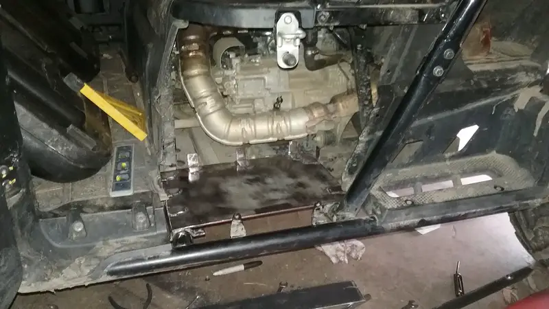

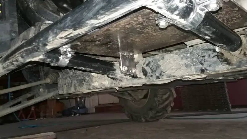

I removed the factory battery, and went with a car battery under the seat for two main reasons. First I live in NH and it gets cold here in the winter and my 700 doesn't care for sitting in the unheated shed for a week sometimes then trying to start it. So I wanted the extra cold cranking amps to help here. Second reason is because while plowing last year with the heater being used intermittently, the stock battery/charging could not keep up.I only had to stop once for a few minutes to let it charge, but I have heat and I want to use it. I have a stereo that is wired (for now) to shut off with the key so I don't really have a need for any accessories to be used while its not running, so for me a second battery is not needed. Plus I like to keep things simple, a single battery with as few connections as possible so minimal chances of failure out on the trail.
sorry about the crappy pics, heres the under view
I put some tabs on three sides (the fourth side is right next to the plastic side panel) for some 1/8" aluminum sides for stick/heat shields.
I thought I had some pictures of the battery installed before I put the side back on but I guess I didn't. I can say that this upgrade is well worth. I haven't had any problems starting it in cold weather,in fact I find it starts a lot easier this year and for the few times I have plowed with it this year it seems to not run the battery down that much with the tunes blaring and heater on.

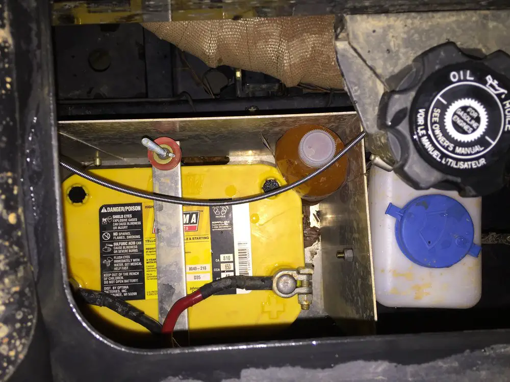

Tram, what larger battery did you go with?
32,050
Been running a Yellow Top under the drivers seat now for 2 years and no problems.
IMG 0185
I chatted with the guy that bought my 700-4 a while back, he is still running the Optima under the drivers seat I put there in late 2013. Its 4 years old now. Only had to replace brakes and perform reg scheduled maintenance, he was right at 3000miles back around August I think.
Not sure I sold the 700 a few months back. I would say a mid range size, not big but to the smallest. I did make sure it had the threaded connectors.
