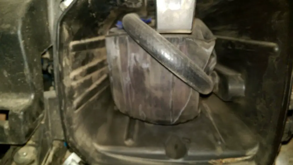

I've been using this filter for 10 weeks now. I check it regularly but haven't cleaned it or anything. After 10 weeks and probably 80 miles this is what I found.
The air box and the K&N precharger was a little bit dirty .

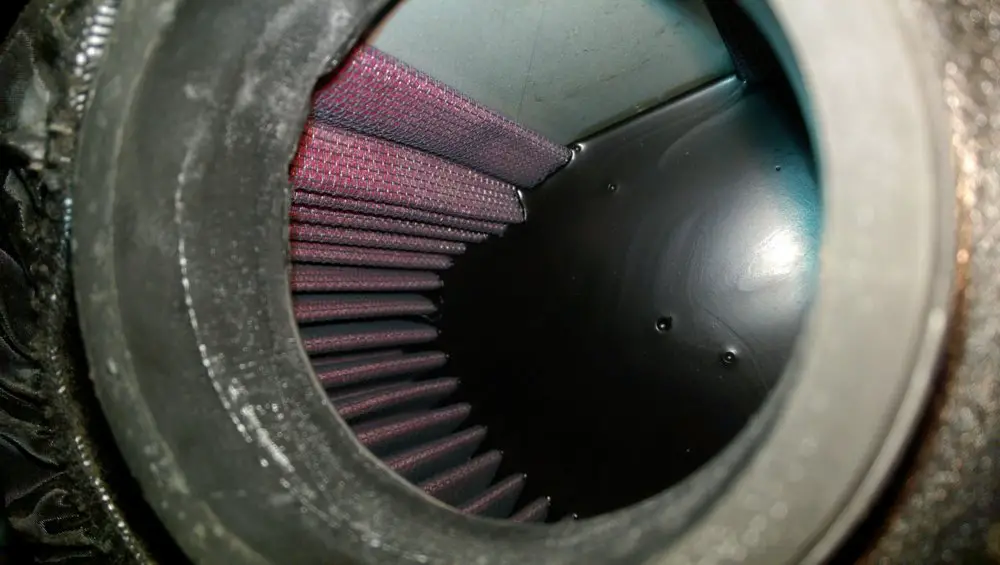

The inside of the filter is clean as a whistle.

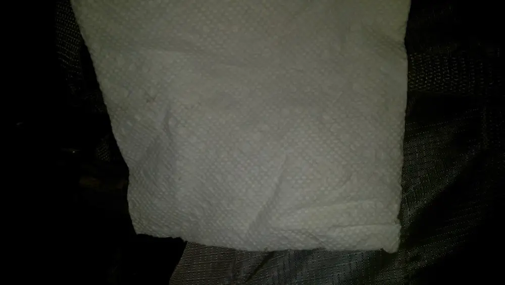

I wiped out the intake tube with a clean, white paper towel.
IMAG00970
Clean!

What K&N precharger did you buy? Model number???
Deleted member 3748
I didn't get the correct precharger. I forgot about the breather tube on the top and had to cut a hole in it. I used gorilla tape to reinforce the hole. With that being said, I used K&N 22-8020PK Black Air Filter Wrap. If I ever get another one, I'll use one about the same size but with an open top.
