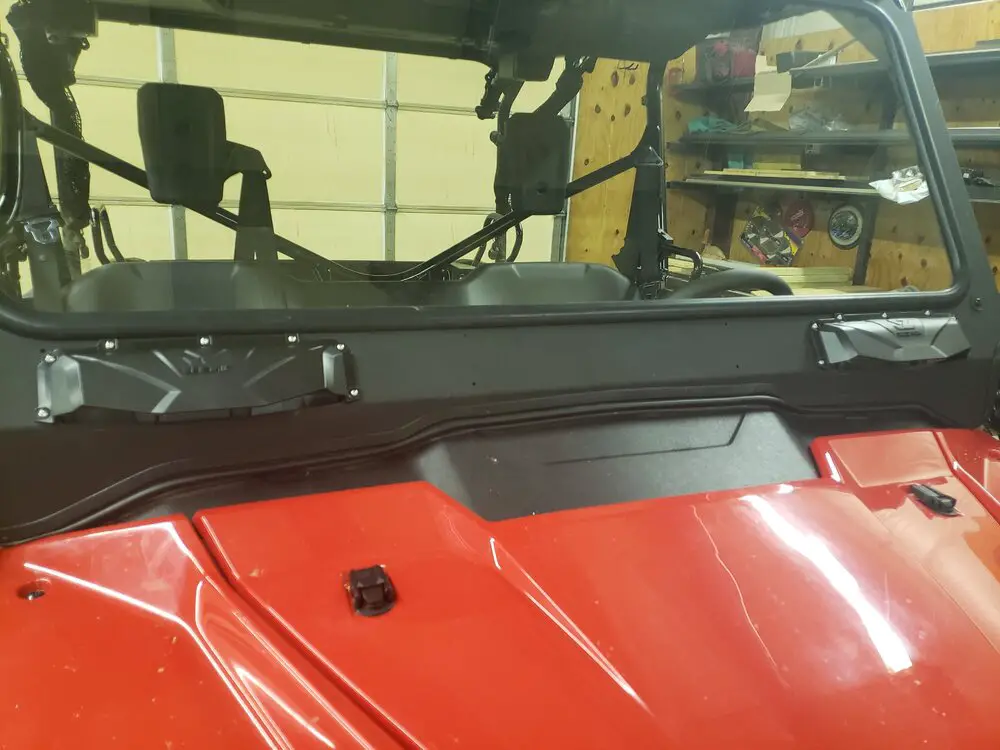

Just thought I'd share for anyone looking to add vents to their kolpin glass windshield. I had been looking at Seizmik Versa-Vents. Wasn't sure if they would work with the kolpin because of space between the glass and the bend in the metal frame. Well I got mine in and happy to say I was able to make them work. Air flow in the cab is 10x better then the stock vents. Night and day difference.

Man, that looks nice! Is it enough flow to keep the dust down? I have a Tusk frull glass windshield but I pulled it off for the summer because of all the dust that flows into the interior/cab with it installed. I think your mod would work with my Tusk, but I just don't know how well it would do on keeping the dust from flowing around the windshield and into the cab.

I'm sure it's going to help with dust and the negative cab pressure. I don't really know how much yet. My trails around the house are in the woods and down by a creek. Not really dusty here right now. Heck it was slick and muddy just a few days ago. Guys that have full lexan windows with the vents seem to like them. I just couldn't find any posts with them installed in a glass windshield.
On my last couple sxs a back window made the biggest difference with dust coming In. But on a honda 5 it would just be in my way.

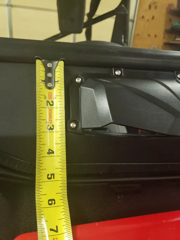

Could you get the dimensions? I have the Honda glass and want to see if they would fit.

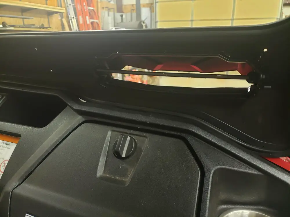

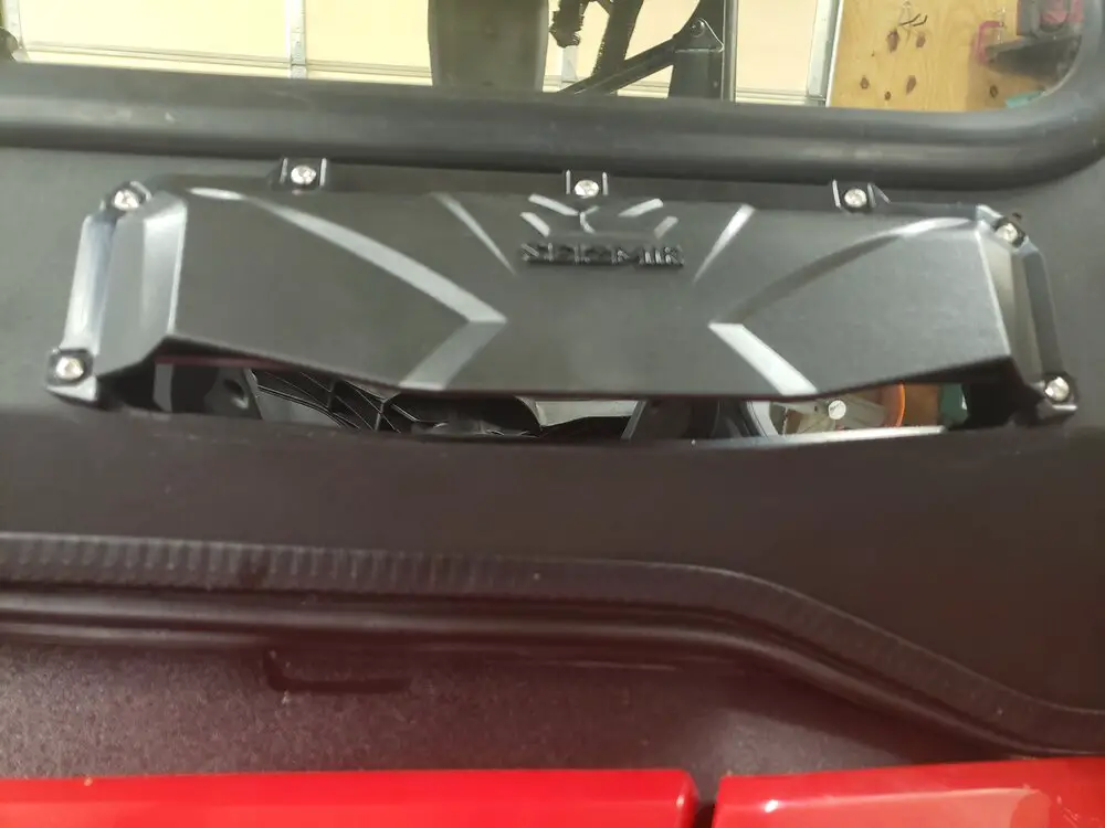

On the kolpin there is 3" between the rubber gasket and where the bend is. So the cut out for the vent actually goes past the bend a little. I would say 3" is the bare min you can get by with. I didn't use the two bottom screws for the vent inner frame because of the bend. Infact I trimmed the tabs off the vet for them and this allowed the vent to lay flat and fit tight up against the windshield frame.
