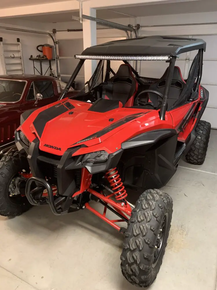

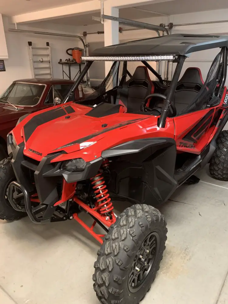

Looks awesome... did you have to drill any holes etc in the frame or just used stock holes?
Only drilled the brackets.

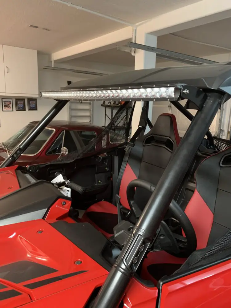

I wired up my and installed, thanks again looks amazing
View attachment 133873 View attachment 133874 View attachment 133875
Hi, i just installed this set up. same lightbar and rzr brakets. best lookin , cheap and easiest set up for a talon. But when you tighten the side bolts that hold the lightbar to bracket did you just tighten normally with reg washer inside bolt head? Mine tightens but does not hold the lightbar in place? It drops forward. Ideas? Gonna conact / research support now. hope its decent...

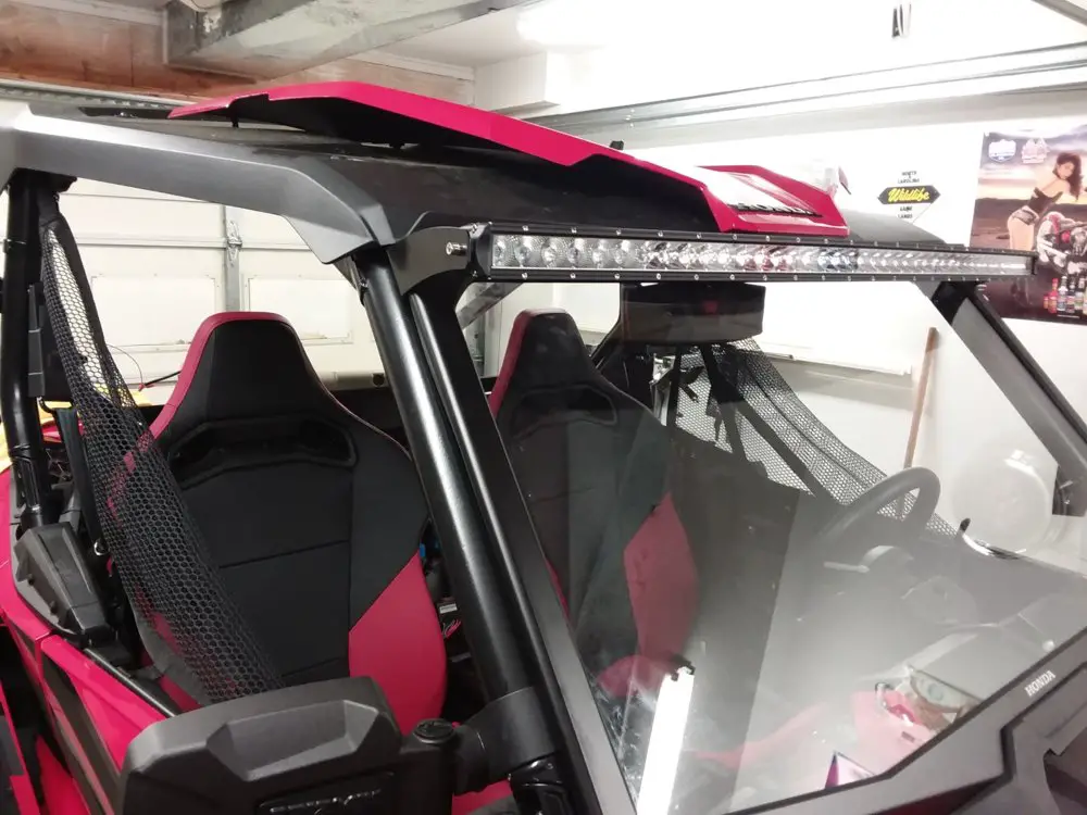

for guys with windshields, does it reflect of windshield?

Added a 42" curved light bar today but still have to wire it up. Used curved brackets made specifically for a Polaris and drilled a hole in them and bolted it in with the same bolts that attaches the top of the windshield. The bar listed as a 42" but measures 43" and is the perfect fit and curved the same as the top. I just hope that the light quality will be ok.
Can you give more information about the mounting brackets. The Amazon number is no longer valid and yours looks like the ideal setup.
I had mine mounted up flush with the front of the roof and it did reflect on the windshield. When I moved it to these brackets I get no glare or reflection.
