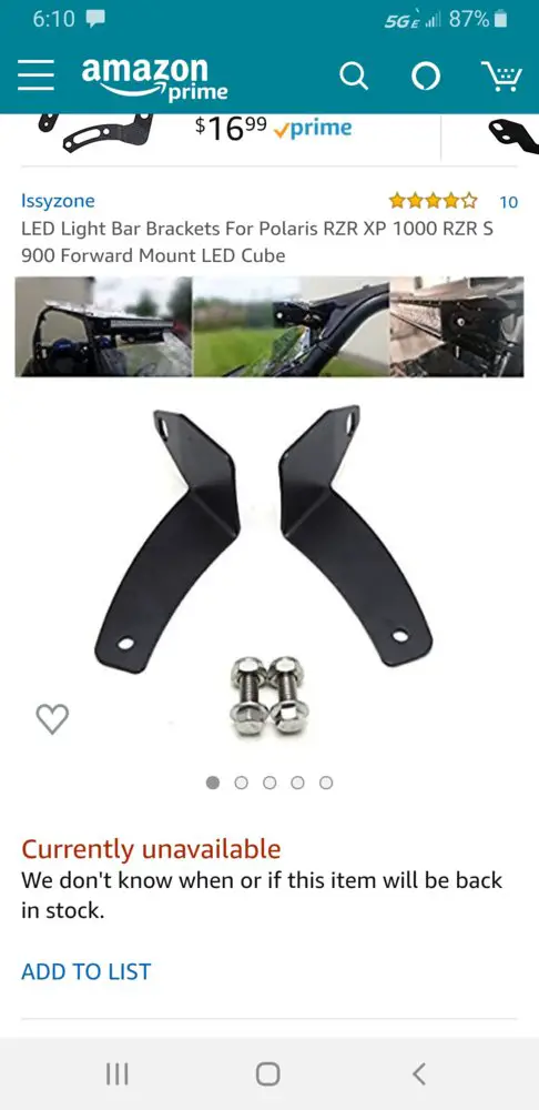

Hey guys, neither Amazon links work any longer. Are the Polaris mounts in reference the same as the attached photo? I also see RokBlokz makes a similar set, but they're $70. Will the SATV flip up windshield clear a single row mounted with these brackets? Thanks!

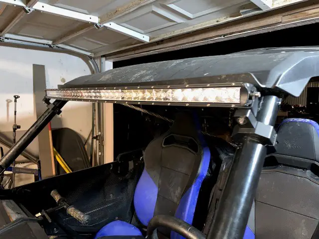

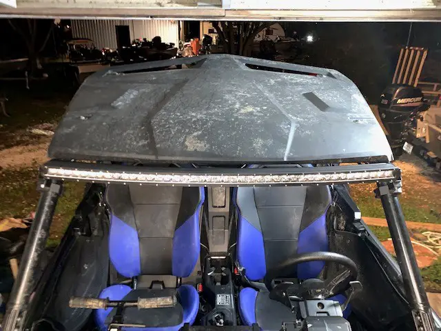

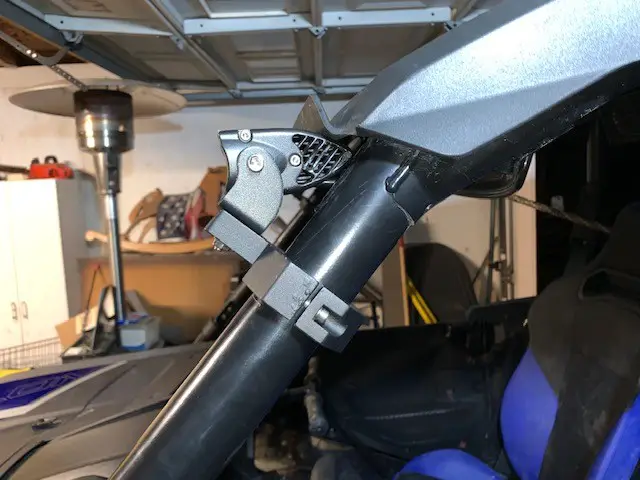

I've read that some had problems with the lightbar shaking at speed with the long brackets. So, I used tube clamps and the small stamped steel brackets that came with the 42" lightbar. Solid as a rock!
