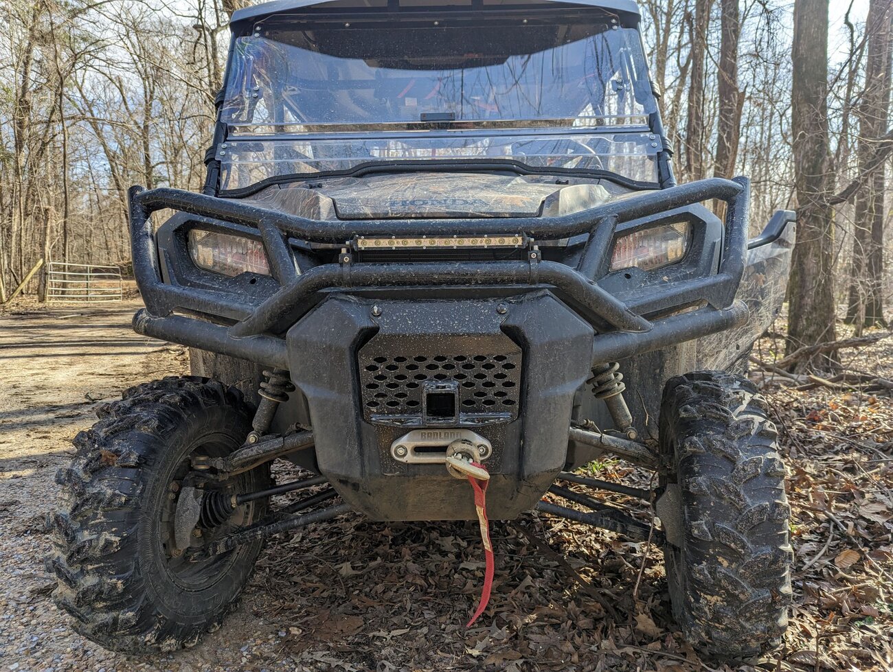

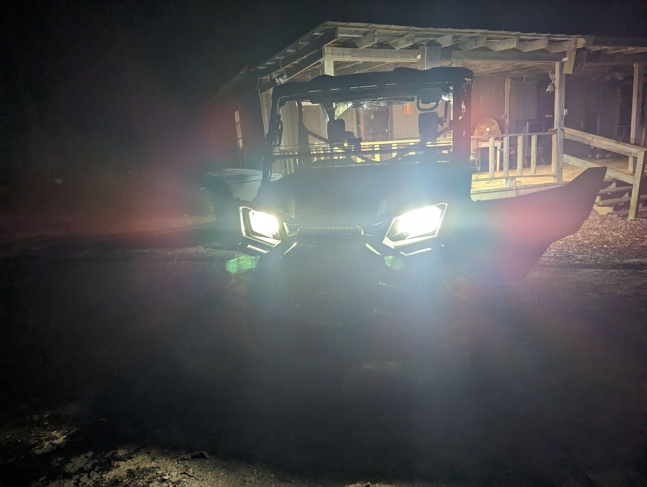

The aftermarket LED headlight bulbs @czajkaej references here are a game changer on the stock '22 buggy to replace halogens. I did the swap this weekend on a 22 Forest Edition.
I also have a 13" single row LED bar wired to the high beam switch off the club store on the bumper. The bar, plus the bulb replacement, is more than adequate for trail riding at night in tight woods to/from the stand on known paths.

I installed the LED conversion bulbs to replace the OEM halogen bulbs, and there was a huge difference light output. Like Vikes79 said, if you need more light than that, the high beam conversion kit and light bar from the club store is a good choice

Is your tie rod bent bad?
Nope, just looks bad in this pic for some reason.
I'm going to be doing an alignment and toeing it in a bit when I get it back to the house after hunting season.
