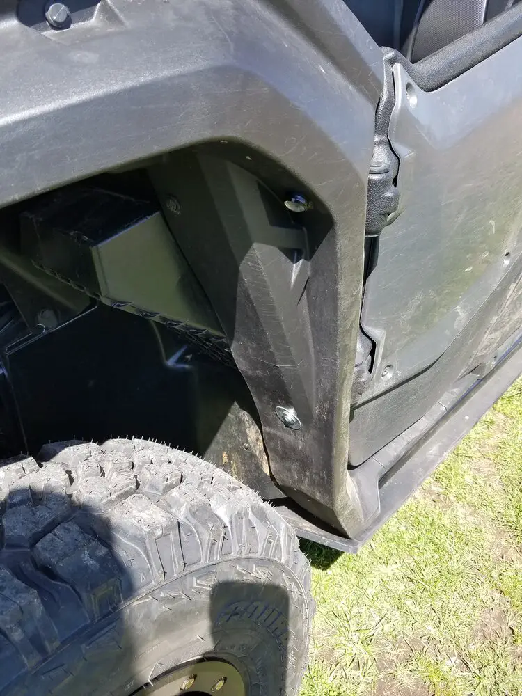

Last night i installed Mudbusters extra coverage. Went for a ride, and noticed quite a bit of rubbing in front. It was dark when I got finished so I didn't look close to see where the tires are rubbing. But it was bad enough I heard it rub about 10 times in a 15 minute woods ride. I don't have any lift, or aftermarket a-arms.
Be advised, with 235/75/15 tires, you will rub if mudbusters are installed. I'll try to locate the exact source of rubbing and report back
Reactions: BWAF

Heat gun and some pressure will fix that problem. It is the lowest bend on the front that hits a little.
Reactions: ehart814 and BWAF
Or one well placed screw may help
I put mudbusters on and that's when the rubbing got bad. Before the mudbusters it only rubbed when the suspension really compressed or bottomed out. I put over 50 miles on this weekend and it really rubs a lot.
Reactions: DDDonkey and BWAF
Mine was rubbing really bad with the mudbusters also. This weekend I put a screw in like @BWAF Suggested and it fixed my problems.
Reactions: BWAF and ehart814
I'll have to give it a shot
Reactions: BWAF
I can confirm that this well placed screw will cure the rub! The rubbing was starting to distort my fenders. At one point the other day I was in reverse and the tire caught the inner lip and really peeled it out.
I decided yesterday to give this a shot. Pay close attention to where he put that screw, cuz it's definitely the right spot! Went on a pretty hard trail ride yesterday and NO MORE RUBBING!!!
Thank you!
Reactions: BWAF and TripleB
Thank you!
Your welcome glad it helped you out !!
Reactions: ehart814
