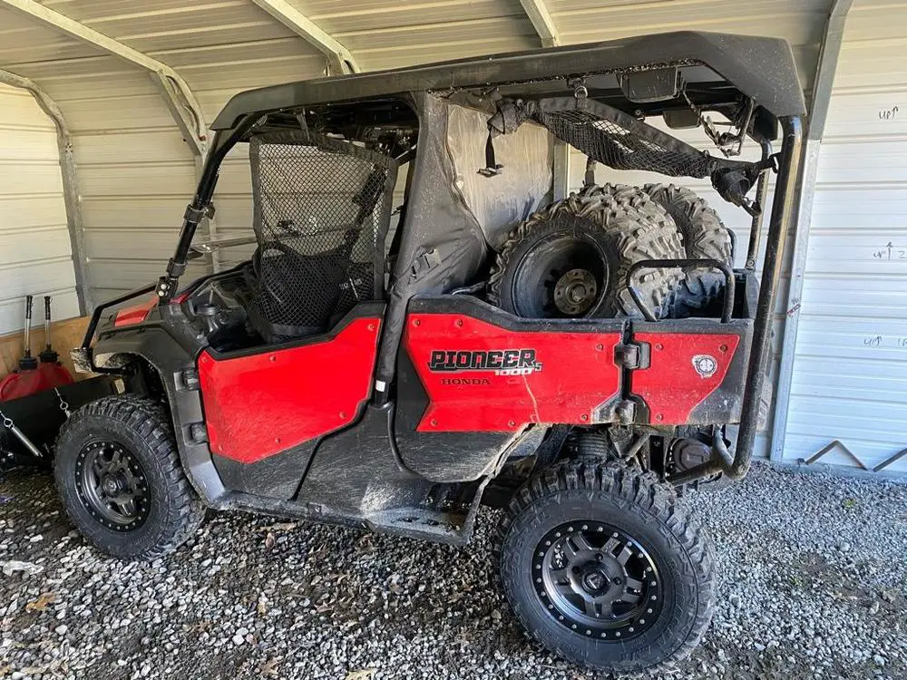

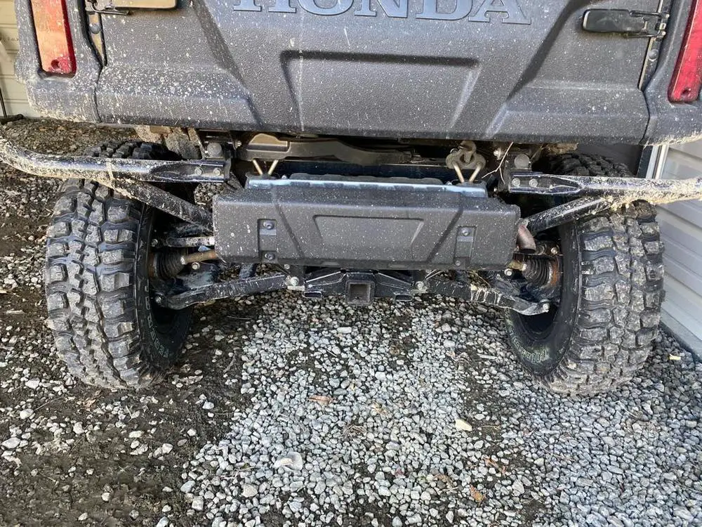

Got my new tires this morning. They look beefy! Heavy for sure, and very stiff. So I'm expecting a rougher ride for sure. But the thickness of the sidewall is much better than the utv tires I've seen. I think the toughness is going to be much better. Excited to bolt them up tonight. Might even take a pic

Nice tires! Now get the SATV A-arms so you can properly adjust both the camber and toe in. I had mine machine aligned and the tires balanced. They are wearing perfectly and don't shake at all at any speed.
I really don't want to mess with the suspension. I will keep it stock, and reliable. The only thing i'd consider is a set of new shocks, but I can't afford those. My toe in is still perfect at this point. about 1100 miles, mostly road, and the front tires show just a tiny bit of wear. I was going to put spacers on the rear, but I like how the tires are flush with the side of the machine, front and rear. I hate flying mud (mudbusters are in the mail)

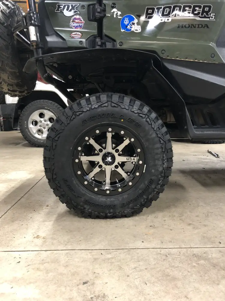

I haven’t heard of anyone not running beadlocks with LT tires. If u run low psi like a UTV tire like I do, you most likely will pop a bead but u can try it. An LT tires bead isn’t really designed to run that low as they are for the road and some light off rod use. They also can obviously be used for our application as u can see but not with quite the psi your running. As for the P1 vrs the P5 and a hill your trying to go up in 2wd. There 2 completely different beast and weight. I’ve owned both at the same time and I can tell you there are places and hills one can go easier that the other one can’t so you don’t want to Compare there 2 in that situation or you’ll just get pissed off! Lol.
is there a reason you don’t want bead locks? I once read too much bad things of them leaking then I just did it, and took my time installing them and have never had an issue.
