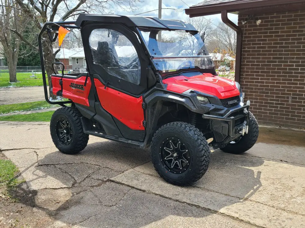

Just wanted to pop in and say thanks for this thread. Got my new wheels and tires installed today and the look and ride great. Went with accelera mt-01 235 75 15r tires and they don't rub on my stock set up.

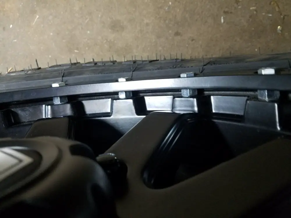

Does anyone have any input on beadlock wheels for the LT tires? I know some have had issues with the bolts not being quite long enough for the thicker bead on some wheels, especially the STI wheels which were the ones I was looking at. Are there certain brands without this problem?
You'll need longer bolts and 3/8 nuts to put in between bead lock and rim too thick to pull all the way down at least I did on federals pics with and with out
View attachment 197568 View attachment 197569
Thanks so much man! I was looking all over today to find some info about this and in the end all I had to do was hop on the forum. I did see where some companies sell “universal fit” spacers for beadlocks. How has the nuts setup held up for you? Would it be worth it for a $15 per wheel spacer? And did you get the bolts directly from STI or did you hit the hardware store?
