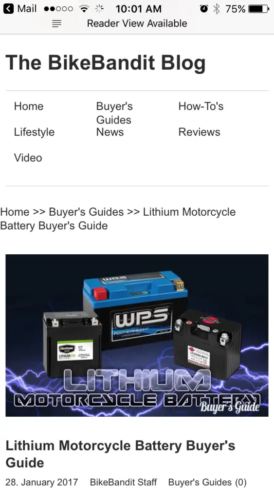

Has anyone used a lithium battery in their Pioneer?
I'm loving the lithium ion batteries in all my cordless tools. It just seems to follow that car batteries (or small lead acid motorcycle batteries) could be replaced with lithium.

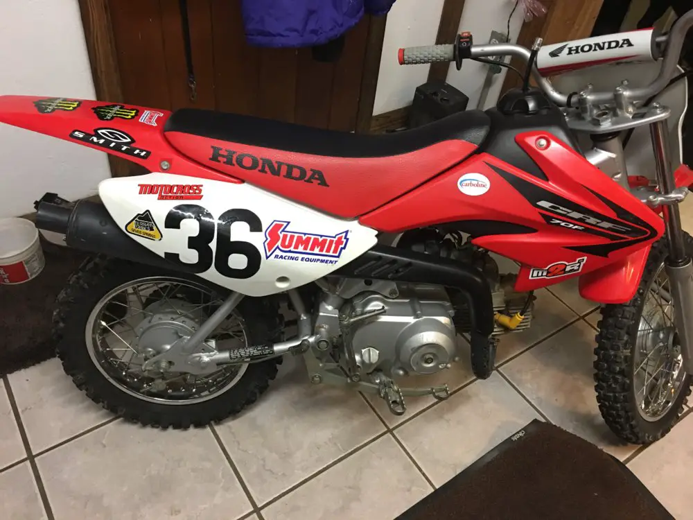

Hey how do you like the 230crf I heard they are bullet proof.my youngest has a crf 50 and I just bought this tonight it's a crf 70 for my daughter,I raced for years and don't want a 450 and the 250s are ok but the 230 is priced right.
